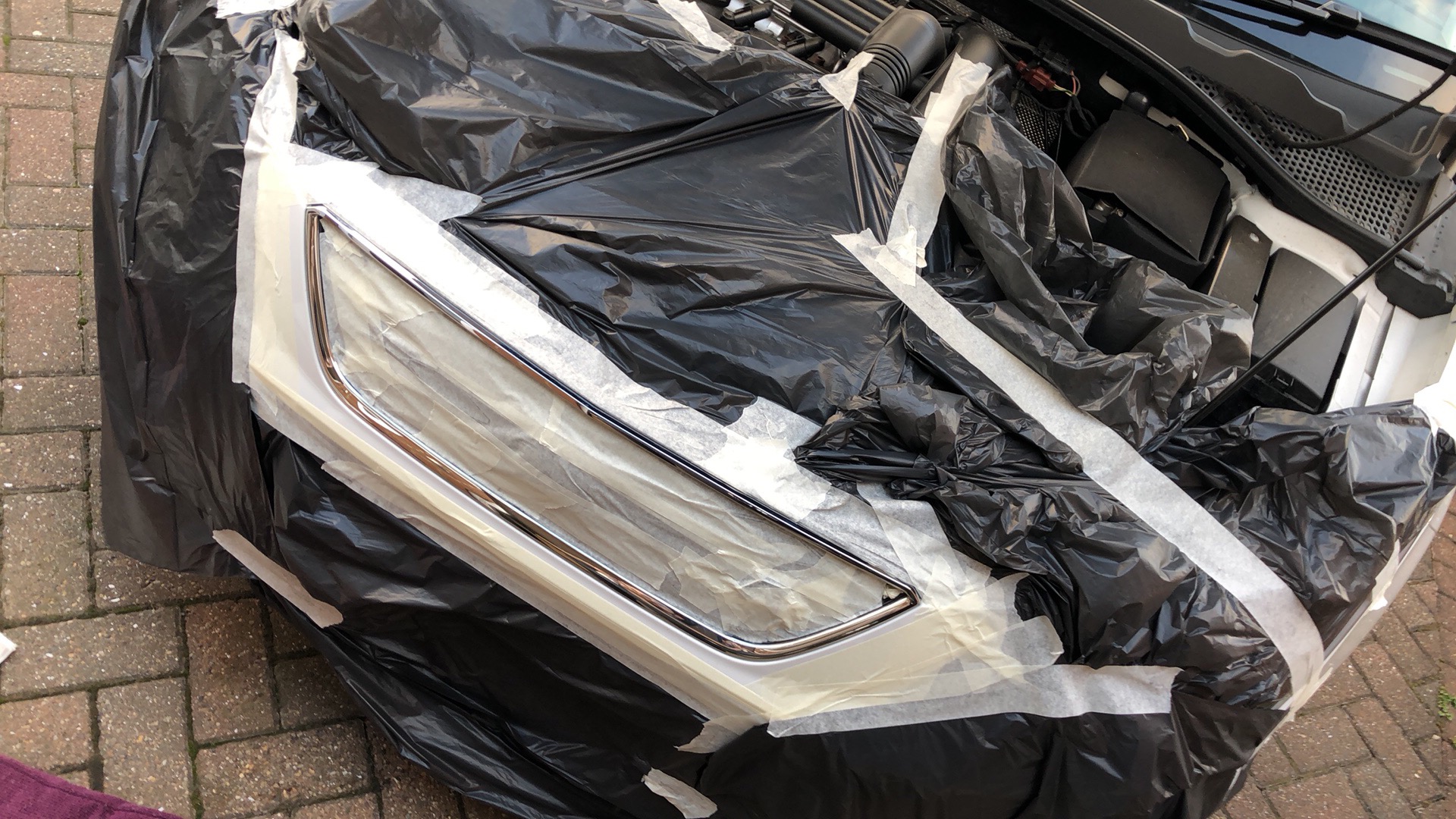

Here's how I masked it. I tried not to mask directly onto the chrome itself. I left a gap between the tape and the chrome which acts as a break line for the plasti dip once you start peeling off the overspray.
Reactions: vikram soni
vikram soni
Jul 19, 2018
126
40
Thanks for the image. Much appreciated!
So the key is to leave a milimeter or two of black plastic between the Chrome and the making tape. And then how you remove that extra plastidip on the border?

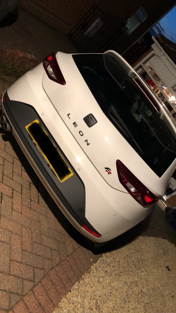

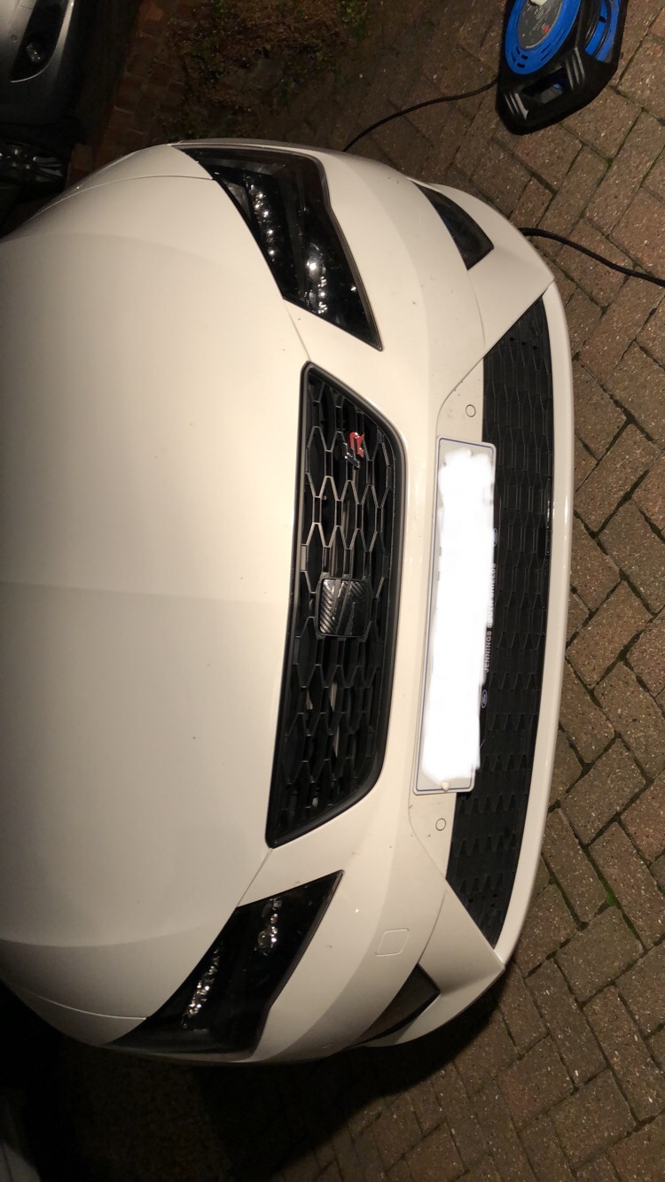

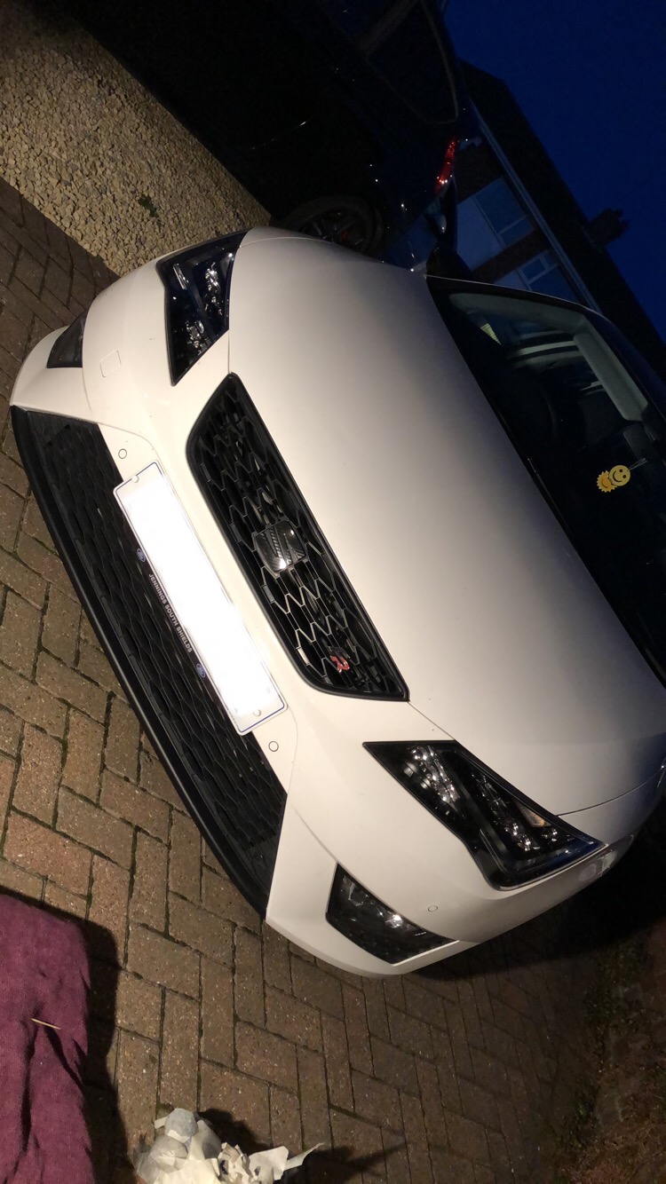

Spent a while last night plasti dipping my grill and rear leon lettering, the plasti dipping itself was as easy as the youtube videos make it seem, it was the masking on the grill that took up the most time, finishing it off tonight with the rear badge and bottom bar on the front bumper so ill post an update tomorrow

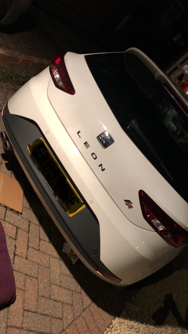

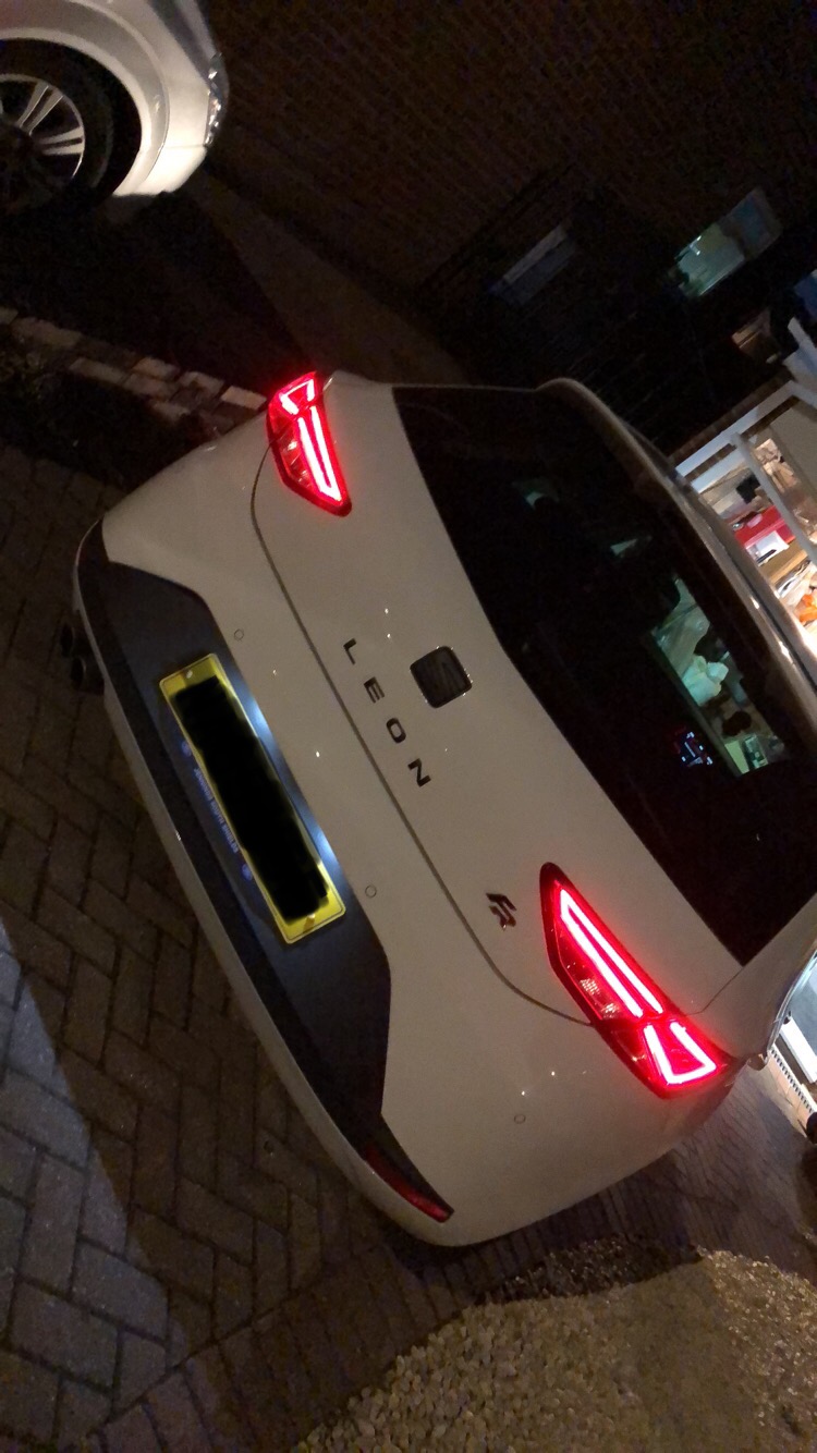

Plasti dipped the bottom bar and rear badge tonight, only got under the licence plate to do and i think im done, anyone done their FR badges? Dont know whether to keep as they are or continue with the blacking out
