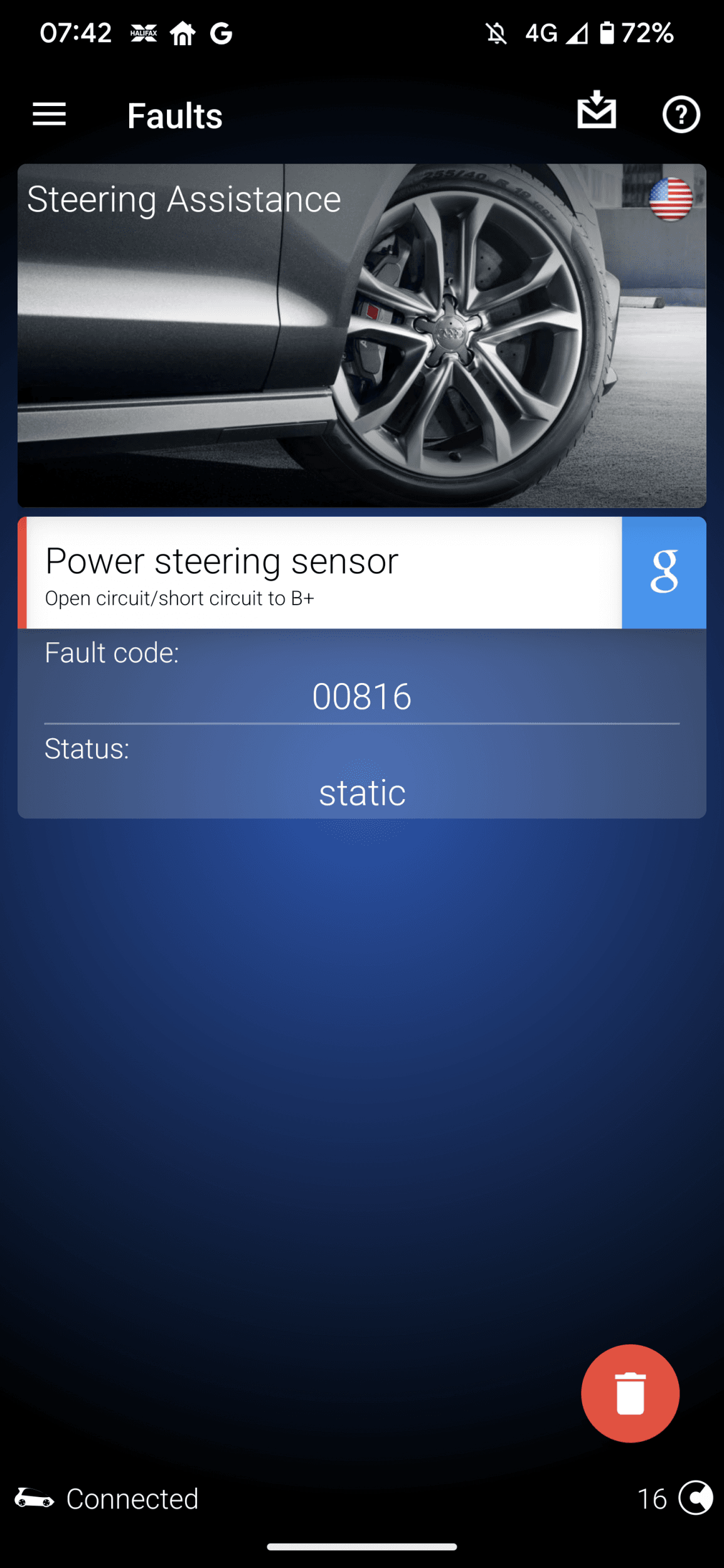

The code I get on obd11 is 00816 which equates to steering angle sensor.

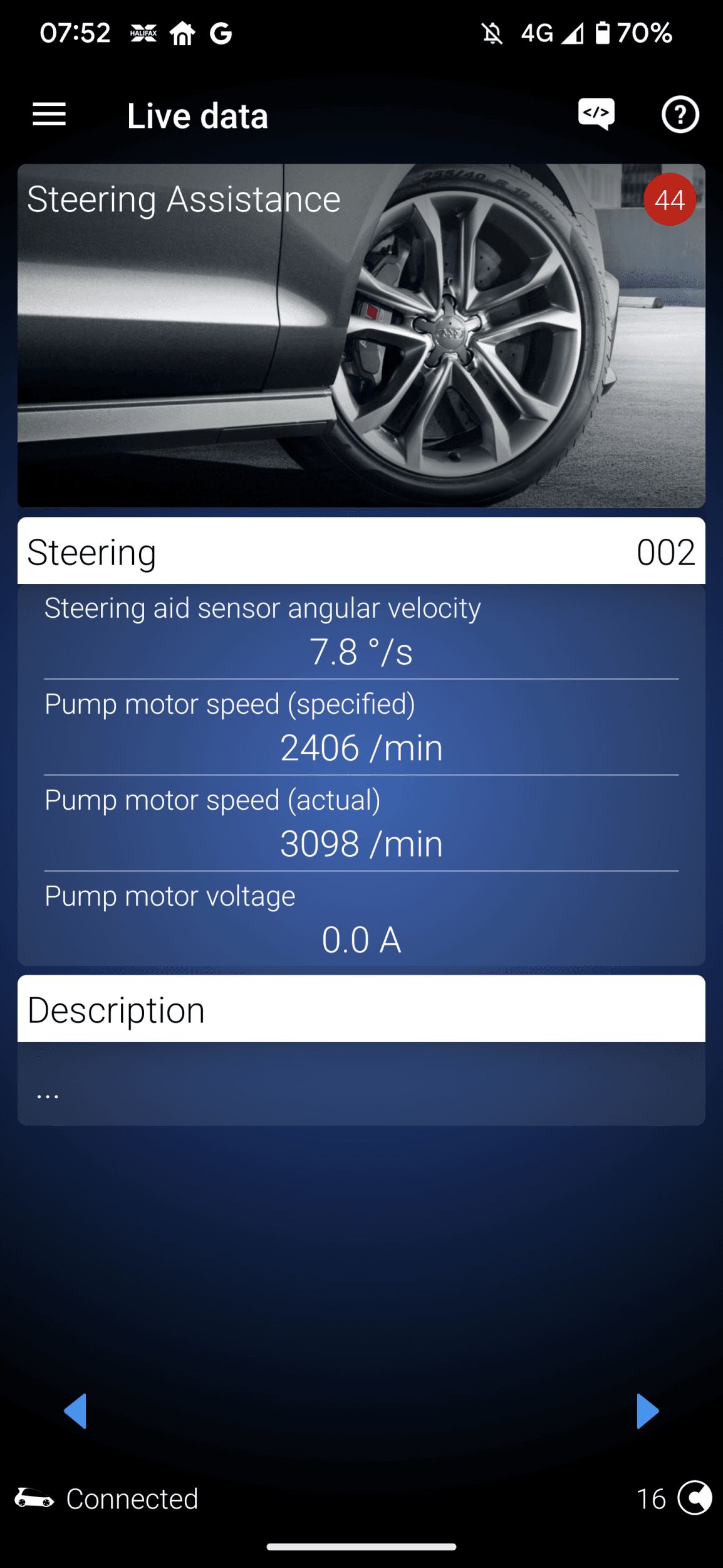

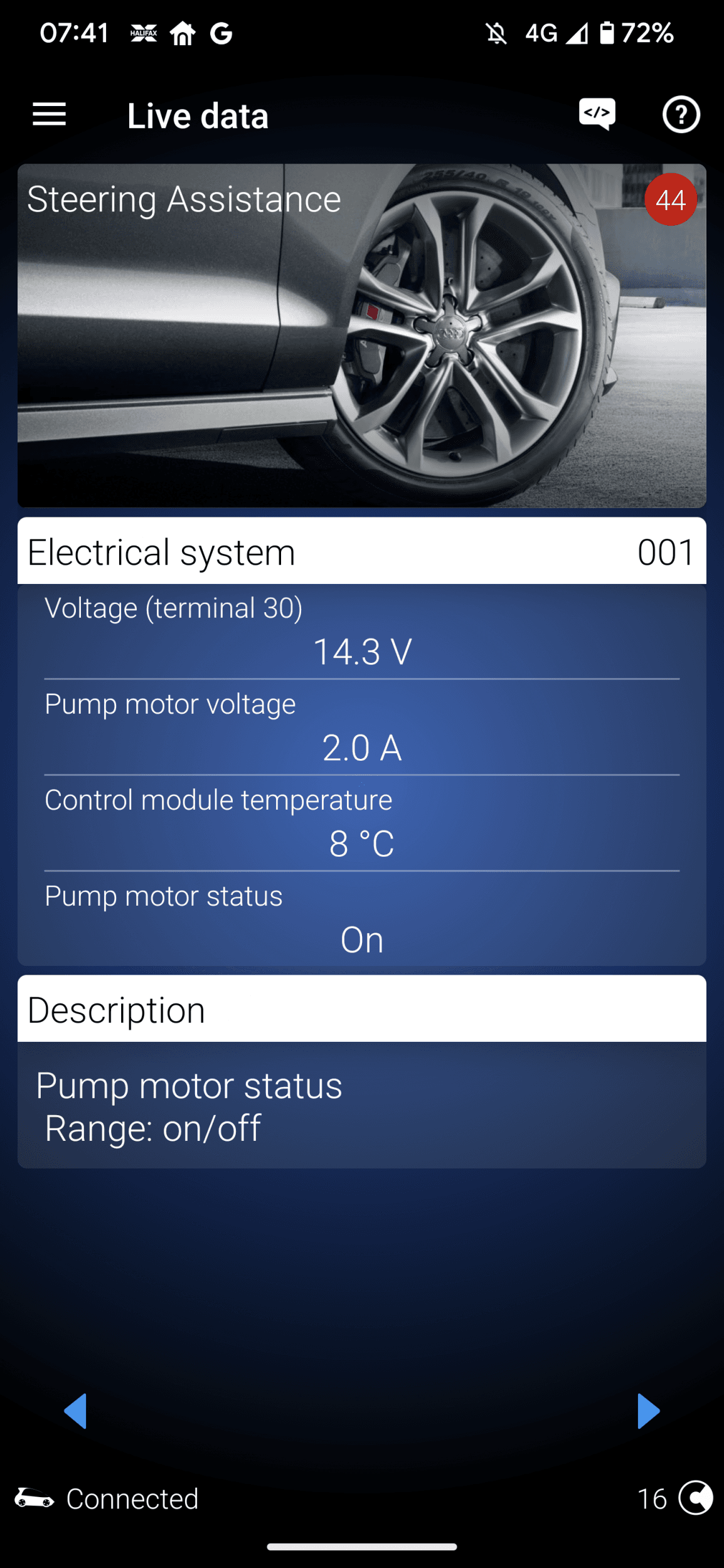

Feb 13, 2020
21
These are the values it was reading when I had tried to force it to work using the coding for the G85 sensor. The screenshot was taken whilst moving the steering wheel. From them would you still say the pump isn't working? I'm in no way disputing what you're saying by the way, just making sure.
Thanks again
View attachment 34558 View attachment 34559 View attachment 34557
this values are impossible
cant be at 3000rpm with 0 Amps
if in fact the steering is th same as when engine is off, extremly hard to turn, then its the pump, when sensor fails and pump is working you still have steering assist but less than normal
