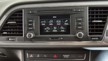

These are pictures of my car and the current system inside.
