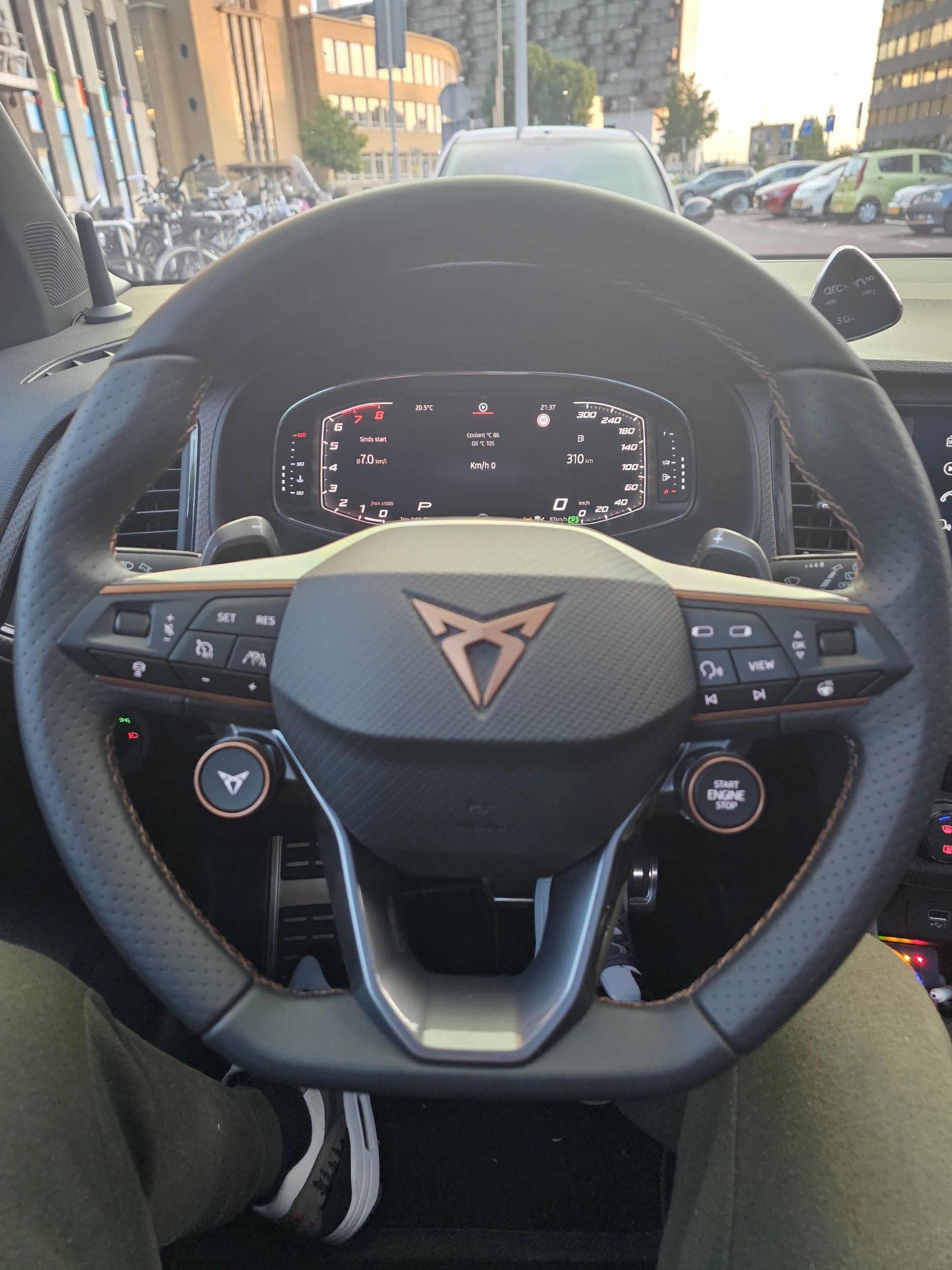

After a lot of research and bought wrong airbag slip ring parts it finally worked all.
Start and modus button works fine.

Can you share the how-to of this project?
You need 3 parts for it.
- 5Q1953549G airbag slipring
- 5Q1953507GG stalk
- Cable set Kufatec ( need tot repin it)
After install connect wires for start button to excisting start button. To let work the start button on the steering wheel.
For the Modus button you need to reprogram in databus 19. With odis or vcp.
