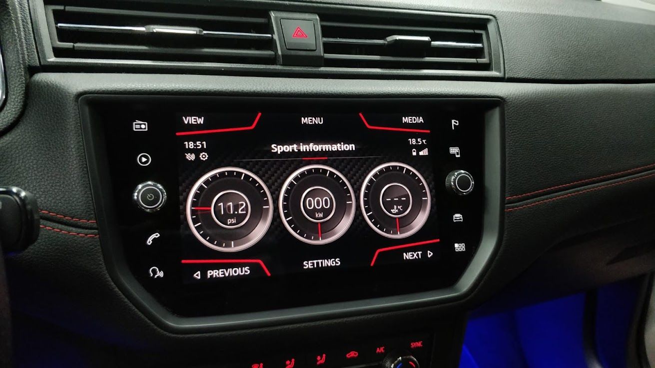

so as i already mentioned, the firmware update went well without errors, and everything functions without issues.
but, in the previous version i had the "sports information" fully working, i paid for it quite amount of money.
Is there any way to bring it back maybe with obd11? i've done everything as explained in that youtube video, but i was not able to open the "sports information" window...
and this is how it looks before i updated the version from 515 to 516 -
Thanks in advanced.

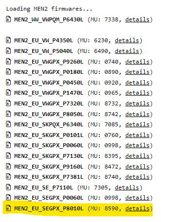

were you able to update? I have the same version. I have this list of firmware from http://mib-helper.com/ but not sure which one is the correctI need to upload the firmware for 6F0035871B (SEAT Ibiza Style 2019)
The last file/software is "MEN2_EU_SEGPx_P8010L"
Can someone give me the link to download the newest version, please.
I think that there are no more updates for this version, in fact in your image the version underlined in yellow is the last version that appeared...were you able to update? I have the same version. I have this list of firmware from http://mib-helper.com/ but not sure which one is the correct
