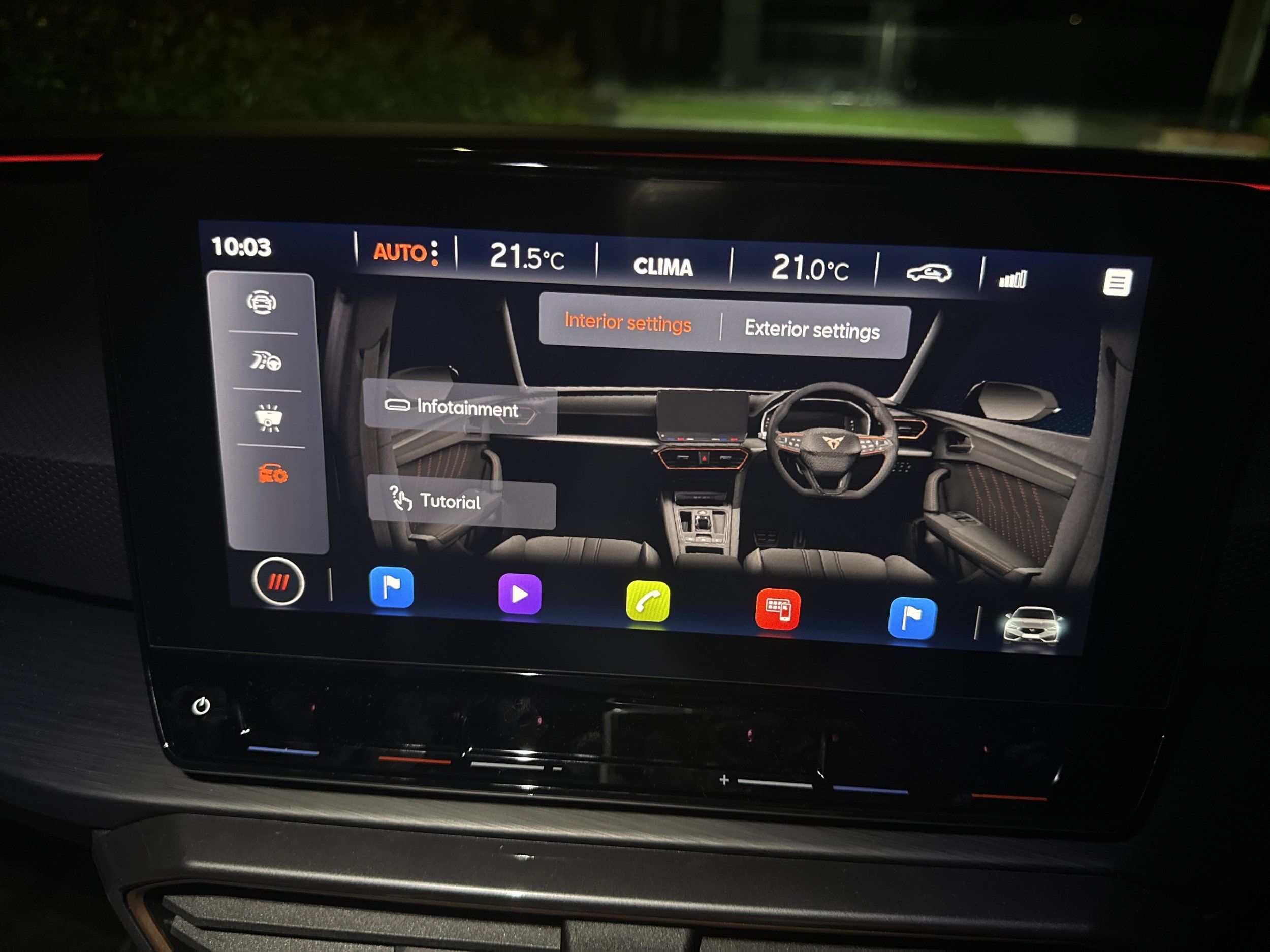

May 15, 2023
Hi, can someone pls help me. This voice recognition is driving me crazy. It triggers all the time, but has never once understood something I ask it. It is just unsafe pressing the x constantly to close it.
I have read all the above, but when I go to settings there at no settings for voice control. Lots for background lighting… but voice, none.
What am I missing?
driving Cupra Leon 2023.
May 15, 2023
Soo.. after trying for 20 mins, two mins after posting, solved it.
There are multiple settings options, I only knew about the ones when you press the car icon. If you change the shortcut buttons at the bottom of screen, you can make one of them a system settings logo. When you click in there, you will find plenty more settings.
