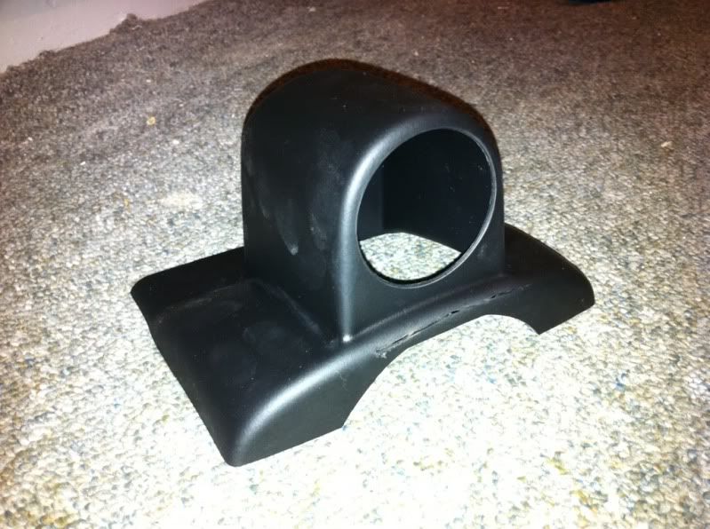

I purchased a Newsouth Column Pod from Awesome GTI

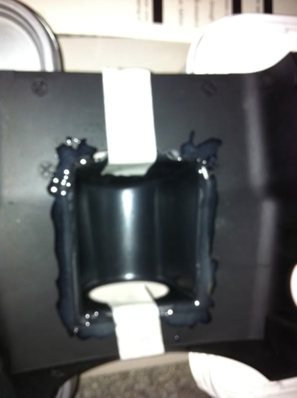

before cutting it up to leave just the pod housing

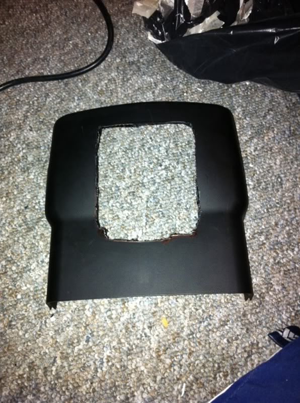

I then cut a hole in the steer column cover
I then glued the 2 parts together after a few test fits and more cutting

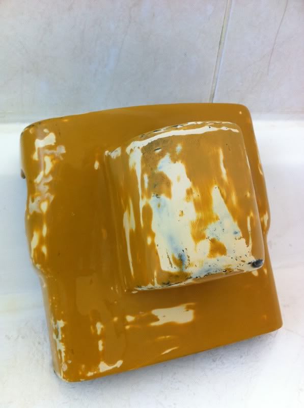

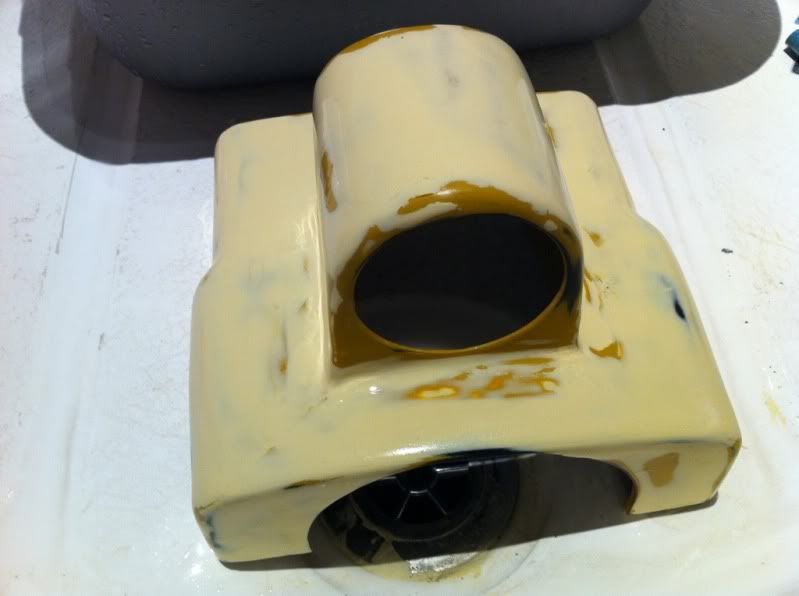

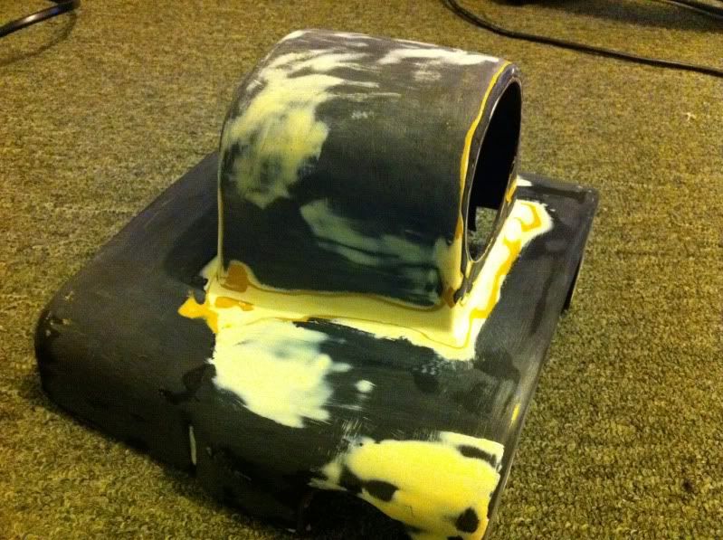

I then covered in filler and sanded back to hide the joints before covering the whole pod and smoothing
Once smoothed, i sprayed the pod with primer, sanded smooth again and then started on adding the black paint and lacquer
