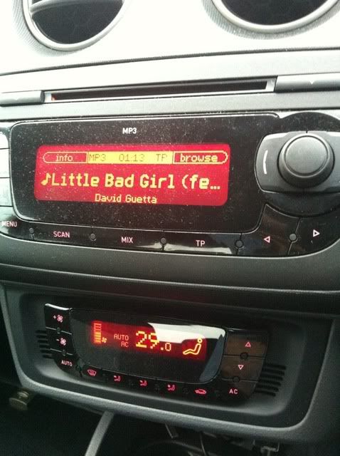

Noticed over the last few days that my climate control isn't working properly, seems its nearly always blowing out cold air regardless of what temperature is set. Works slightly better when driving at a constant speed, but sitting in traffic for nearly an hour this morning all I could get out was cold air. A/C seems fine so its just the heater element. Any ideas? Heres how it was set:
Is there any way to bring up diagnostics on the screen? Beginning to slightly regret buying an early MK5 seems it has lots of niggles and the warranty has just ran out. Doesn't help that there is no temperature gauge so can't tell how cold/ hot the engine is.

Is your external temperatre showing the correct temp?
In the mk3 sometimes it could read silly temps like +40oC and the climate control would only blow cold air on the assumption that is was roasting outside.

Yeah I wondered that but it was correctly showing the external temperature (9 degs)
IIRC its three buttons for the hidden menu.
AC button, Down air and mid air all need to be pressed at once and held in till the menu appears.
Cool will try that at lunch.
