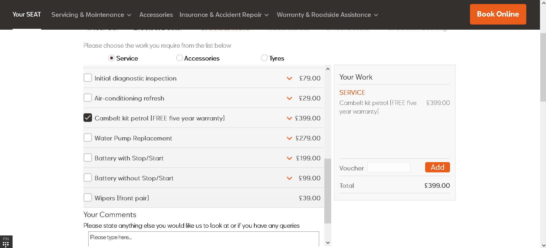

Went to the online Seat Service & Maintenance site, enter the car details and shows a
Cambelt kit petrol(FREE five year warranty) @ £399.
Is a Water Pump Replacement also required when changing the Cambelt then ?

Not if the water pump is not faulty and it is located at the other end of the engine.
Water pumps used to get replaced along with the maybe every other cambelt, when they were driven by the cambelt as needing to go back in and replace a water pump meant all the labour and probably parts already used to replace the cambelt, with just a small extra charge to replace the water pump.

Yep, been doing some digging and it appears that the 1.4 TSI ACT engine is the EA211, CPTA variant with the water pump in the thermostat housing on the opposite side to the cambelt !
Perhaps the service advisor was unaware.
I feel a call is required to ask them why they quoted £700 when the online system is only £399. Assume they'll say the waterpump needs doing at the same time. I can then smugly state the waterpump is on the opposite side, so why.
