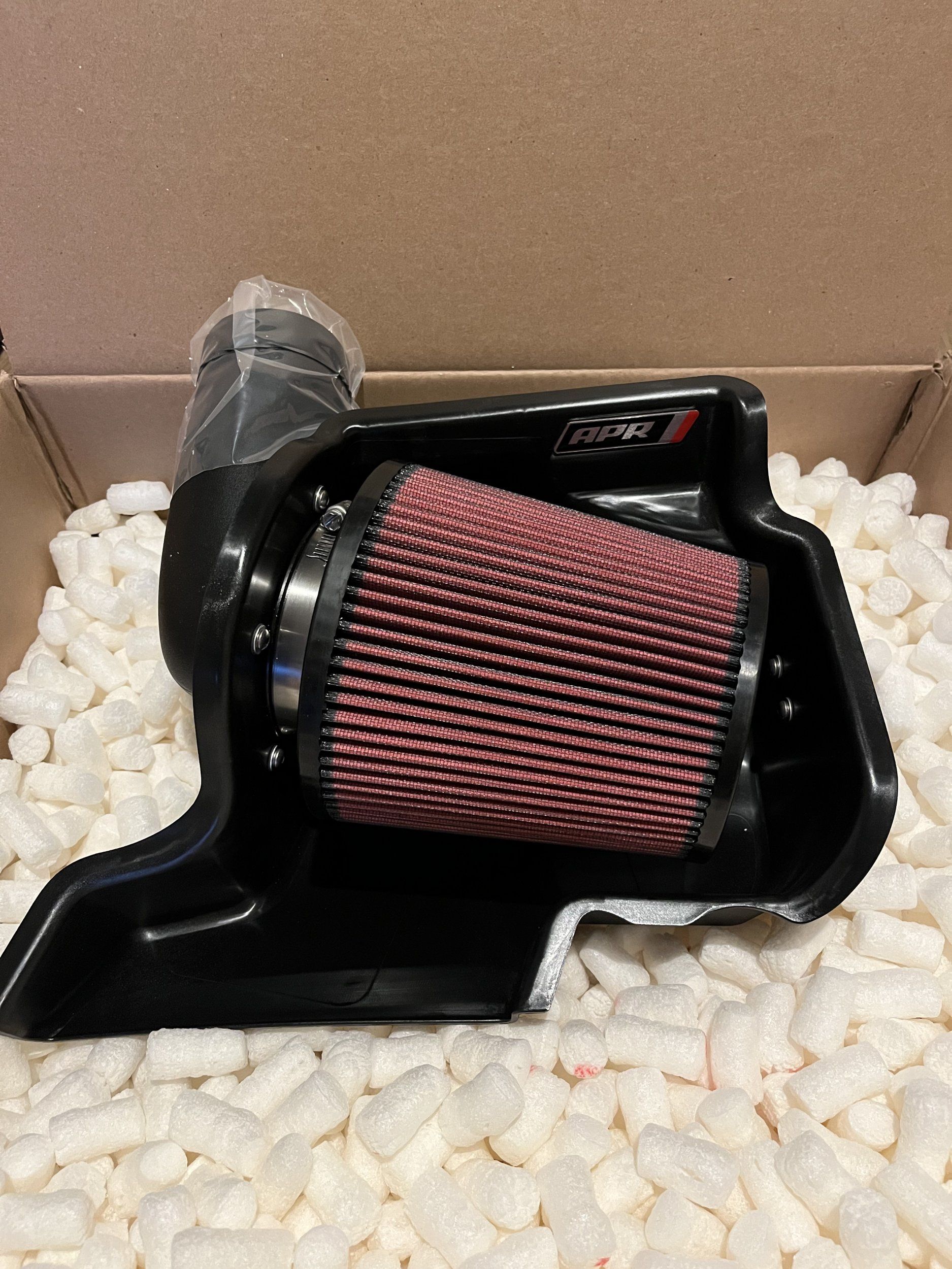

seems its my own thread look what came through the door today tho.
Ah nice, looks quality. If you could do a vid or sound clip of induction noise before and after that would be great, may tempt me to buy one 🤣.
On a good note i threw the induction kit on and it made a huge difference in noise for me. Can clearly hear the spool and diverter now. One of my mates has ordered one for his s3 after he heard it. I will be putting the airbox back on when the car goes to have whatever needs doing next and get the comparison for you. Sounds much different when driving so might have to get the mrs hanging out the window with my phone haha
