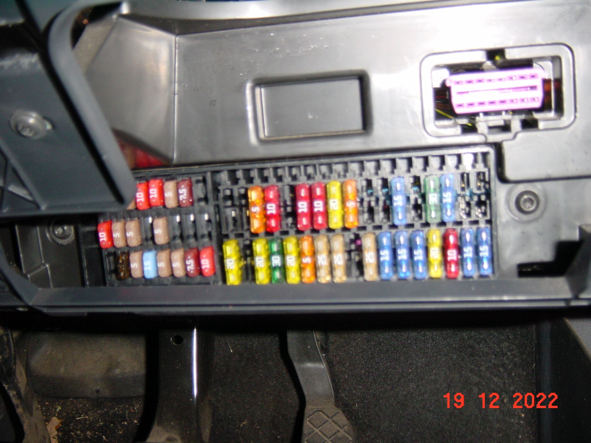

Out of all the different years it looks most like the 2008-2012 model but rather than having 3 smaller fuses below each other on the right MINE has this on the left side of the box with 2 fuses below each other on the right side - I have uploaded a photo
Out of all the different years it looks most like the 2008-2012 model but rather than having 3 smaller fuses below each other on the right MINE has this on the left side of the box with 2 fuses below each other on the right side - I have uploaded a photo View attachment 34850
Maybe it's mounted upside down because the car (I assume) is RHD and that's the only way they could fit it? It's just a guess

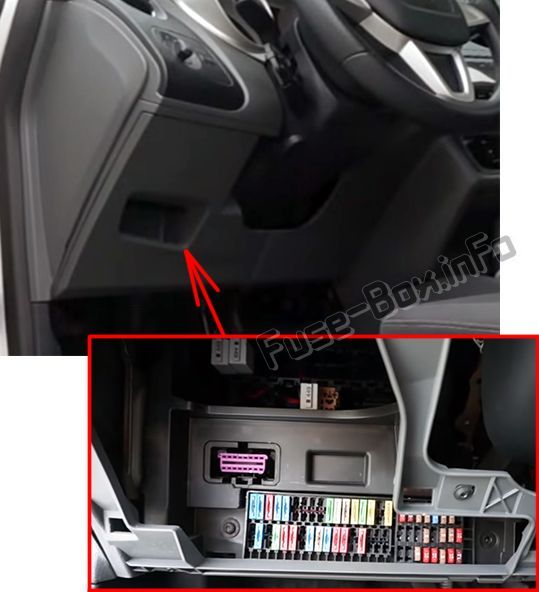

In their example, the position of OBD port and that other rectangle look mirrored

That's a very plausible idea Thanks - mounted upside down - this really messes with my head but I am going to download the diagram and get the software to flip it - did you notices the 3 bank fuses are tiny / non standard
I would test the upside down theory by removing the 12v / cigarette lighter fuse. That should be the safest one and easiest to check if it's the right one

If you look at my fuse box photo (upside down) you will see that fuse 27 has a 5Amp fuse in - I pulled it and replaced with new fuse - no good. I then pulled every 15Amp fuse and put new one in - no good - help !!!!
