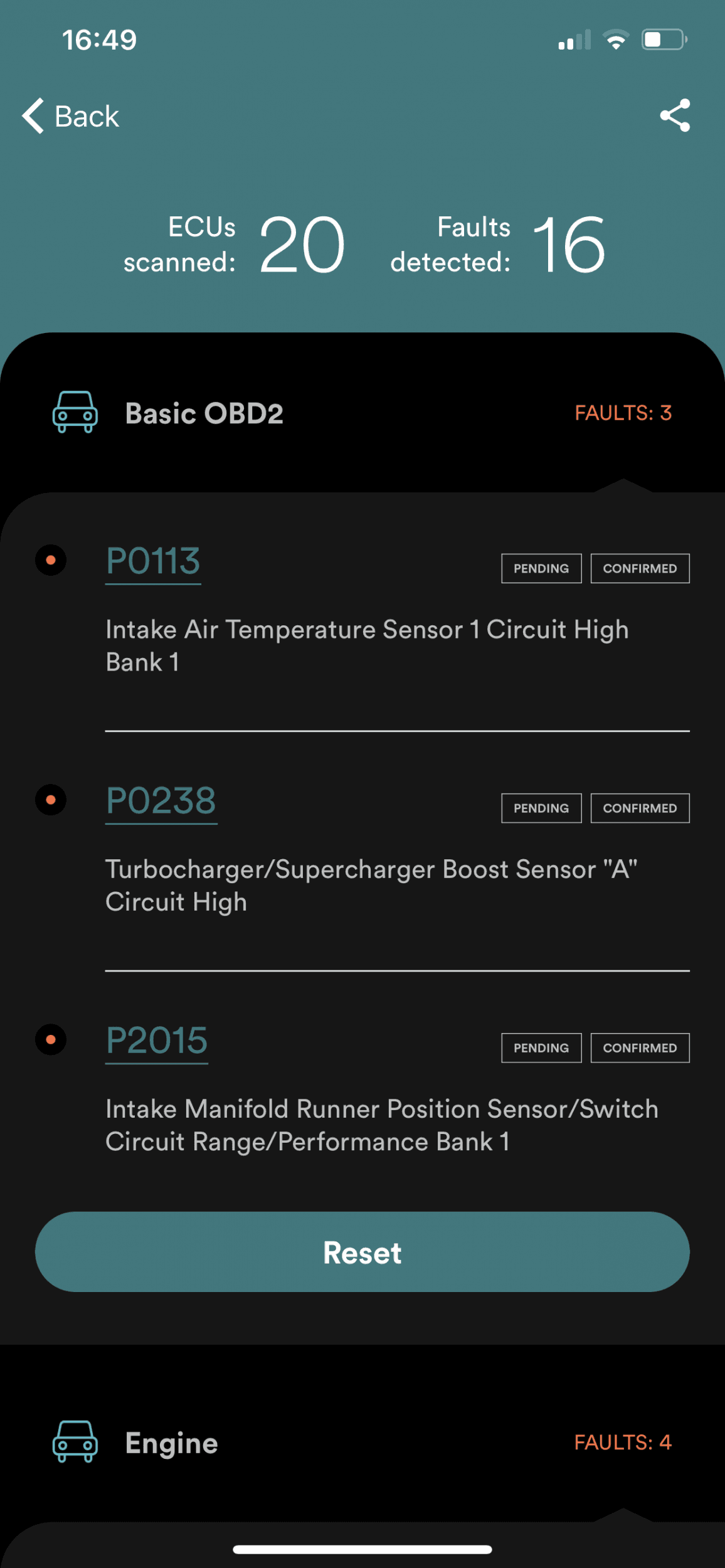

About a week ago I was driving home and as I was slowing approaching a roundabout the MFD flashed a warning saying “Engine Fault: Workshop!” accompanied by a flashing orange coil light on the dash. Engine didn’t cut out or appear abnormal in any way, but when I went to pull out onto the roundabout, I could immediately tell it was down on power, felt like I was driving the 1.5 diesel 106 I passed my test in. Made it home and scanned the ECU with Carista and it gave me the following faults
P0238 Turbocharger/Supercharger boost sensor “A” circuit high
P0113 Intake air temperature sensor 1 circuit high Bank 1
Ive tried clearing them and P0238 immediately comes back without me even starting the engine, I’ve tried resetting the ECU with no joy and replaced the boost pressure converter again with no result.
The car will drive but its as if the turbo has been bypassed, if I open the window I can hear the turbo spooling under load but there is absolutely nothing in the engine response, it struggles uphill and barely hits motorway speeds.

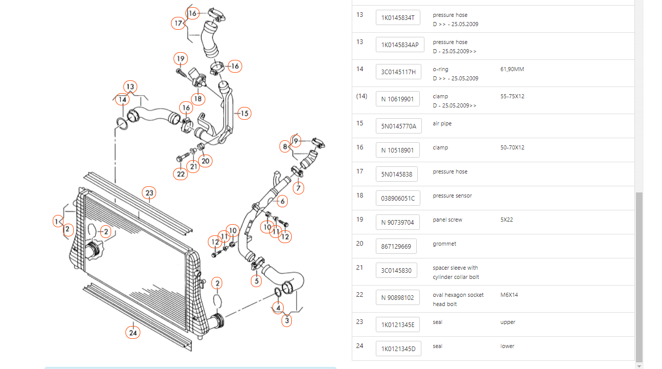

Where is the MAP sensor located on the CEGA engine?
In the intake pipe (15), sensor MAP is the number 18 on the image.
Reactions: kevo13
Thanks, that was a great help. My next question is how the hell do you replace it, I can just about see it never mind get to it!
You'd probably need to take the pipe out from underneath. It's held on with 2 captive screws. One on the side of the engine and one on the front.
This is the latest from an error scan. Bought a repair kit for the intake manifold fault but I doubt it has anything to do with the boost issue.

I’ve now replaced the MAP sensor (not fun trying to get that out with the rads/intercooler in place) and replaced the exhaust pressure sensor, with no luck. Tried a vacuum test on the turbo actuator, and the actuator rod moves as vacuum is applied so now I’m stuck?!
Yeah, as soon as the electrical system is switched on but without starting the engine
Spoke to a local tuning company and they ran a more in depth diagnostic, recommended repairing or deleting the swirl flap actuator as that is what is causing the P2015 fault, which in turn is causing the other faults as the engine is unable to regulate airflow and causes the ecu to have a tantrum. I tried a temporary fix of jamming a piece of rubber hose between the manifold and actuator arm to stop it over rotating, cleared the fault codes, and it worked, but left a new error of the ‘swirl flap stuck open bank A’ so it’s still in limp mode. Just waiting on a permanent fix to be delivered, but any how to guides on removing the plastic manifold on the 2.0 tdi CEGA engine? I know there’s one or two spline drive bits I need to get, but any other help or pointers would be appreciated.
