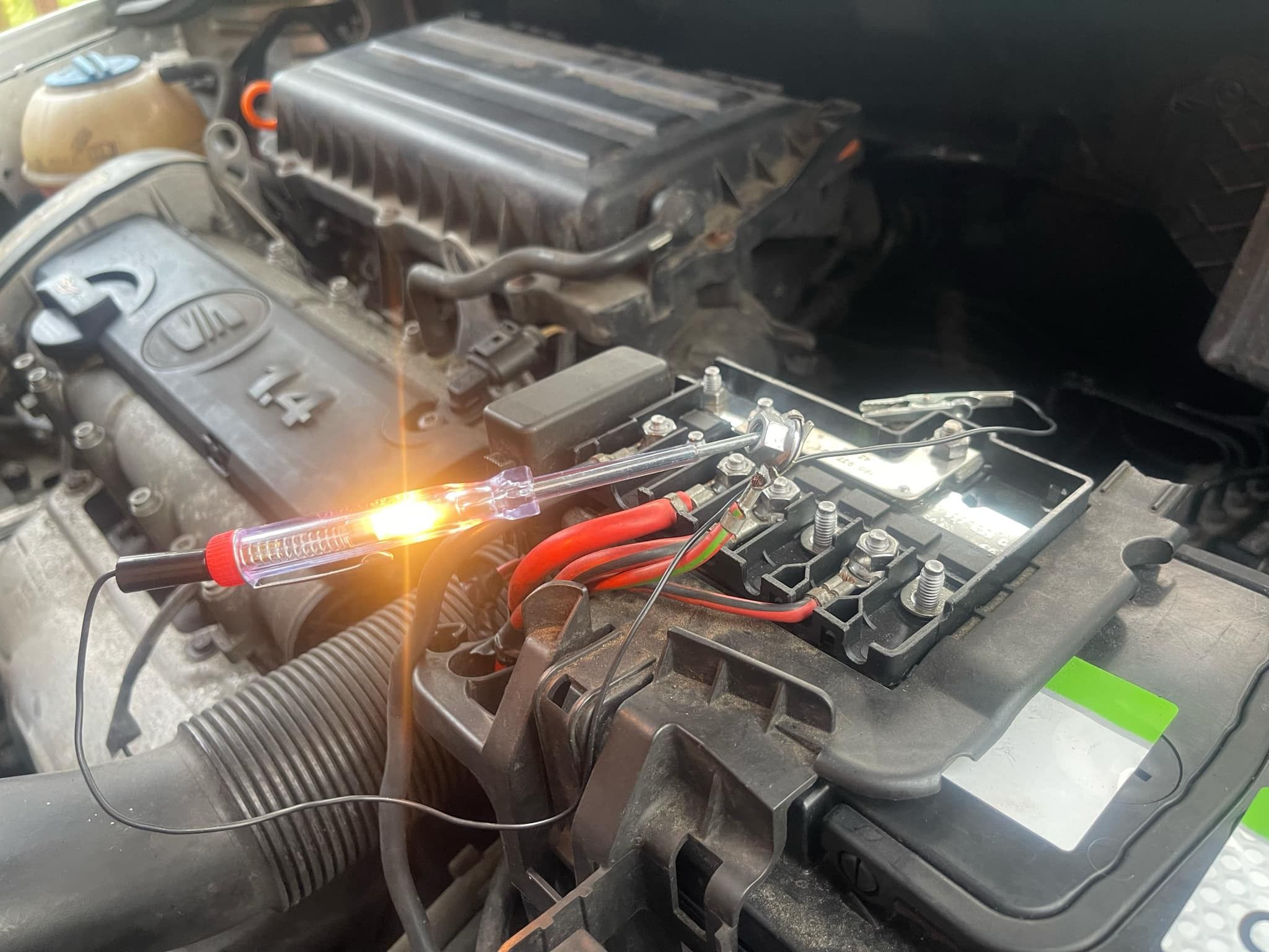

My 2009 Ibiza SE flagged up an ABS fault and the pump is constantly running looking for help for the possible solution.
The picture is showing power going through this wire without it being connected - the pump turns off if this wire is removed and the fuse thats usually the common issue is fine.
- Checked all fuses
- Replaced entire fuse box on battery just in case of corrosion.
Any help would be appreciated!

That's a weird one. Think you need to get a wiring diagram and see how it's all wired up. Have you checked the plug going into the ABS controller and pump? MAybe there is some corrosion in there shorting something out?

I've checked it all out nothing looks damaged seen some posts saying to leave it unplugged a few hours and plug it back in, seen people saying replace the fuse anyway, check for damaged wires & biggest one is replace the ABS module which in this case the module seems to be responding as it should just doesn't really want to turn itself off.

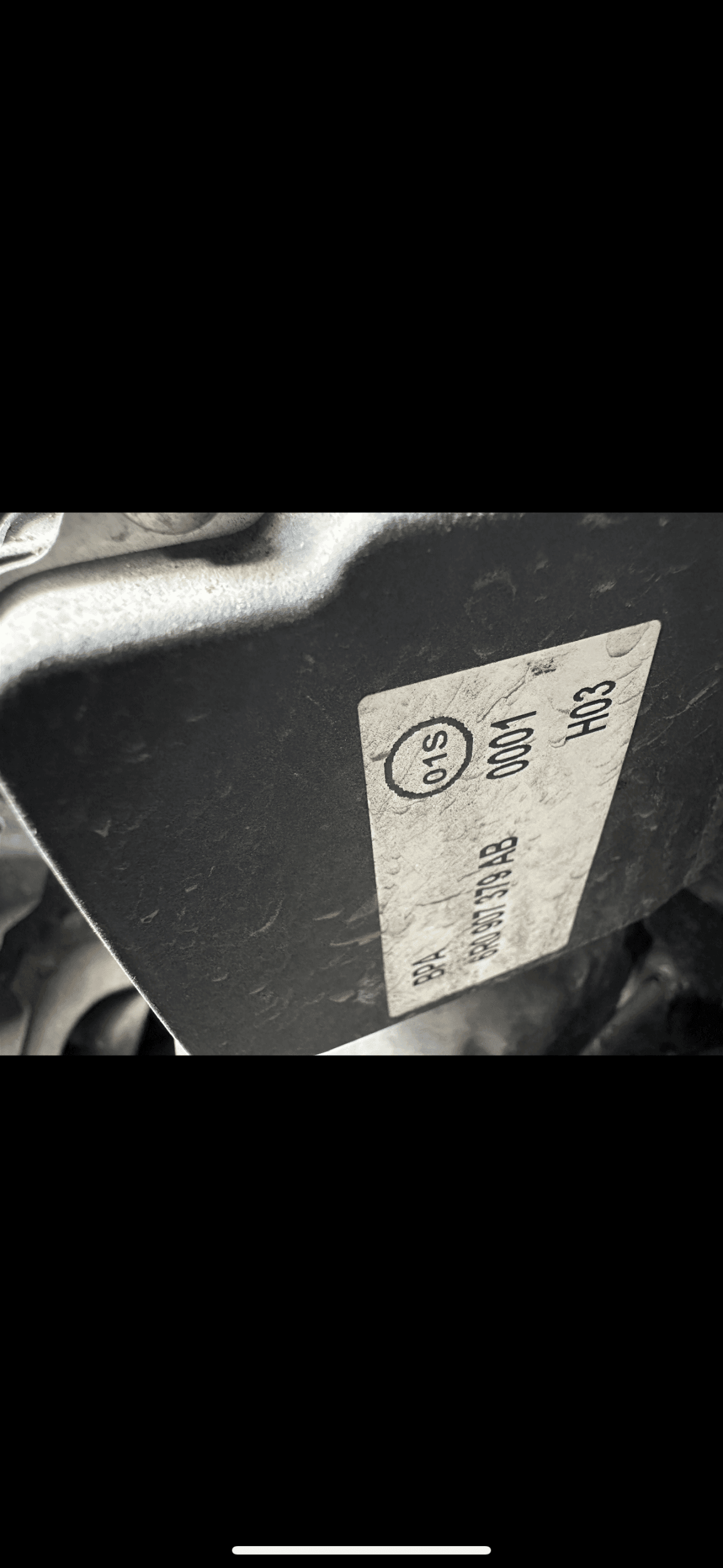

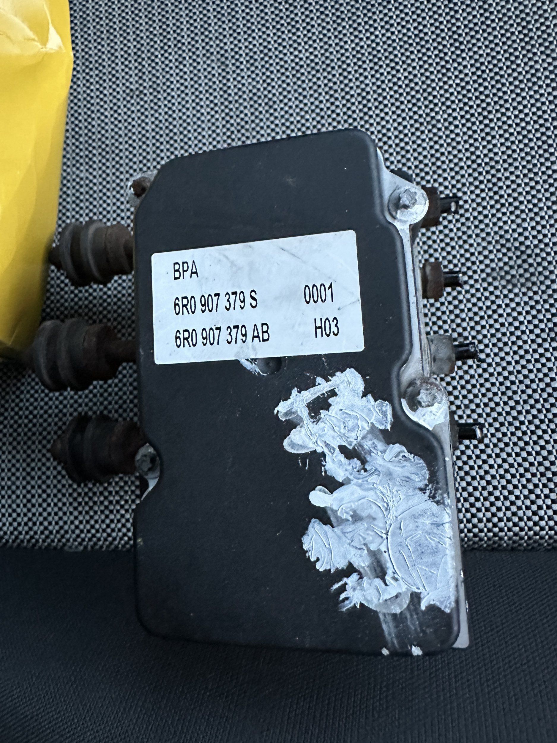

Hi,
I’ve got a similar issue to the person who started this thread, I’ve bought a new pump and just wanted to confirm the pump will work with my car. The part numbers are the same for the one I have purchased and the one that’s in my car. But the one I purchased has an additional part number which is confusing me. Here’s the pictures for reference
I think you'll be fine mate. Probably just means that it is compatable with both those part numbers.
So i went to the garage and it’s coming up as incompatible with my car, so apparently it’s not which is very weird, anyway managed to find one with the exact same part numbers so hopefully the issue should be fixed
That is weird mate. Maybe the seller labeled it wrongly? Fingers crossed for you that the other one is ok.
I called the seller and he said it should work it just needs to be selected from the menu- however the 2 auto electricians I went to haven’t been able to figure out how to do it. Does anyone here have a clue?
