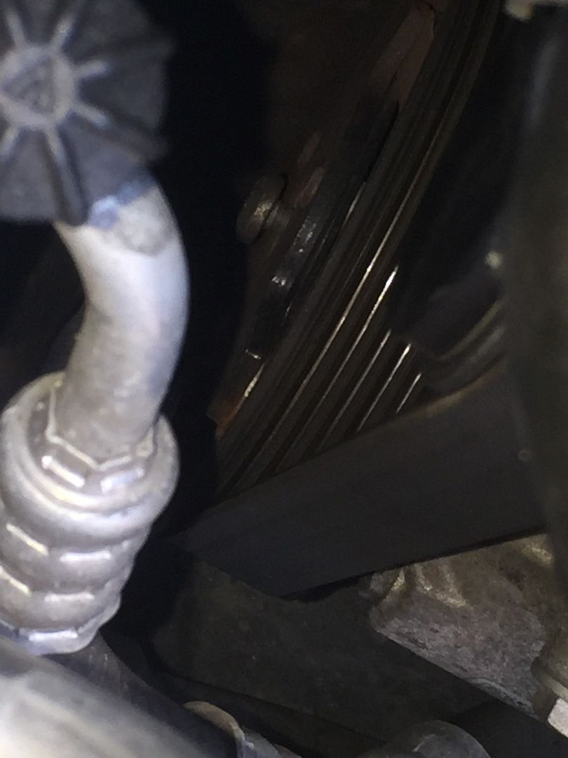

Right I've just had a bit of a mooch under the bonnet and looking at the compressor there is a bolt in the middle of the pulley that looks to screw into the black flywheel looking thing, that bolt is not screwed in all the way I'm sure of it. I don't know if it's supposed to look like that but to me when you can see the thread of the bolt it's not screwed in properly.

Hi matt can you get a picture at all I know not easy with the location but if the pulley is loose and not driving the compressor that would cause your air con not to work.

Lol well that doesn't look right, I'd strongly suggest tightening that properly. if it's already tight dont force it buy a new bolt. and try that first may have cross threaded the bolt which is why it's sticking out like that.

I had the same issue with the previous work Passat (62 plate) . The gas leaks out from around that bolt. You can try tightening it , best of luck. VW are aware of the issue, and as my motor was out of warranty at 75k ( although only 2 years old) were prepared to make a 'contribution' which basically meant my company was still left with a £600 bill.....
