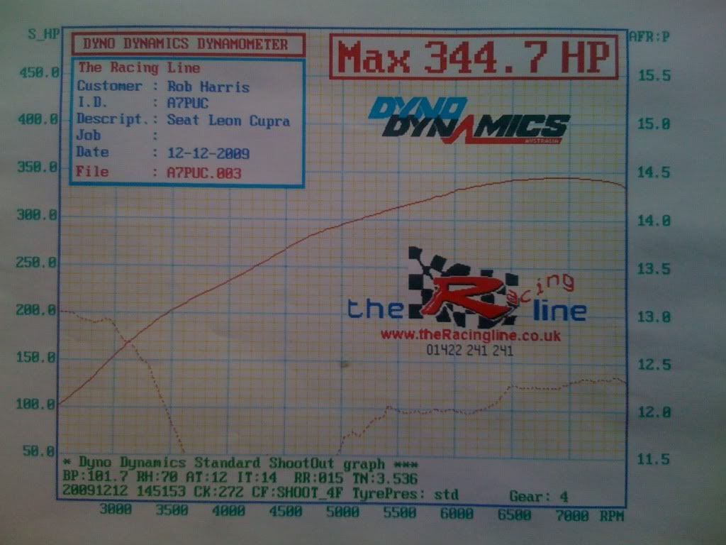

How can i tell what my air fuel ratio is?
i know it can be done when on a rolling road , i have vag com or more recently known as vcds can this show me waht my air fuel ratio is? if so would appreciate some info pointing me in the right direction :)

Log block 031 in VCDS which gives you your actual and specified Lambda readings, then multiply them by 14.7
For example - 0.81 x 14.7 (stoich) = 11.9 AFR
Just a note, you may already know, but VCDS logs are saved in .csv format which can be opened in Microsoft Excel. It is very handy opening them in Excel and creating graphs to compare results.

thats 2560 rpm
further up the range at 5200 rpm same figures
on another run at same rpm requested .91 actual .89 and at 5200 rpm requested .83 actual .82
so whats it all mean then lol

When under WOT full load you want to have a AFR of 12.5 or under.
The lower the AFR the more fuel thats being added..

just one last thing if my car is running lean im guessing its my ecu adjusting ? or is there a way or what affects makeing it running a tad richer?

If your standard which i think you are, you should be running fine but obviously with an afr of 14.4 your not.
Ive no idea how to adjust a standard map, are we sure those calculations are correct from the vcds????
Obviously with Revo you just add a bit more fuel with the sps.
