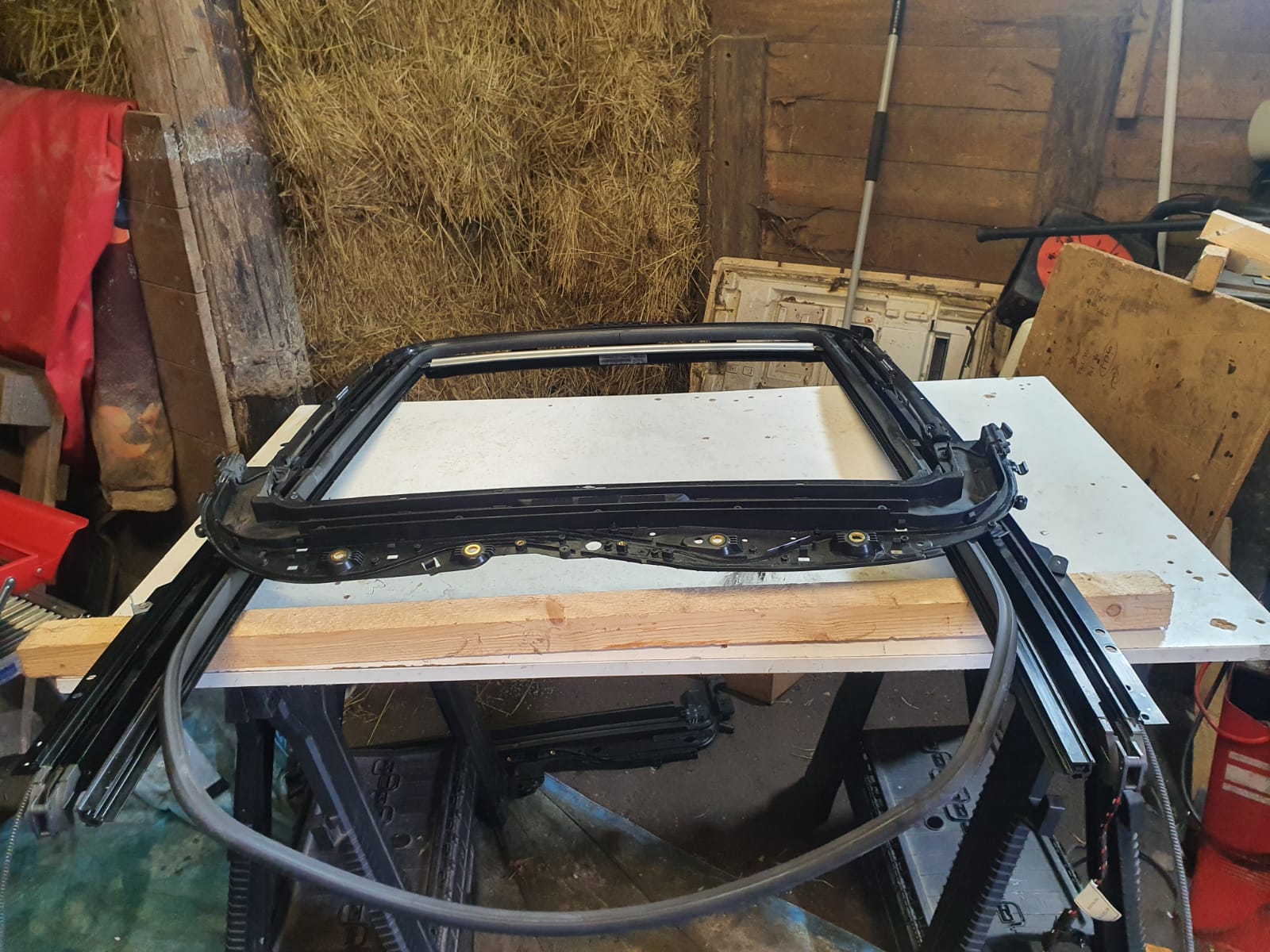

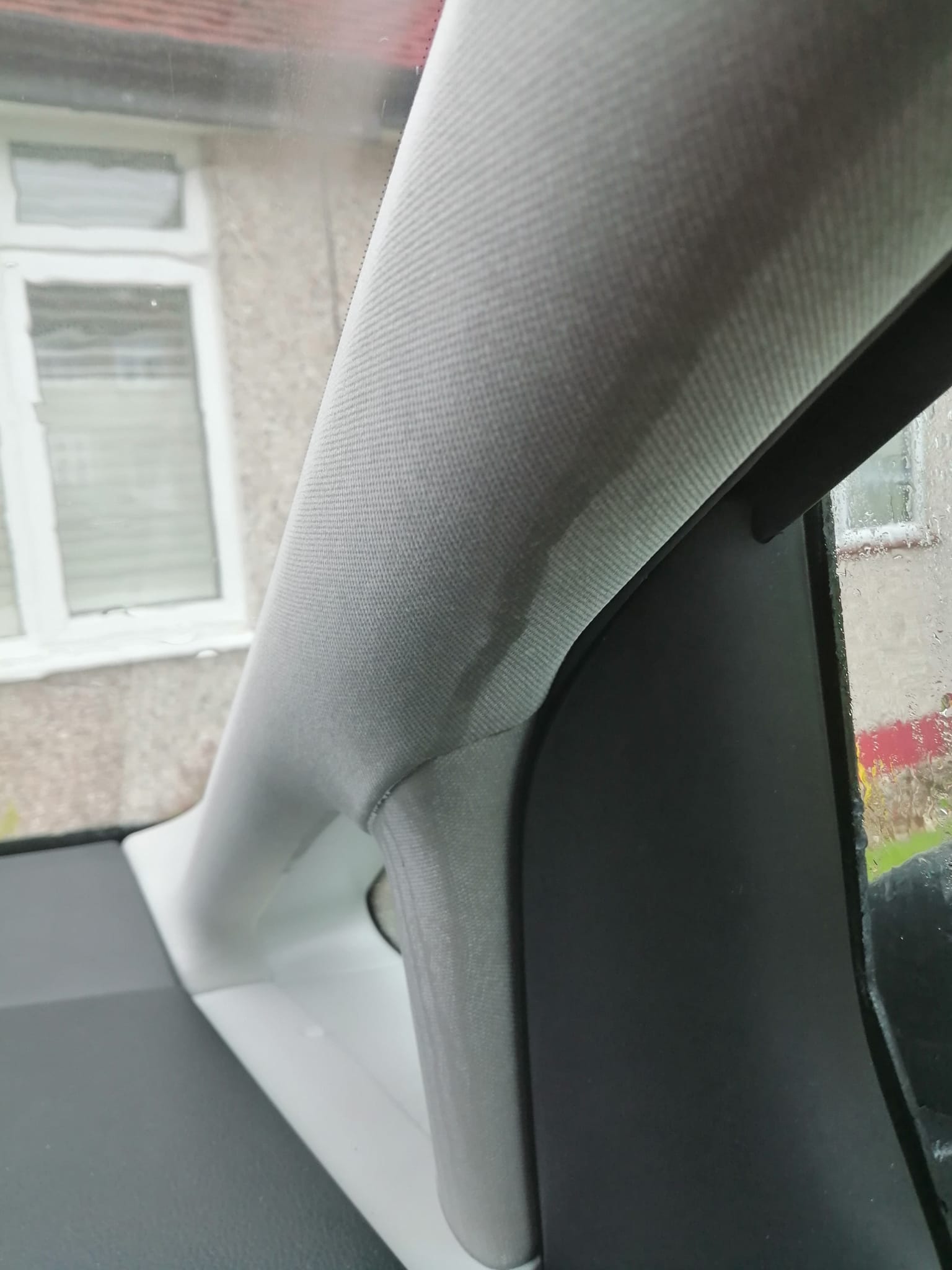

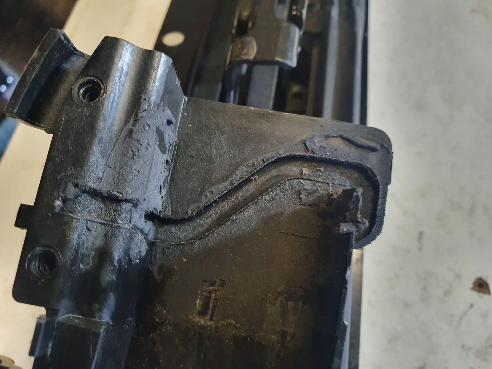

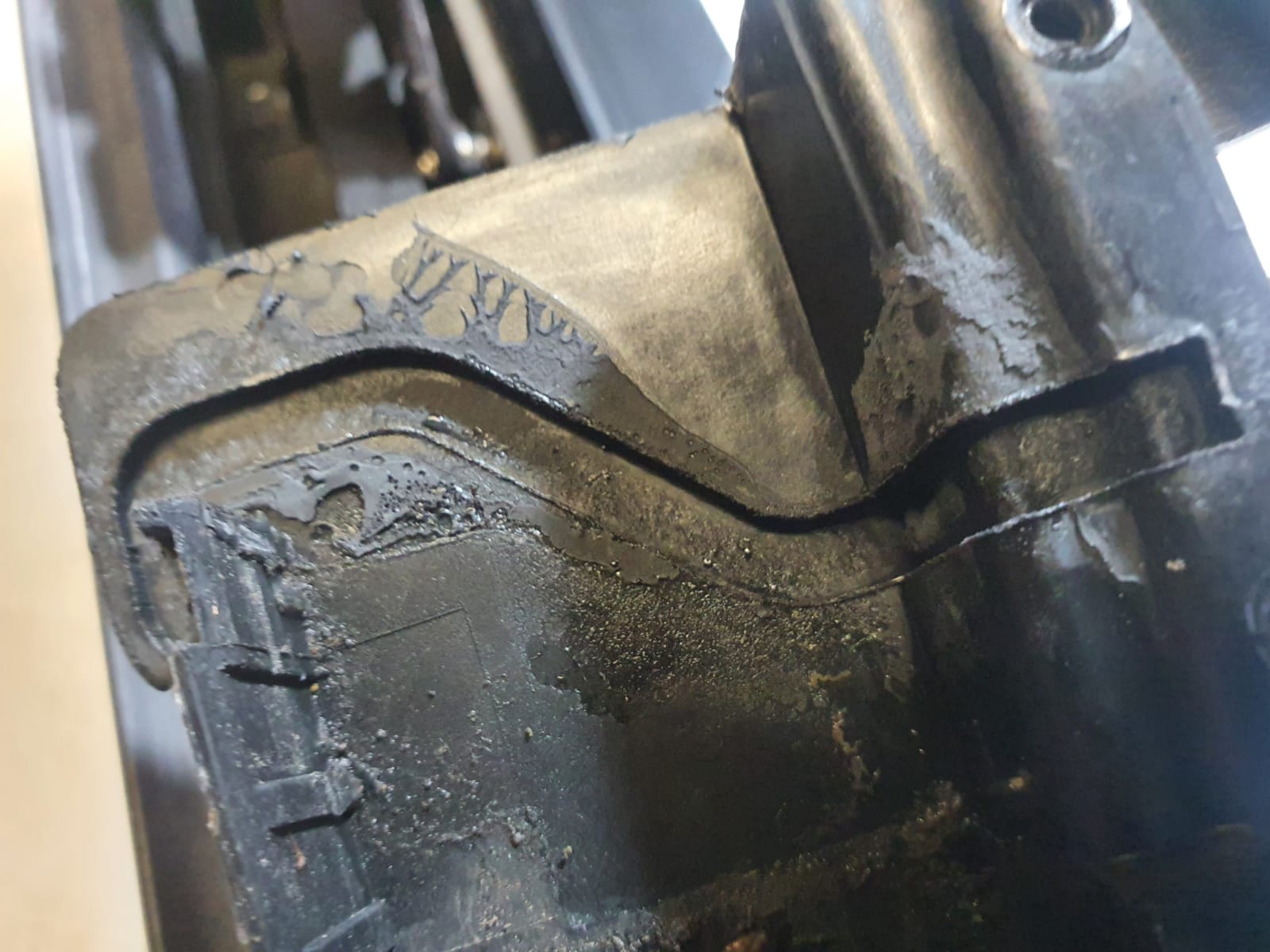

Thank you to everyone that posted with some advice on what it could be. We managed to resolve this and I thought to share some information as it might help others. I must be honest that I was pretty dubious that anything would work. We had only had the car for 6 months, and it was a great car for our needs. I was a bit stunned that a car of only 6 years old would need this sort of work done.
We were given the details of Surrey Sunroofs near Dorking, chap called Andy. I cannot recommend them enough. He seemed to be very familiar with the sort of problem as described and was confident that it could be fixed. They had the car for a week and took it to pieces. The bond on the frame of the sun roof had eroded and he rebonded various parts of it. Some comments in the pictures. Problem solved and it feels as though we have a new car. Nightmare over.

Hi Rob. It cost £800, which we ended up splitting with the dealer. They were really fair about it. For us, it was the difference between keeping or not keeping the car. I shudder to think what it would have been like recently, with all the rain we have had.

I have purchased seat alhambra 2017 and there is a leak on the driver’s pillar and not sure how go ahead with this. I have cleaned the hose with jet air from the roof and did all sorts but its still leaking. Desperate need of some help. Please and thank you.

Morning. Sounds as though you have the same issue as I did. First thing you do is clean out the drains with air and see that all the pipes are connected properly and not broken/cracked. After all that it's likely that the bonding has worn away on the sunroof (like a big disc that plugs into the roof). I took some good pictures above. You can see all the detail. Let me know if you would like the details of the company that fixed mine. They were really good and deal with this sort of thing all the time. I spent alot of time speaking to the guy about it and it's very common on Alhambra's and a lot of cars with a sunroof. I didn't think that it would ever be fixed but there is a solution and it's brilliant once it's done.

No problem at all. He will definitely get to the bottom of it and sort it out. He said that there was hardly any bond/sealant on the front drain channel and he resealed another two parts of the sunroof. I think that the sealant they put on the cars seems to wear away pretty quickly, which lets the water in. I would not expect to have this kind of issue on a car that is 5 years old. If you look at my post above, (6th March) you can read his message to me with the comments and some pictures of what they resealed. Hopefully the tape works! I put the cover on my car last night as the sliding doors have been frozen shut due to the cold. Absolute pain.
