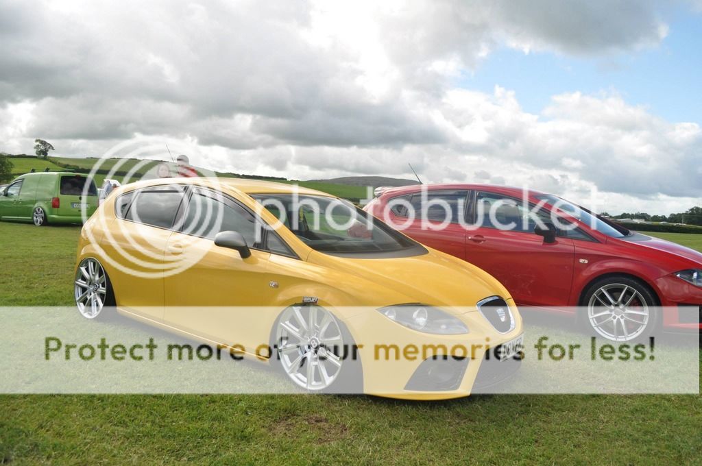

It's what I have fitted will dig out a pic if you want
Yeah would be great thanks :) Also which tyres would you recommend for that size alloy?
I have not got 245 tyres fitted I have 235s, rears are also slightly cambered, fronts rub the moulding on the inside of arch in the splash guard, but then again I guess I'm fairly low, if I was doing it again I would go 225s
