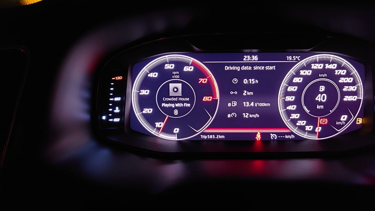

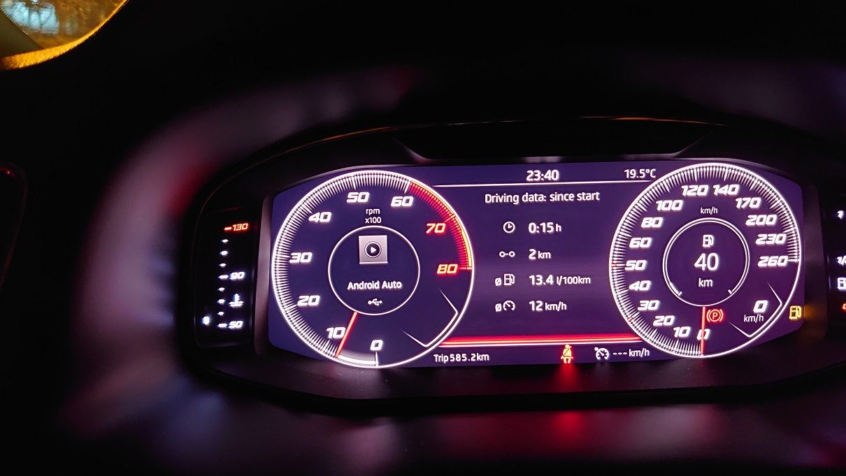

Hello all,
When I connect my phone via Bluetooth and play a song on Spotify, I can see the song name on instrument cluster.
But when I connect via Full Link, it doesn't show song name, I see only "Android Auto", as you can see in the attached photos.
My 2018 FR has MIB2 Std and first gen digital instrument cluster.
Is it any different in MIB2 High units and/or revision A/B clusters?
Is there anything that can be done for it to show song name also in Full Link?
