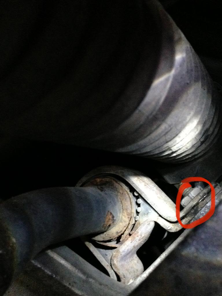

Im in need of swapping out my anti roll bushes on my 2009 leon but can't figure out how to get the bracket off surrounding the bush. I'm assuming the bracket opens up somehow surely.
Any help in the right direction would be appreciated
Thanks in advance
The only way to separate the bracket is to drill the captive nut out from the bracket. It isn’t designed to be taken off unfortunately however people do sell bushes for it.
Drill that from the side the bolt goes threw a tiny bit and the nut will come off and the bracket will split in 2. Then use a washer and nut to do it back up. Hope this helps.
