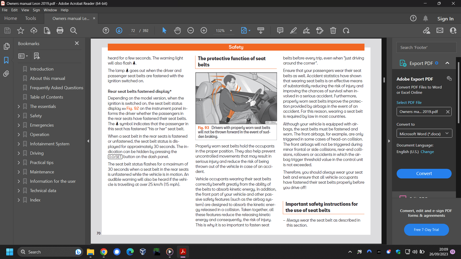

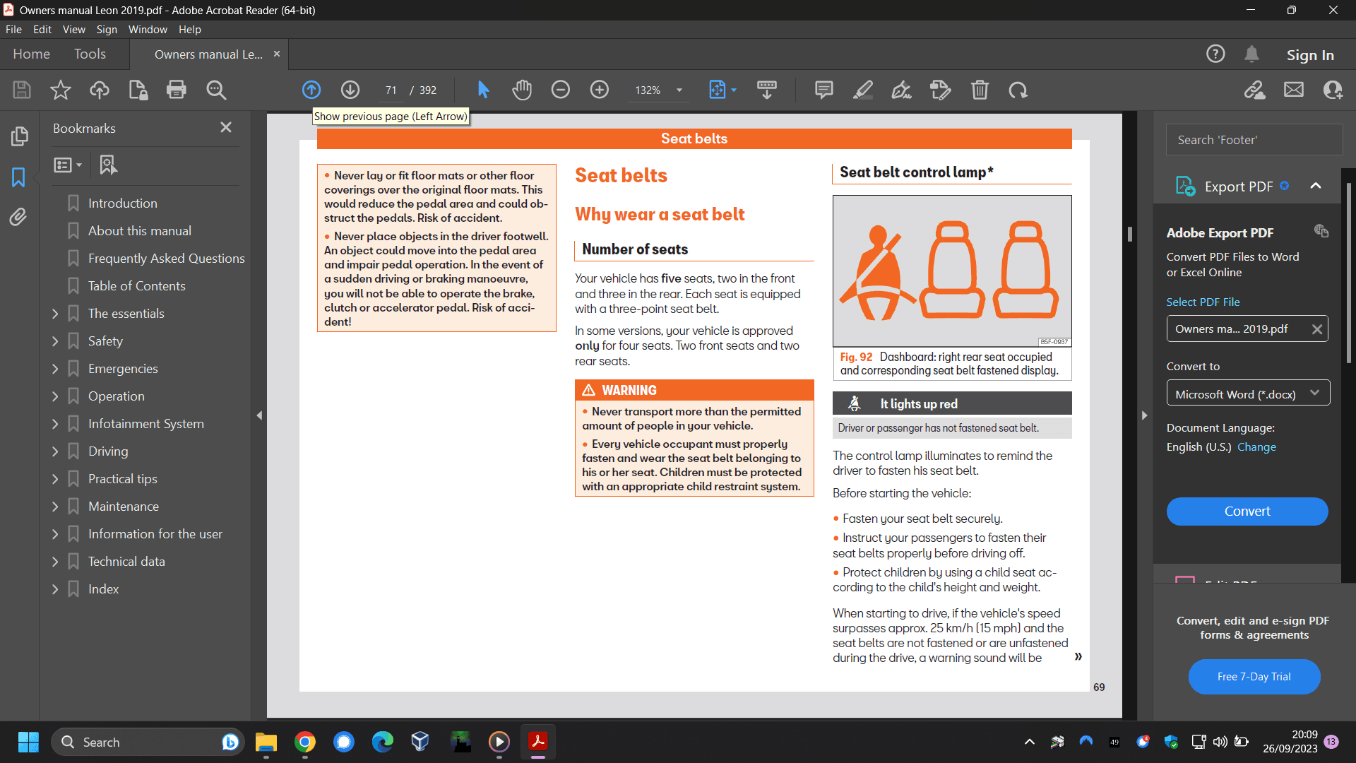

@serdar_18fr .......this option certainly was fitted in some Leons - this is from the 2018 edition of the UK Leon handbook
Reactions: serdar_18fr
