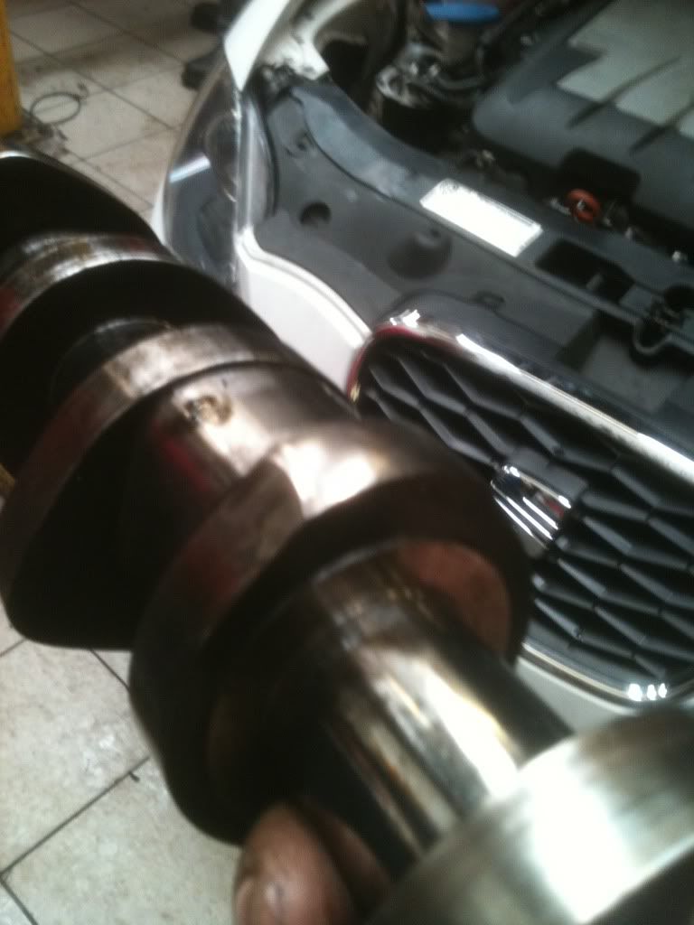

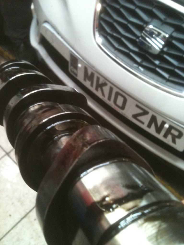

Heres a couple of pics from a 1.9tdi pd engine that only had 60k on the clock, again - full history, genuine correct spec oil used
ignore the '10' reg car in the background.

its a gamble with any pd engine regardless of age or type but most are ok and only fail around the 130k mark.
its about £1000 to be repaired properly.
the gearboxes be it 5 or 6 speed are all fairly reliable - its the clutch/flywheels where the problems occur.
I know a lot of people who have had PD engined cars, ragged them every day, never serviced them and they have not had this issue.
I'm looking for one with around 60k and don't intend to run it past 100k but having seen the picture of the cam out of the 60k mile car I'm wondering if i shouldn't be considering a car that could potentially need major engine work.
Is there any prevention to this that can be taken, such as replaing the cam before it fails? Also are the new cams that are fitted a new design that doesn't suffer from this issue?
Sorry for 101 questions but I really don't want to buy a potential money pit.
