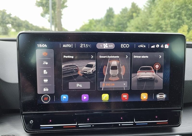

mysticscalex
Mar 27, 2024
15
12
Check the tab Driver alerts, in there it should show blind spot detection or something similar. From there you can also change the Led light in de door panel brightness. It is possible that your variant does not have it.
there is more talk in this forum: https://www.seatcupra.net/forums/threads/blind-spot-detection.473190/
when you click on the driver alerts tab Side Assist should pop up first if you have it.
