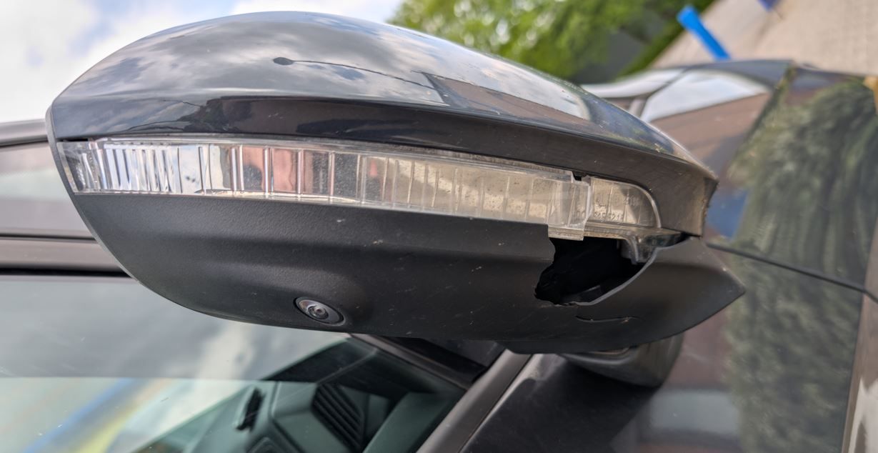

I came out to my car one morning and found someone had managed to clip the wingmirror, suppose I should be happy at least given how close they must have been that they didn't take the side of the car out.
Question is, can I get the lower casing separately so I can replace it or does it only come with all the tech already installed, I can only find spares online with everything for over £350, but it's only the lower plastic and indicator that are damaged.
I would have the tech pack with lane assist/puddle light and camera in it.
Any help would be greatly appreciated.

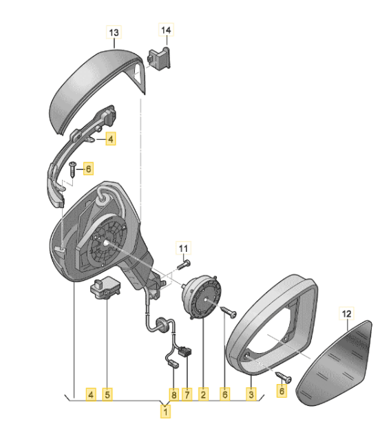

Lower casing has no separate part number to order.
It comes with all the parts numbered 2 through 8.
