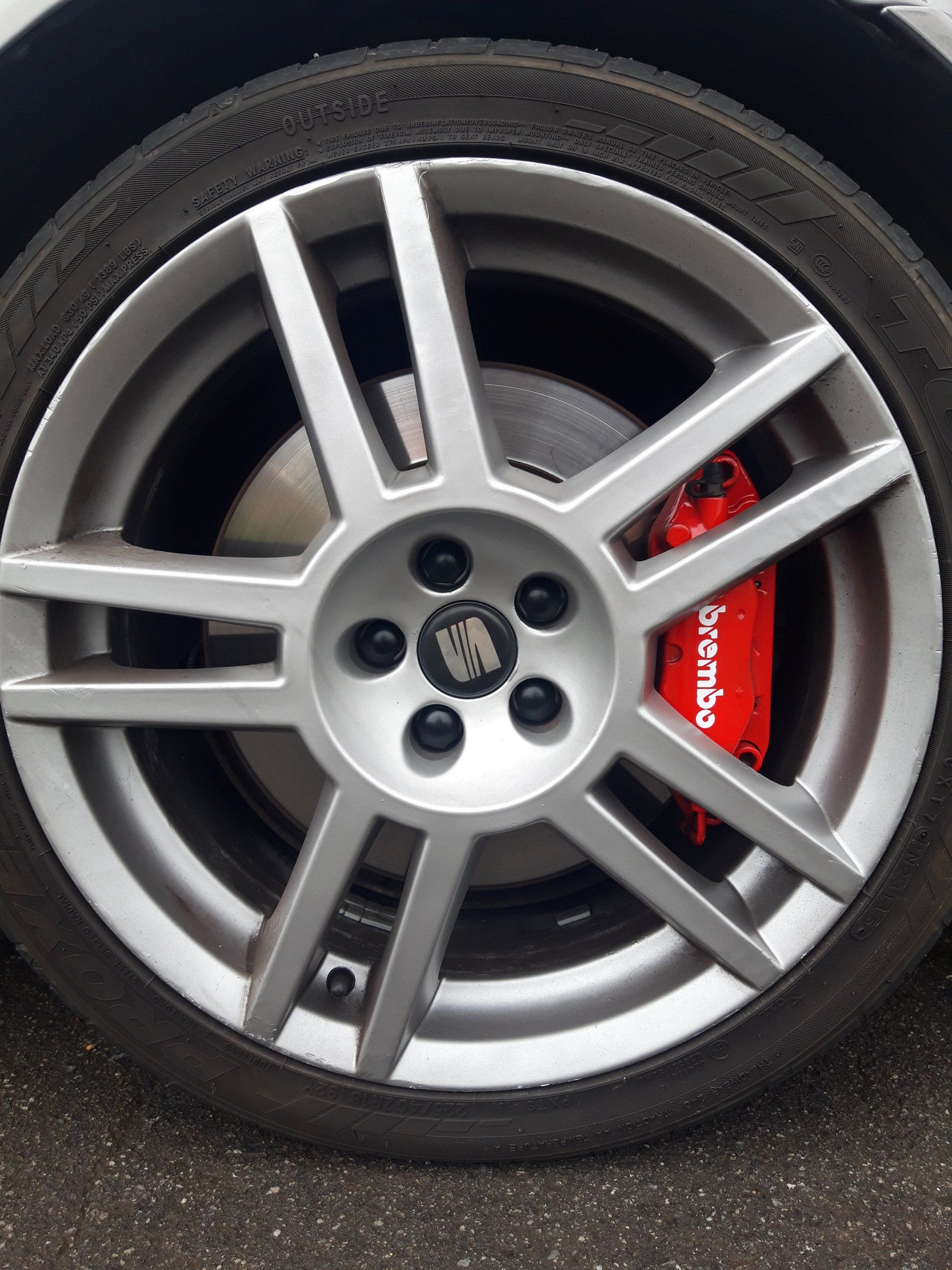

Did mine with cans.
Reactions: Thai-wronghorse

Yeah wanted to do it before getting wheels refurbished. Had car 11 years so just needs a bit of a tidy. Suprised it's lasted me this long.
Rich.T
Feb 15, 2020
1,609
932
Thats a very clean job, have those wheels been done as well? Look perfect. Just watched a video online and doesn't look too difficult to get them off.
Yep, i did those aswell and the bolt caps.
5 wheel silver and a bit of sanding down of the scuffs around the edges of the rims.
The car is in daily use so did one wheel a day.
