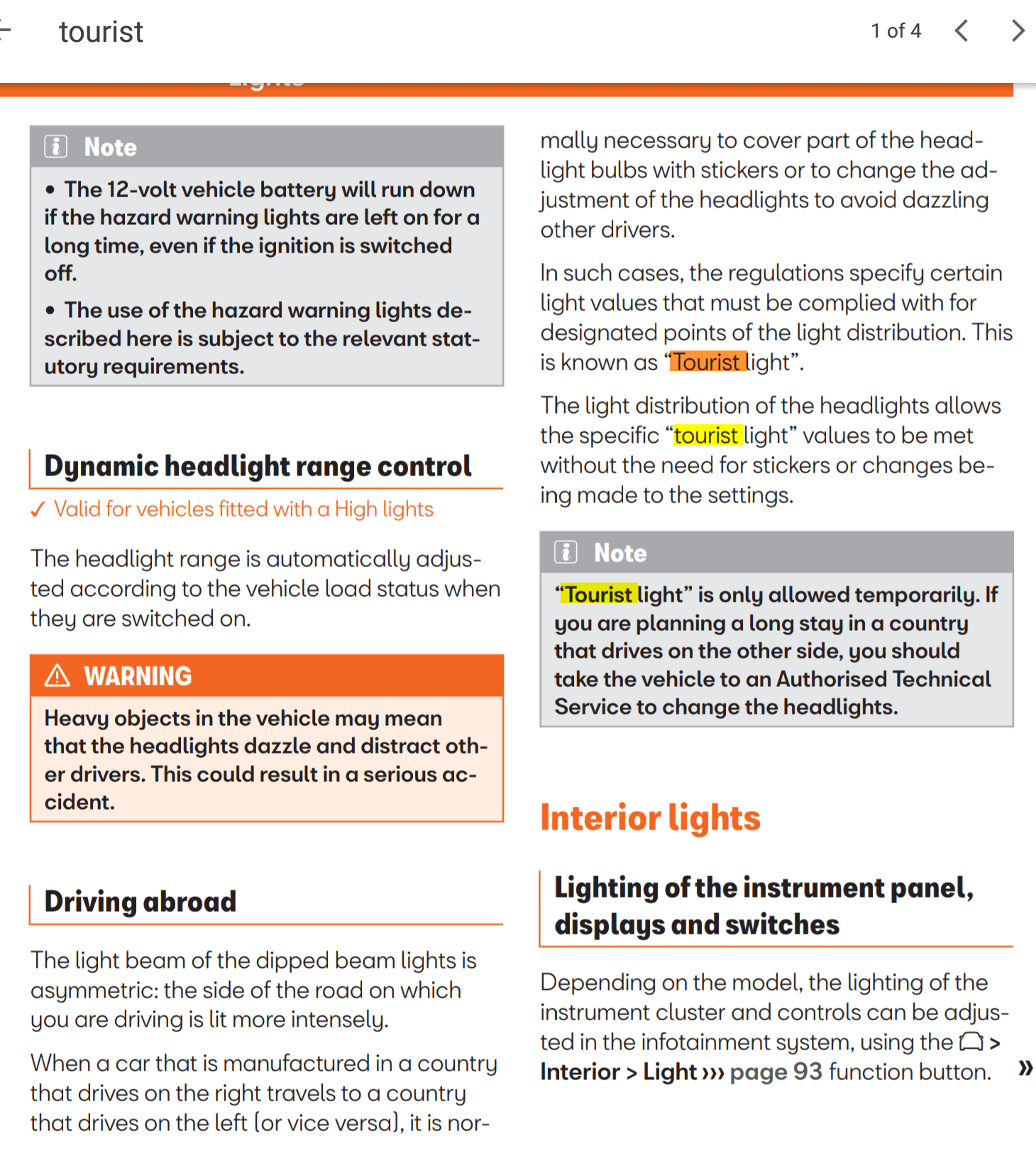

There is a tourist mode (tourist light) which detects driving on the other side accordingly and adjusts the beam pattern. The manual does say for long stays abroad you should get your headlights changed
Ah ha. New tech perhaps. 2016 LEDs they just legally spill light but built into the hardware nothing clever about detecting whether you were driving on the left or right and switching modes unless it was one of those Seat publication errors.

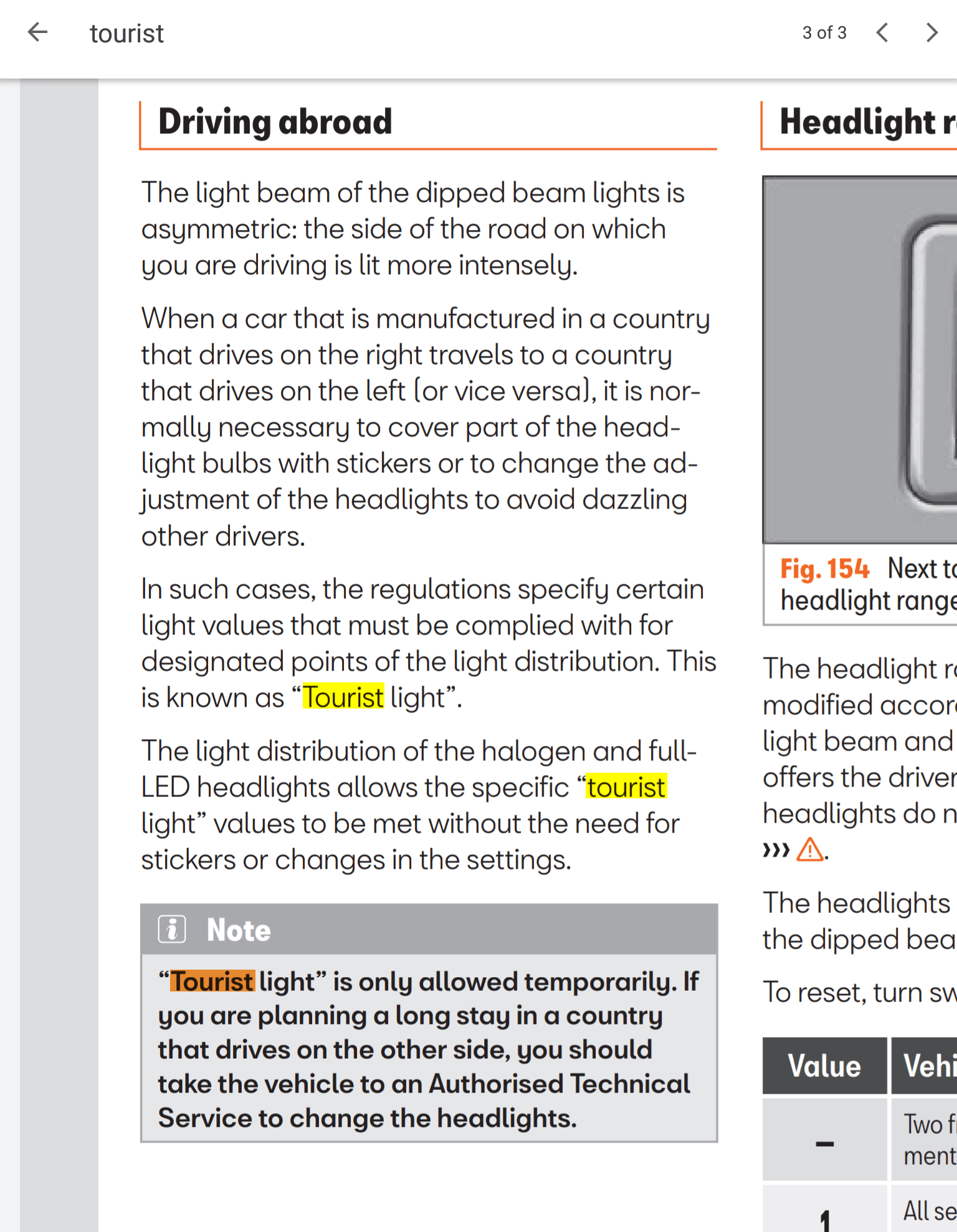

Researcher in me checked both pdf manuals Ateca 2018 v Leon 2020, word for word identical. I suspect it doesn't detect what side of the road you are on, just set up for RHD or LHD with a legal EU agreed spill but if you are planning to stay then the lights must but be adjusted / replaced by a dealer.
Ahh I must of misread it and hoped it was smarter than it was. There is a panel of 11 LEDs for the dipped beam, you can see each one reflect in the glass, I thought perhaps they were just turning off a led to change shape
My understanding it's a different unit fitted with a different part number. That's always said. You'd have to go to a parts web site and check. Swap out of the whole unit.
