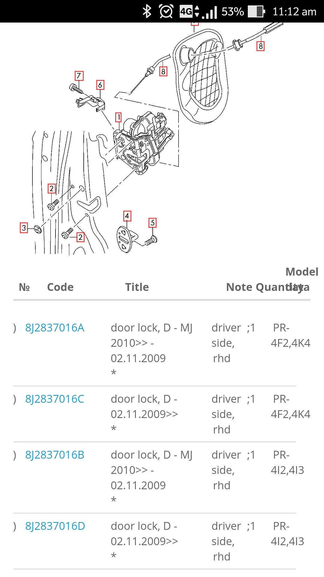

Below diagram (for my previous A4) shows the front door actuator as item "1". Be aware of the 2 versions for the front due to LHD/RHD.
