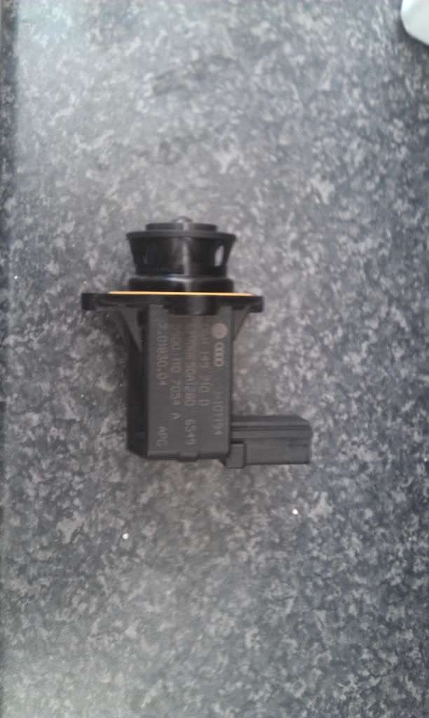

Hi all i am currently getting a funny whining/ hissing noise at around 3,000 rpm up to 4,500 rpm.
I am not sure what it is but i thought i would check my diverter valve which i have changed and is a rev d version,

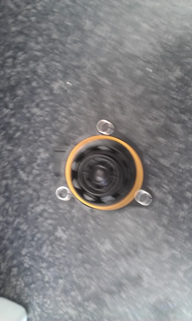

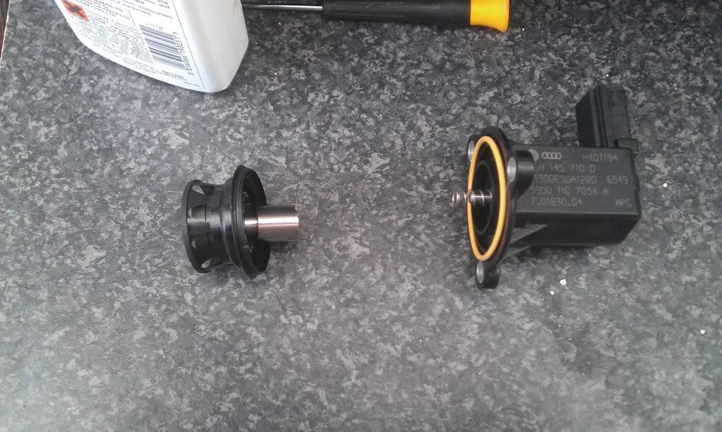

It looked ok but when i took it out it came in two pieces .
now i am not sure if this is how it came, i dont think so, so i am thinking maybe the noise is because of this faulty part and when i am on WOT it is letting air seep through...,...
Does that sound mental or could it be something else??:confused::confused:
Thanks for your help
Chris

My rev d valve is busted.
I spoke Jo Dave at sere and they have a very low failure rate but I must be unlucky.
However Dave has got me one £47 so not the end of the world.
The broken one is less than a year old so still under warranty but I don't think its word I. Ie battle to get it replaced.
