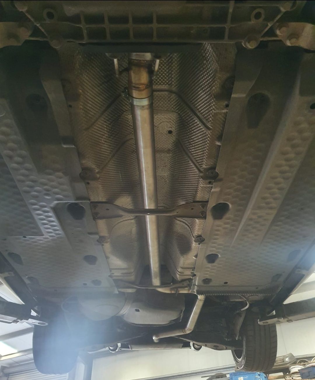

There is my straight through turbo back 2.5 inch exhaust to a gutted out backbox.
Sounds great
