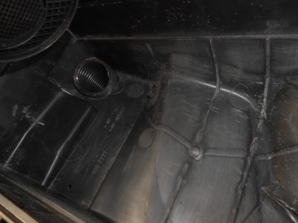

Ok here's what I did instead -
Got a length of hoover pipe, 40mm.
Drilled hole in box. I left the original feed pipe, don't wan't to got cutting stuff out etc.
I inserted the hoover pipe

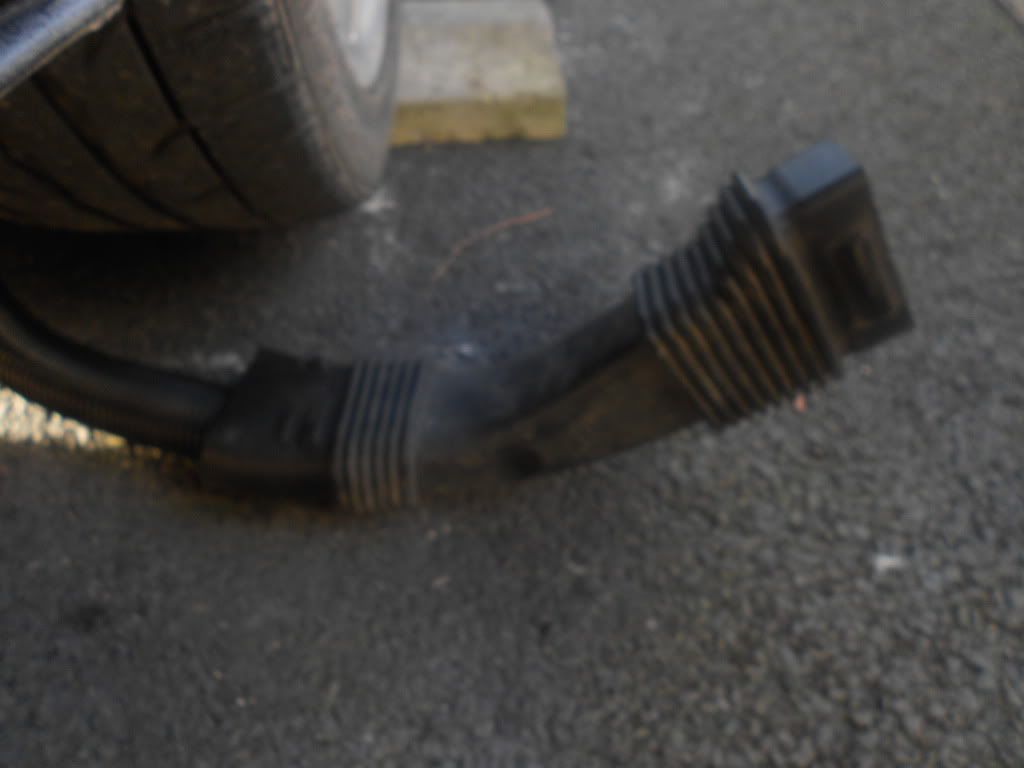

I then went to the front of the car, pulled out the air feed coming from the lower passengers side bumper (there's a scoop here that a pipe attaches to and simply runs air into the engine bay).
I put my hoover pipe into this pipe and did the necessary things to attach it.
Here's a pic of it sitting in the the pipe that attaches to the scoop before I cut and reshaped it to suit the new pipe:
So now what I have is a system that will ram air into the box. So I went out and tested it. Today was very cold, but really clean crisp air around. The turbo was definitely livelier, without a doubt, and it felt it pulled a bit better.
These are the things I want to do before mapping her.
Another simple, cheap and effective mod!
Happy out - cost me 12 bob (just the pipe)
