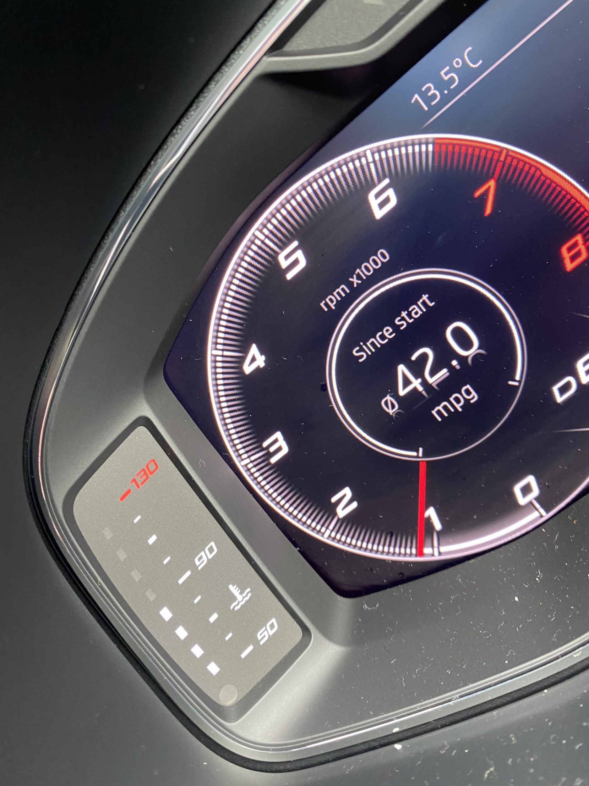

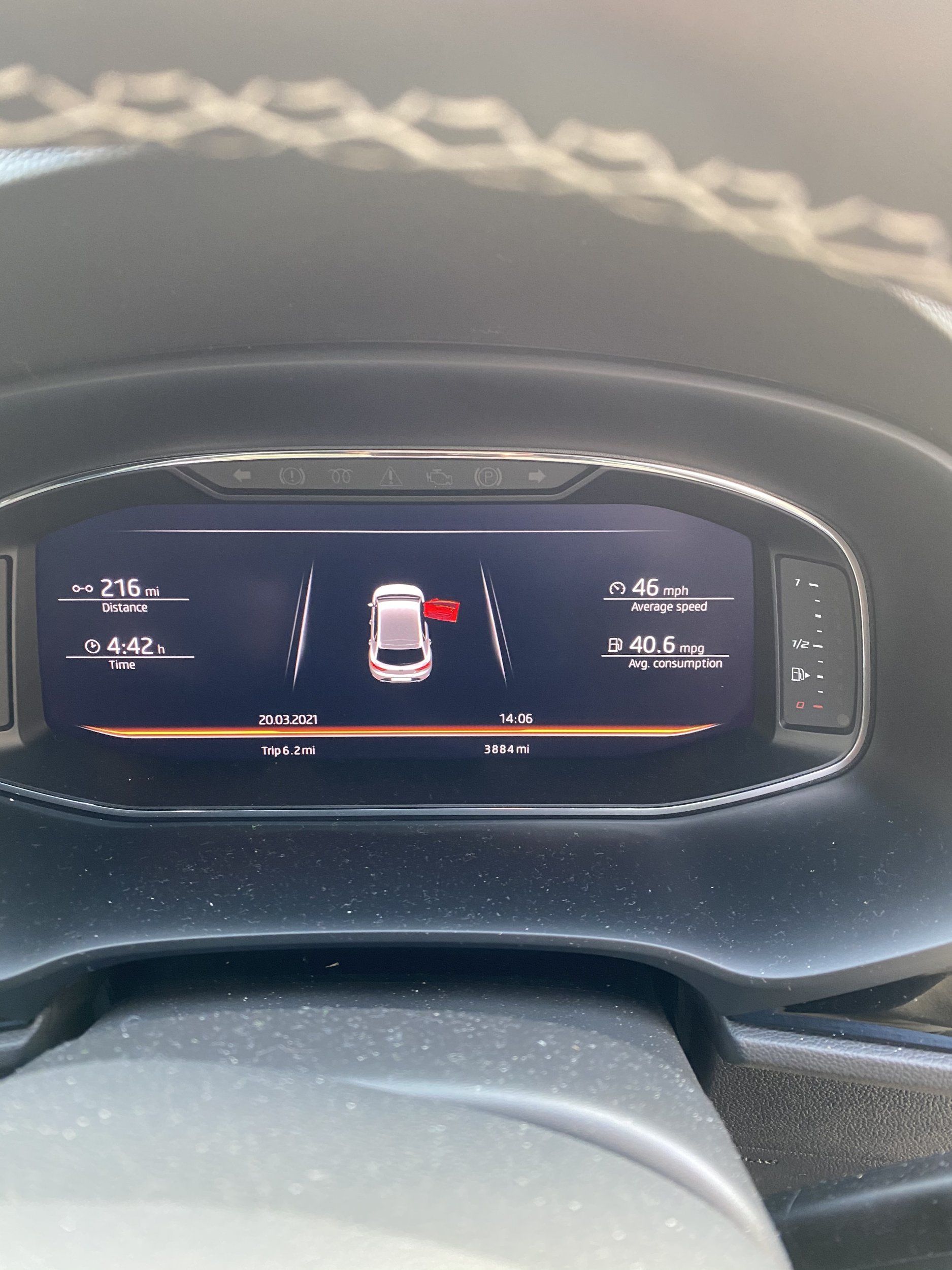

Did a 216 mile round trip in mine on Saturday Driffield (near hull) to Nottingham and back
Highest seen was 42mpg average on motorway , after the A-roads home averaged 40.6 mpg.
I 1000% didn’t get the car for fuel economy but was doing my dad a favour and he was covering the fuel so wanted to drive it as efficient as I could.
(2020 Cupra 290 gpf, 7speed dsg)
