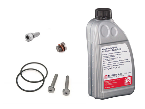

This is annother place to buy the parts, but no mention of learn?
