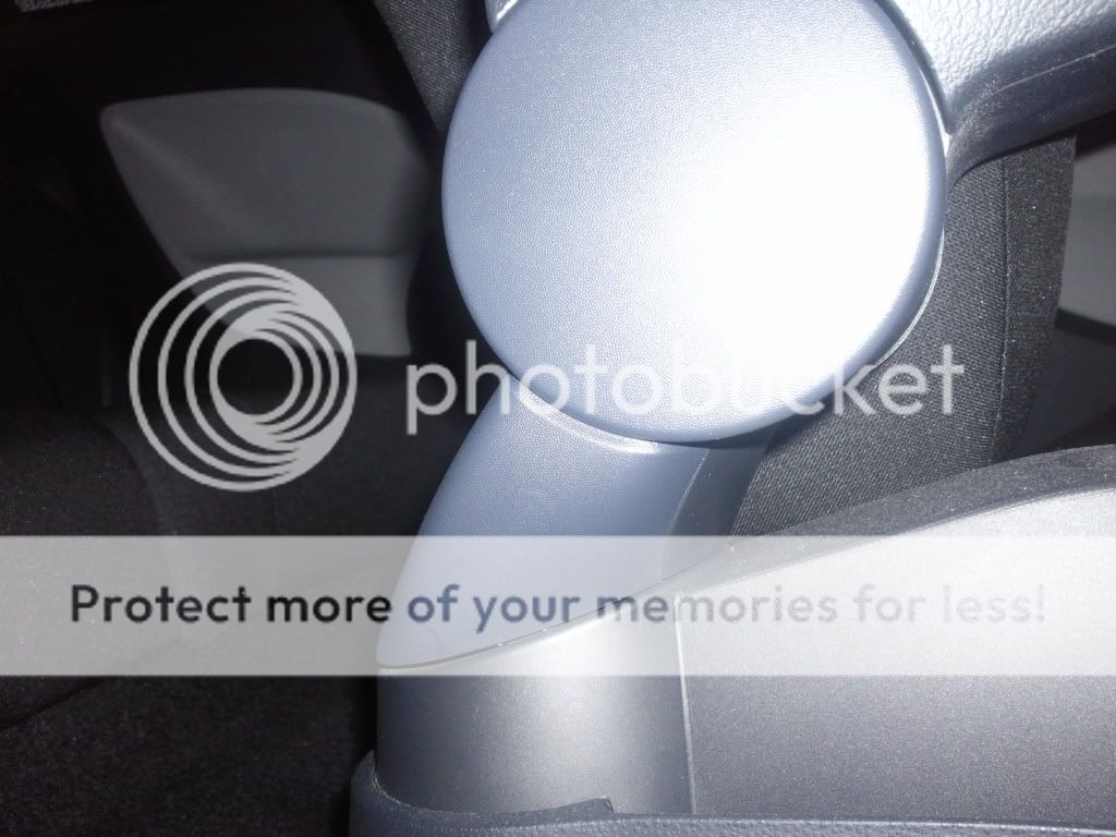

Posted these pics so many times now.
This is mine, I didn't fit it. Came as part of a sports pack you could get back in 2010.
