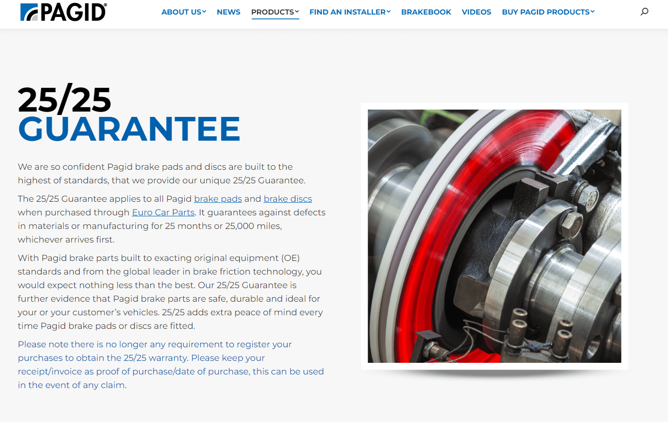

Steve J
May 26, 2019
134
27
They are - but that's still cheaper than ECP!!
Return them for a full refund - using a sub standard shim is a manufacturing defect in my book.
Thanks for this, never knew about it. Just phoned ECP and under this scheme will be refunding me for the pads so I'll get the OEMs in once they arrive and take these back. Owe you a beer that got me back £63.
Now fingers crossed the OEMs solve this ghastly knocking sound.
