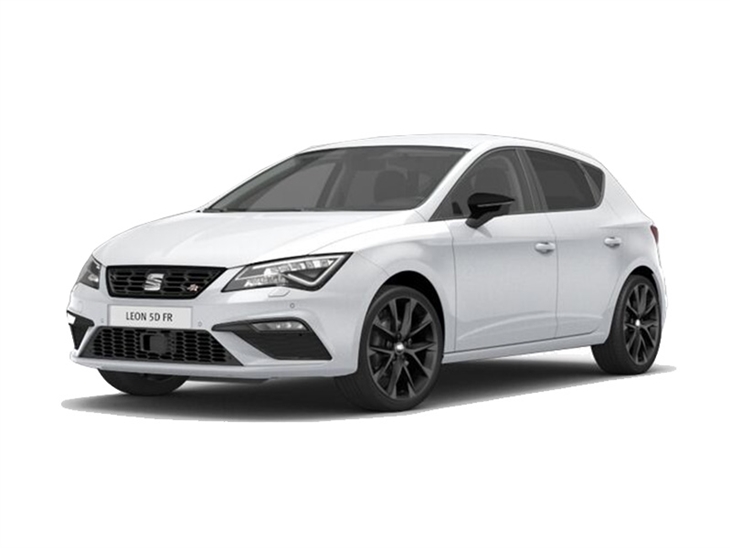

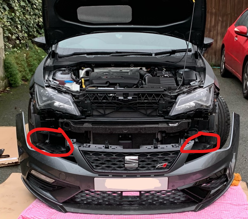

I am trying to establish what the actual differences between the standard bumper and the cupra bumper is. I am ordering some parts and I've seen in the brocure that the Cupra comes with "exclusive Cupra front Bumper". I dn't know what that means.
I have included two photos here for comparison. One of an FR and one of a Cupra. From what I can see, it looks like the only differences are the different grill pattern and the 5 holes above the number plate.
Could anyone that knows about this confirm that the dimensions for the rest of the bumper are the same? The images seem to show that the FR bottom lip is slightly wider than that on the Cupra but that may just be the angle of the picture.

Cupra bumper has holes above the plate, and different plastic grill design for all the grills .
However all the Cupra grills would fit the FR bumper, apart from the 5 holes above the number plate bit.

Worth noting that for the fog light grills, not only is the design different, they are not open on the FR. This is because behind he bumper itself, air is fed to the front of the Cupra's brakes. This isn't the case on the FR, which will have different arch liners too.

Won't affect your brakes, you may lose a 0.5mpg due to added drag. I have to admit I didn't look to closely at how the ducting worked when I had the bumper off. But if you put the wheels on full lock on a Cupra you can see a little slot where the air is fed through.

You can't see in the picture but in the sections below the fog light sectioned off area, has filters, basically stop crap getting onto the discs.
