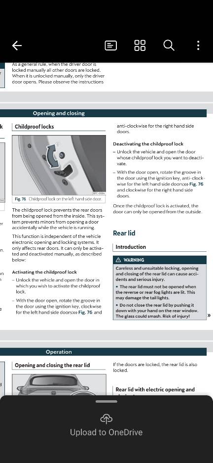

It's in the manual
Sent from my Pixel 5 using Tapatalk

Open the rear door and you will see two holes. One has the baby logo above it. U can put your key in and turn it. (Eject key from your remote). Not sure what the outer one does. Maybe window lock too?
