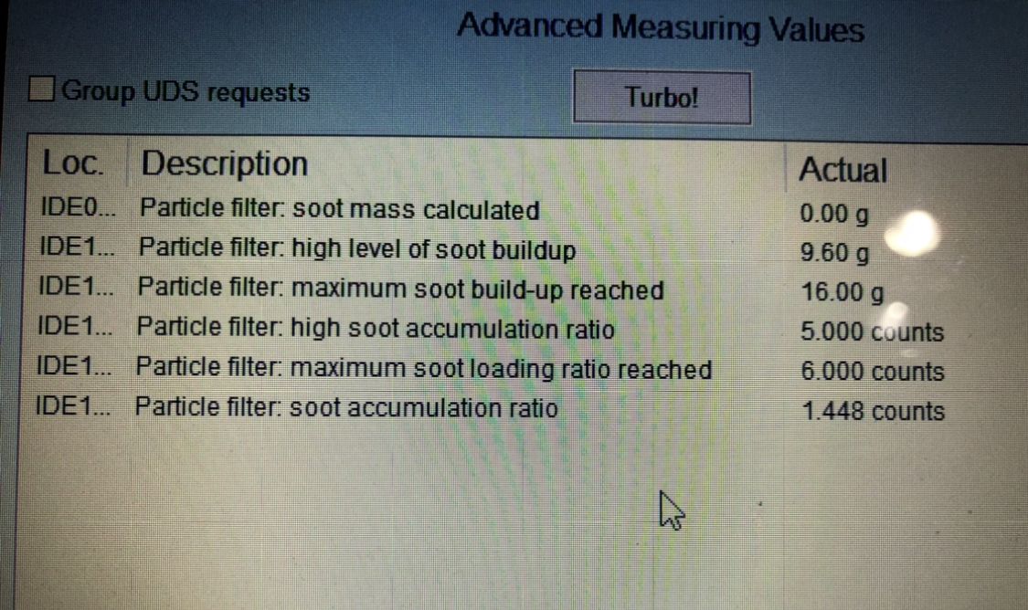

Any idea what the measuring blocks are for the 2.0 TFSI GPF/OPF?

It is not a dpf and not a diesel fuelled car!!! It is the gasoline/petrol equivalent only fitted from 2018 onwards.
The dealer technicians and I couldn’t clear the fault originally using the instructions in the 2018 manual (2000+ rpm, gearbox in sport, 37+ mph for 15 mins). It did work using the amended instruction that I posted above.
Also, by the very nature of the emissions codes the DTCs can’t just be erased. I expect that the coding can be modified so that the warnings do not show or are recorded though.
Also, according to the various literature/forums it only uses a passive regen and not an active (forced regen like the diesel). As you can see calculated soot levels are now zero too.
