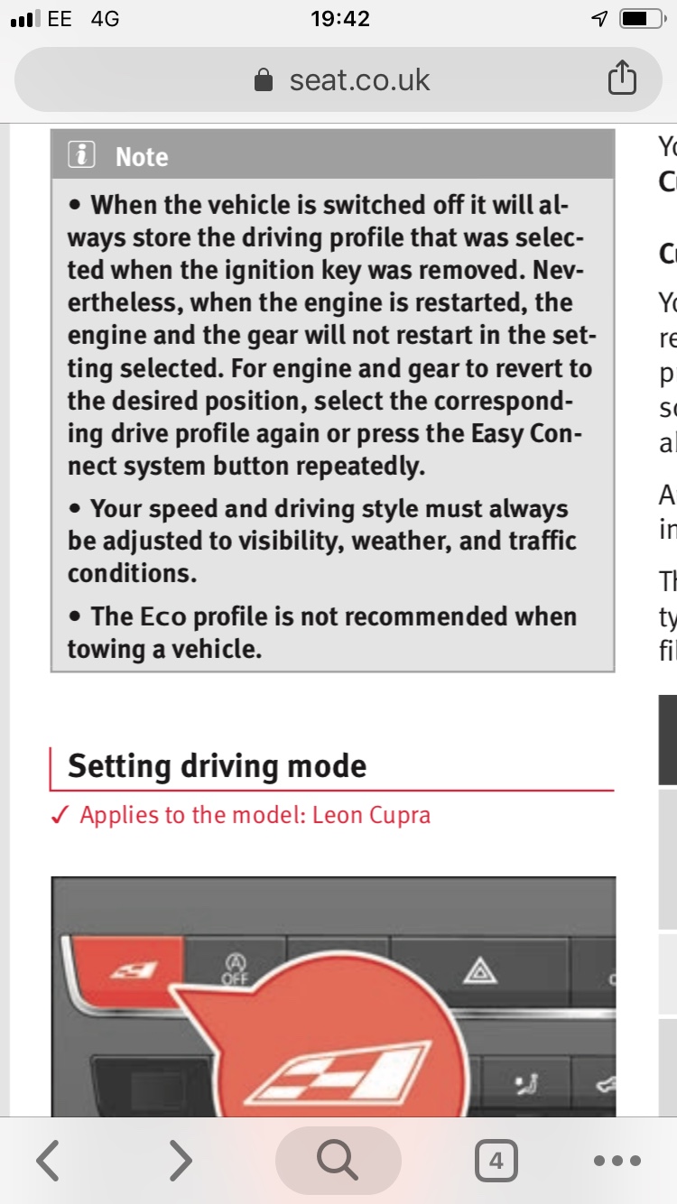

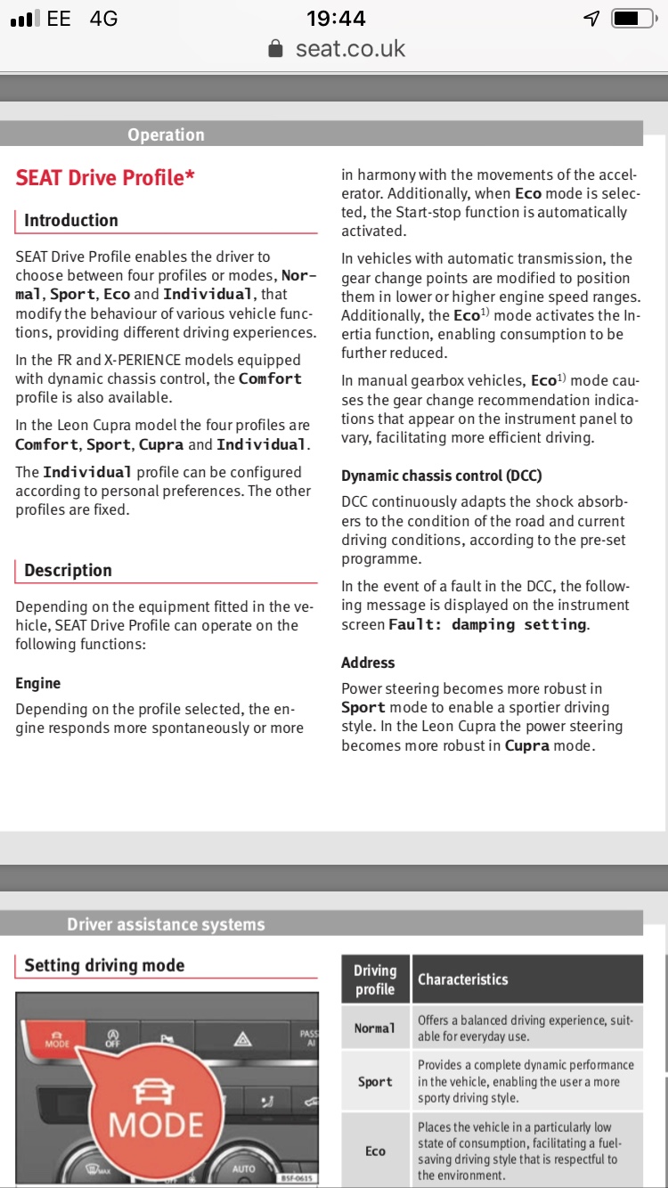

I know it’s all been covered but i thought I’d attach from the official manual.
P.S. Heads up for any of those who thought about setting eco on the manual gearbox ..
Reactions: LouG and LR231998

Very helpful never noticed it said that. Anyway to keep the engine mode as selected? Such as carista/ coding? Bit annoying!?

No, no doubt the car will need to do things to protect itself, so start up will be programmed for normal mode only. Better to to run when cold too. I don’t use cupra//sport till oil temps are at least above 80. In fact Revo software doesn’t give you full power till 70.

Don't see how starting in Cupra would effect anything, it's not like it gives you anymore power or anything, it's only throttle response that changes, I understand the revo restriction as the engine is producing more power whereas is sport cupra you get no more power/boost
