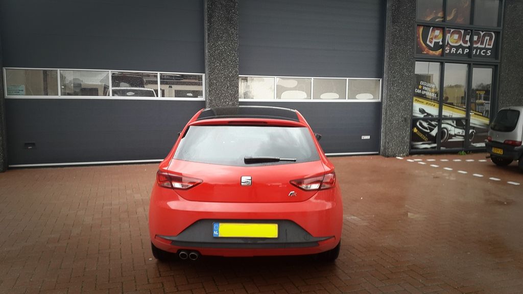

There is a difference between the 3 doors and 5 doors. I also have been looking to a cupra spoiler but realise your third braking light will have to replaced as well. Because at a cupra it's in the spoiler instead of the tailgate. That's why I am looking for the aerodynimic one. Has anyone ordered this spoiler?:
http://www.ebay.co.uk/itm/SEAT-LEON...l:Leon&hash=item1c61106d32:g:PFkAAOSwL7VWtisG
It's a reproduction of the aerodynamic spoiler and it costs only a third of the OEM spoiler (5F0071606B) in Holland they are €300,-.
