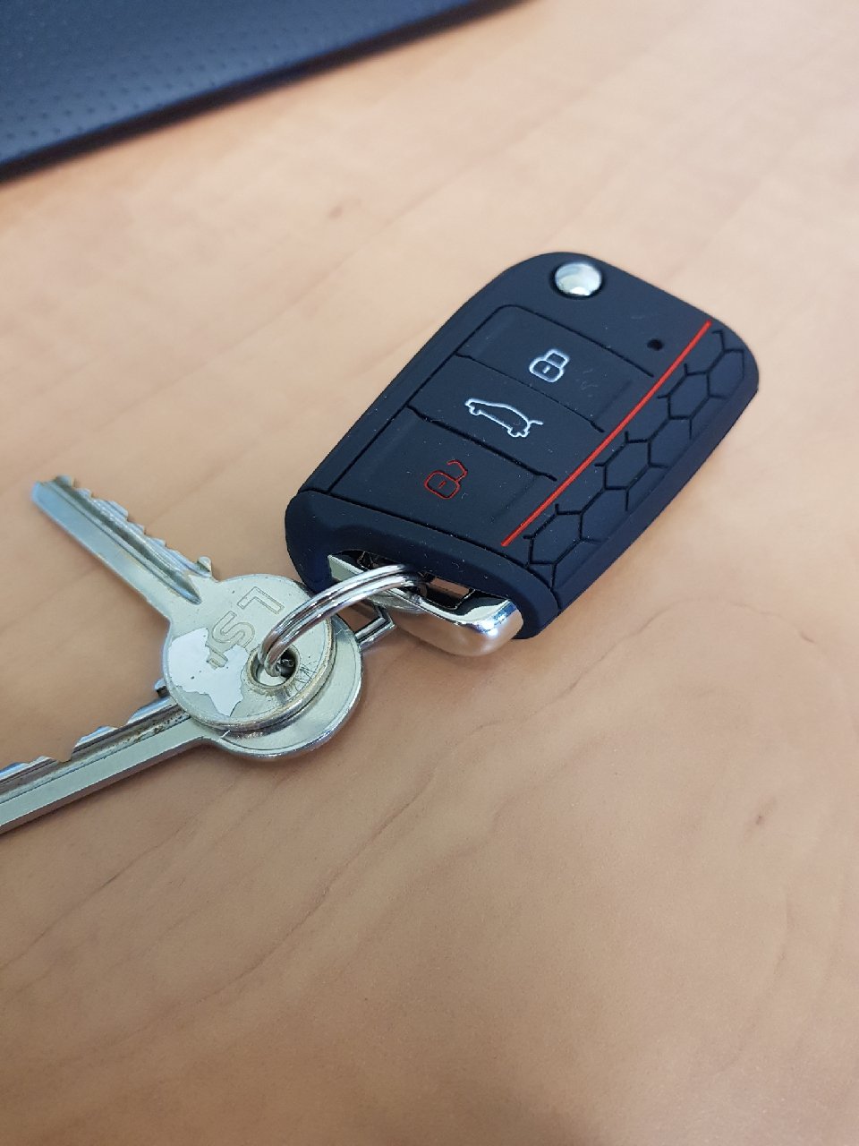

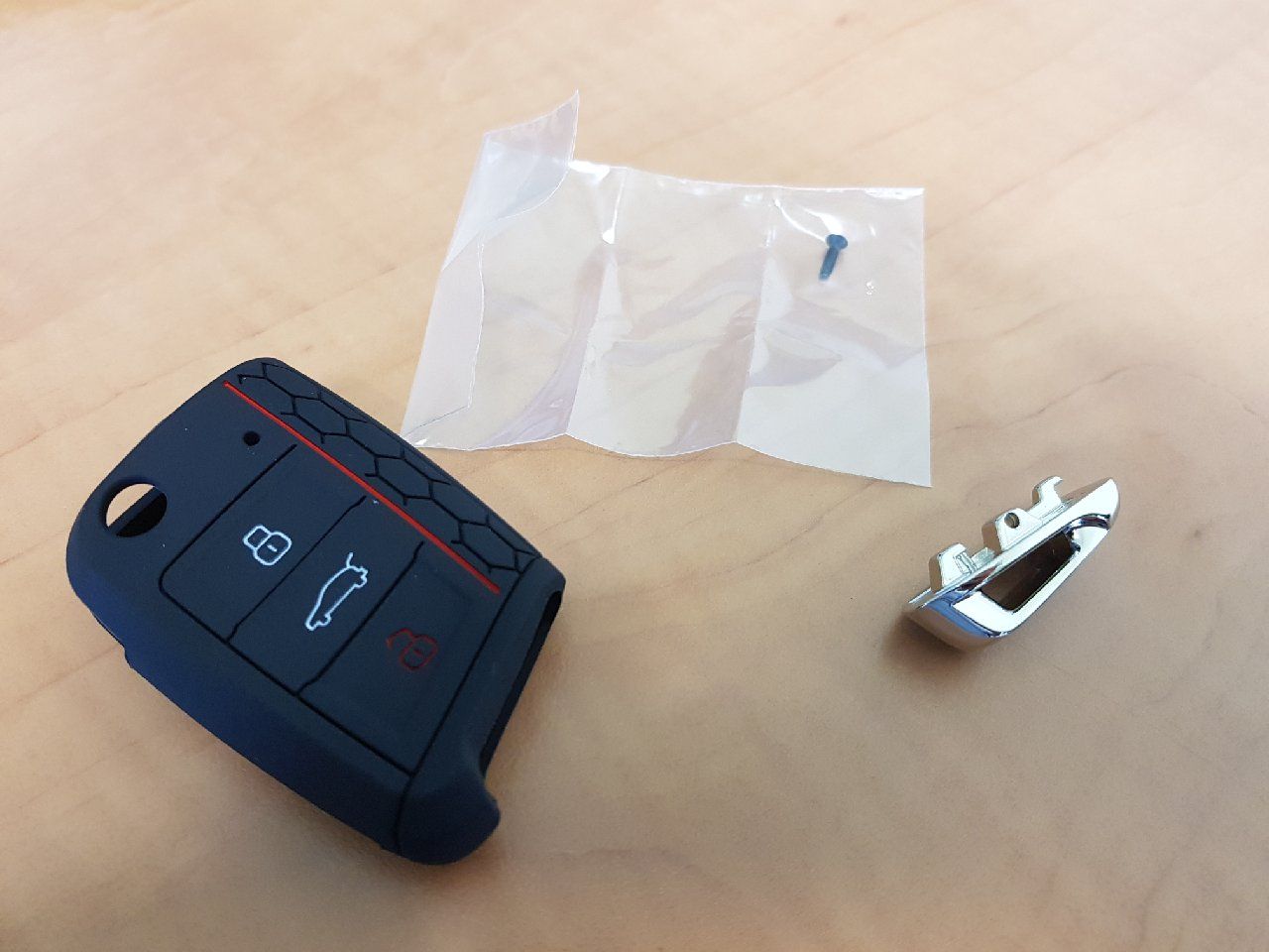

Key mod
Not 100% sure about the rubber thing yet TBH - will leave as is and report back! The metal end cap is nice though.

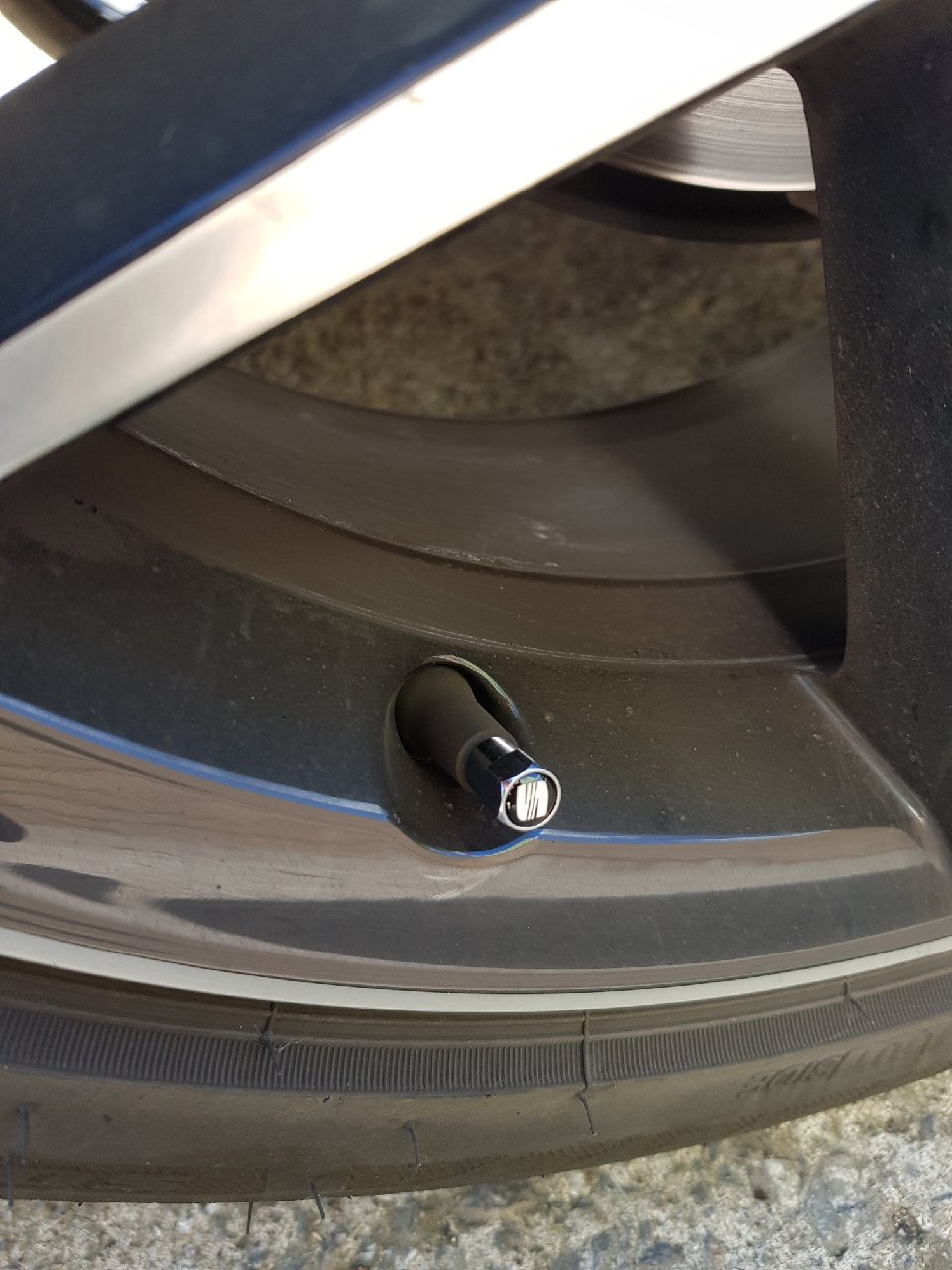

Next up some Seat branded dust caps - just coz!

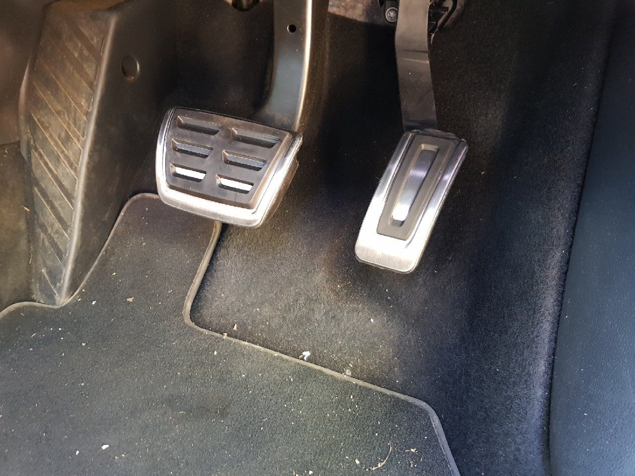

Then some pedal covers - totally transforms the footwell in my opinion! Best tenner I've spent in a while!

That should fit my Leon right
Yep, I would have thought so - the brake pedal is a replacement for the rubber that's there already and the accelerator is a over cover which is a bit fiddly to fit, but nice & snug once you've broken all your nails fitting it!

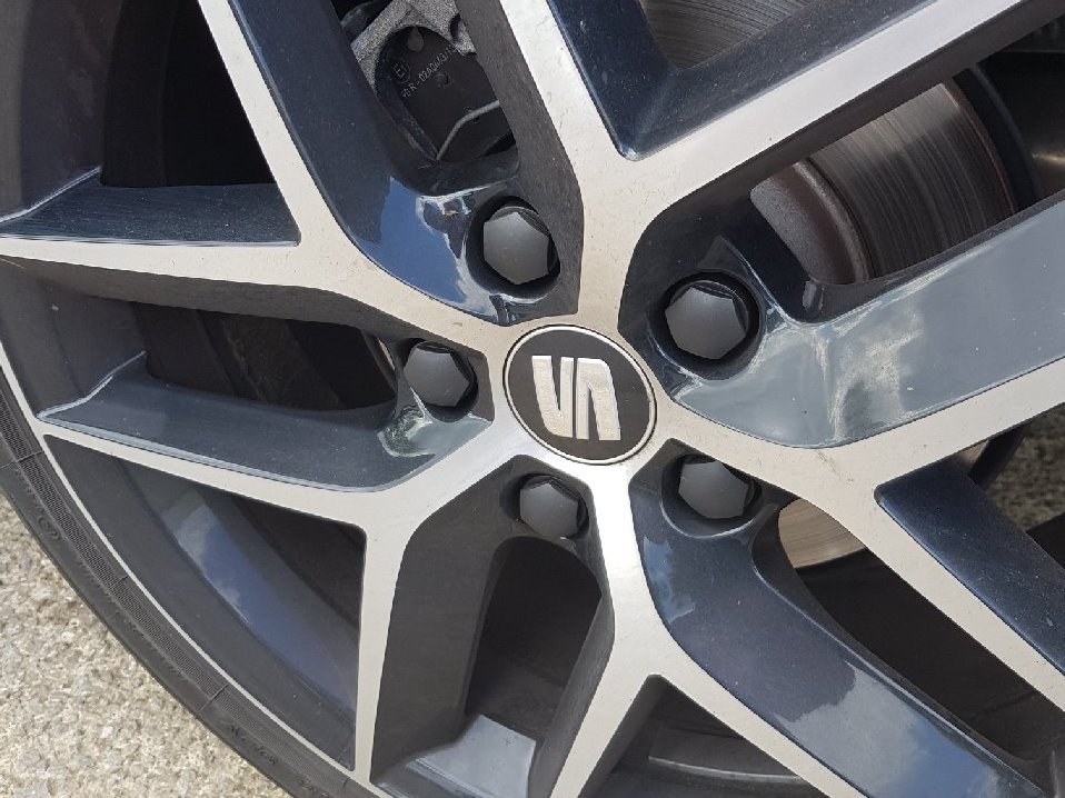

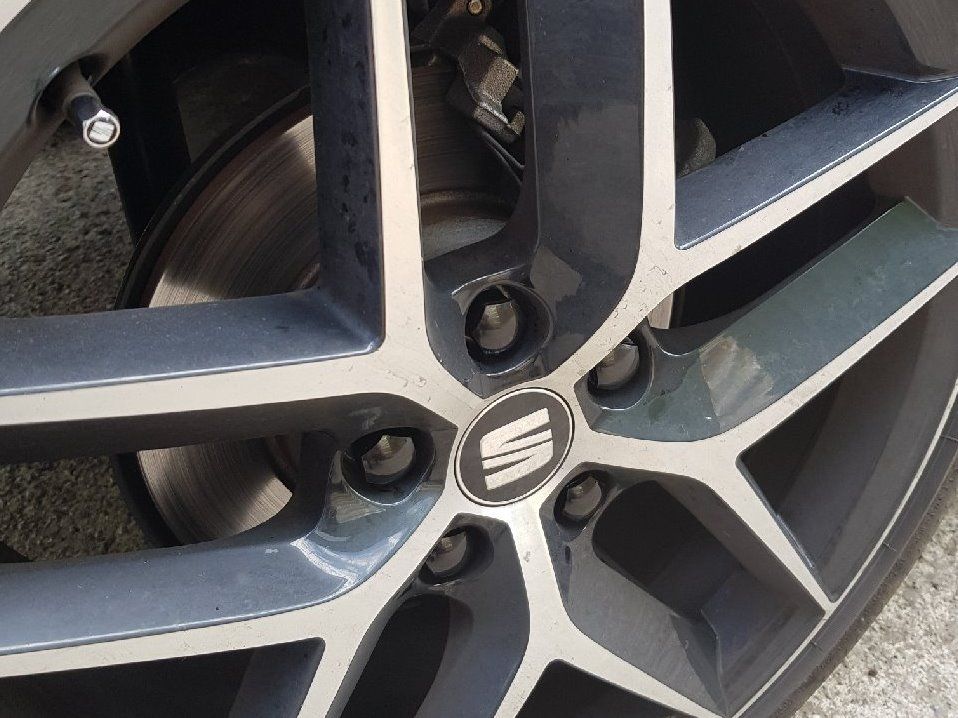

Just popped some new wheel nut covers on as there were 2 missing when I collected the car. Not a deal breaker but just a Grrrrrrr moment!
OLD (matt grey)
NEW (gloss black)
Quite like the gloss black as it matches other gloss black bits on the car, but you can tell they're a cheapo eBay copy when you take the remaining OEM ones off!!
Did you find the footrest cover for the dsg too or just the two pedals?
Just done the 2 pedals - haven't looked for the footrest cover TBH. I thought it would be too 'in your face' with that huge thing chromed!!!

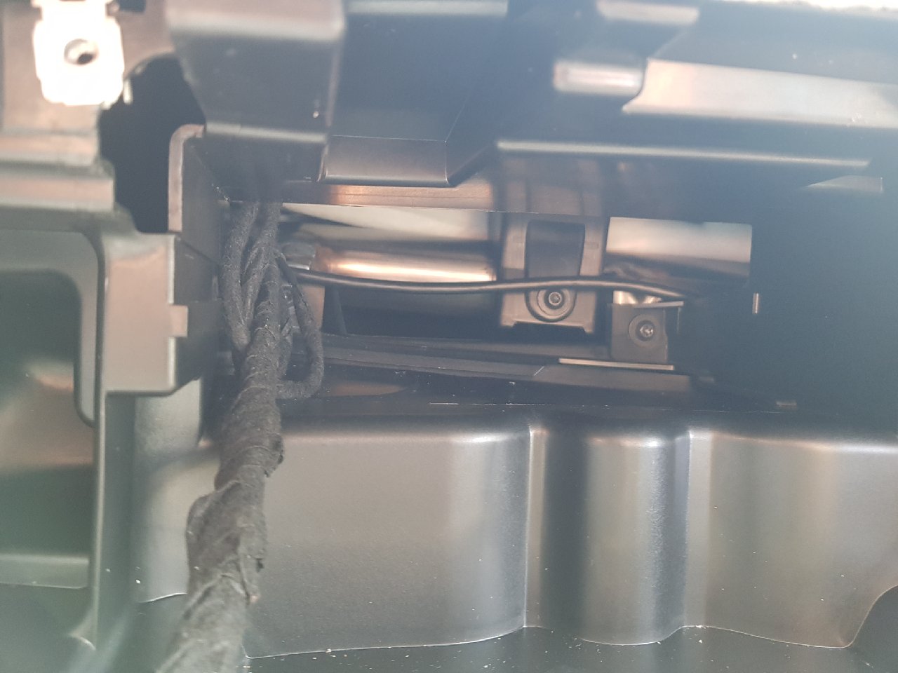

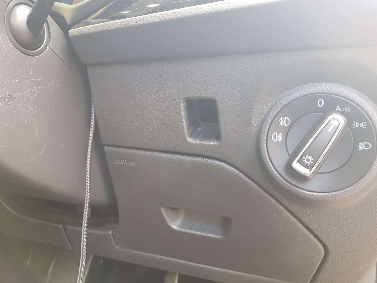

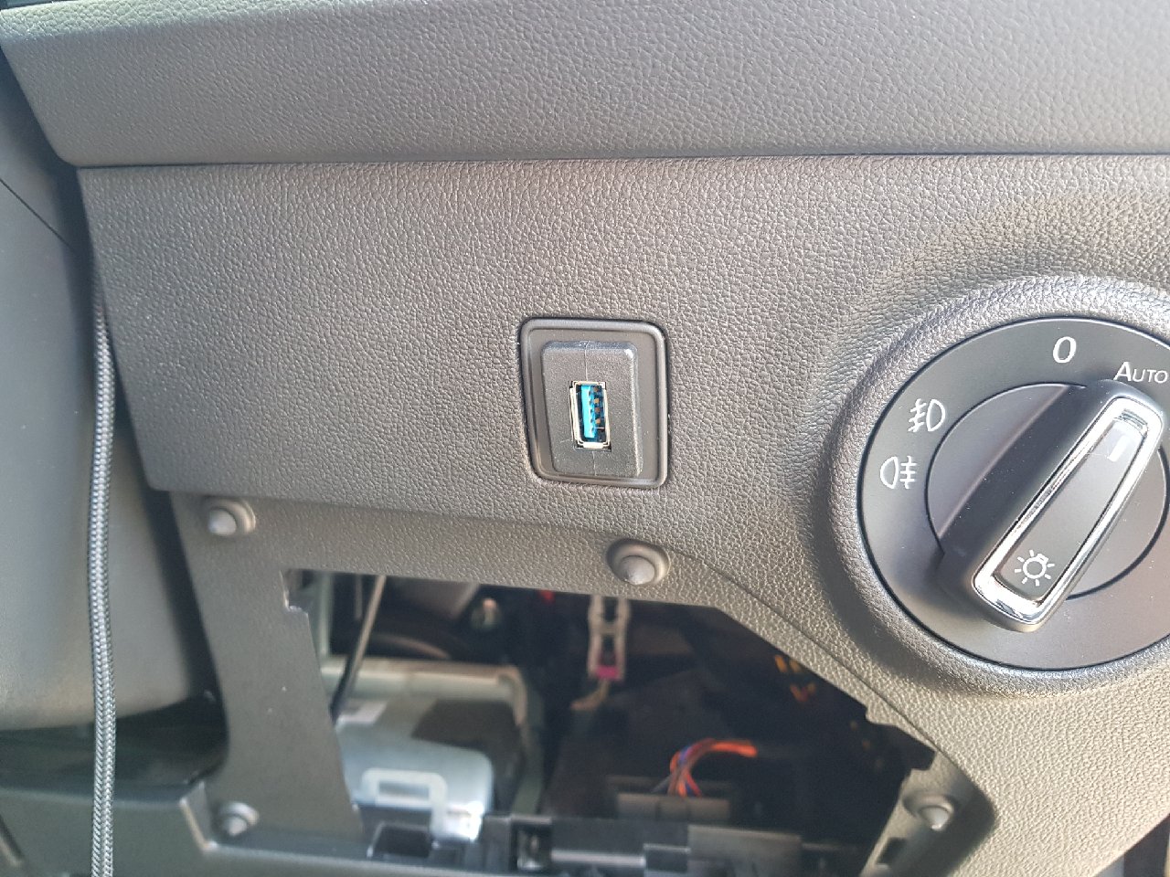

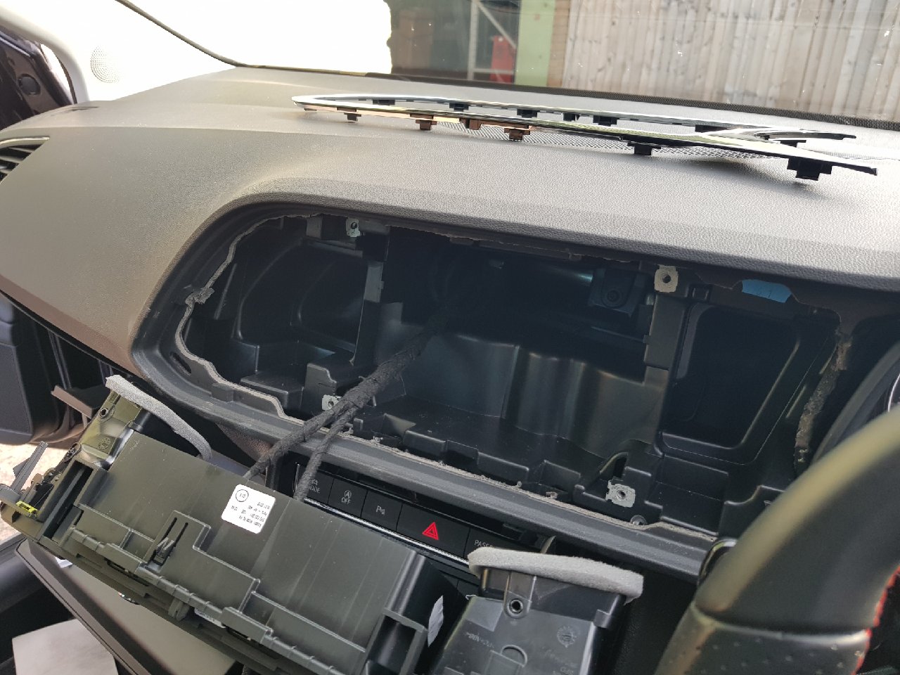

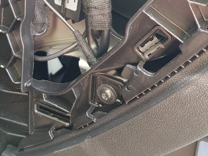

Dashcam & USB port install day!
First up, pop the blank plug:-
Then out with the centre console screen (not a job for the faint-hearted!)

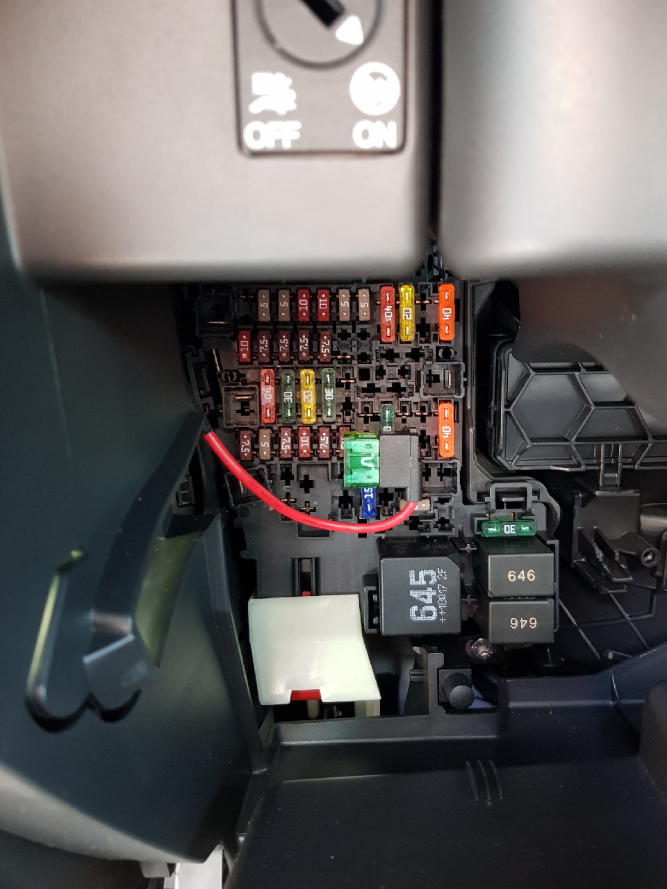

Then piggy-backed off the fuse:-

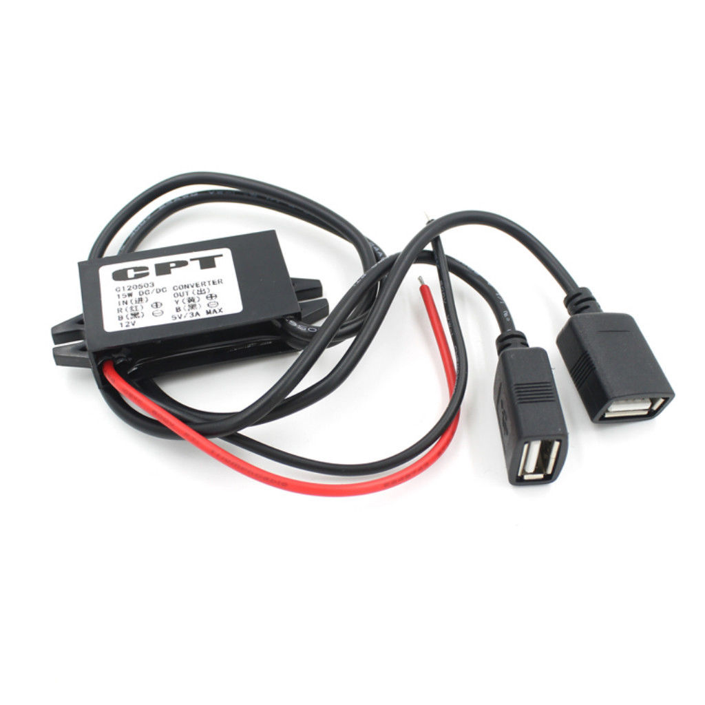

Then connected this to fuse piggyback:-

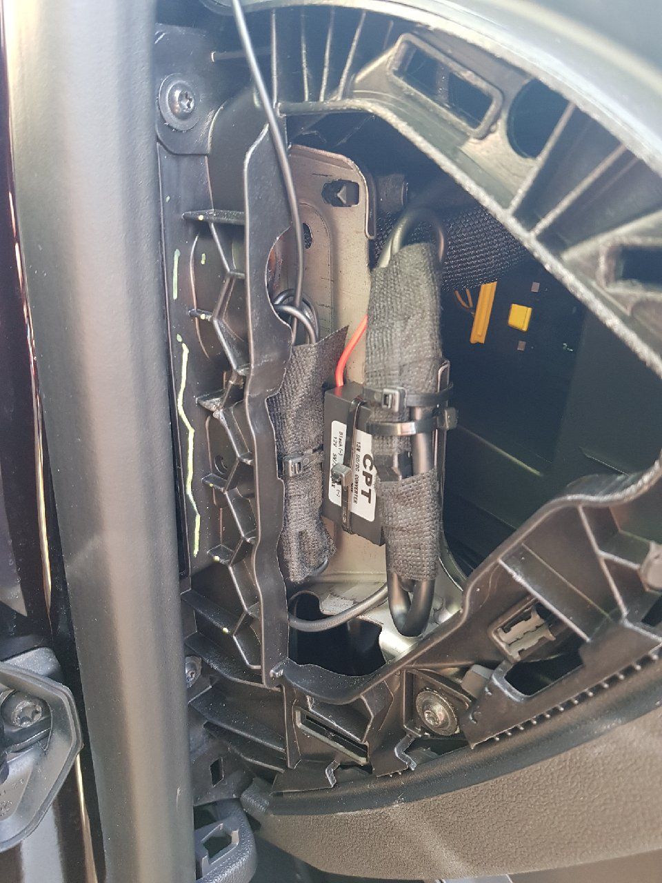

Wrapped in cloth tape and zip-tied to a handy bit of metal:-

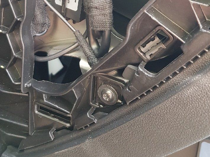

Then put a fork terminal on the ground, undid the Torx screw visible in the bottom of the above picture and terminated it between the plastic trim and metal frame (cloth tape again!):-

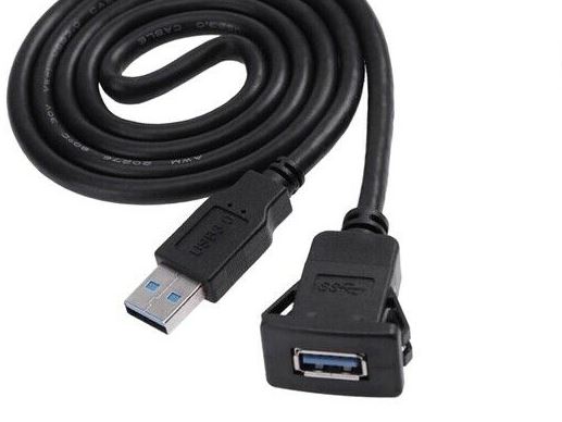

Then ran the cable for the USB charging port (just visible behind the console screen):-
Then cut a square hole in the blank plug and inserted this:-
Which ended up looking like this once inserted:-
Then back together time!!
And now I've run out of space in this post to put up more images!

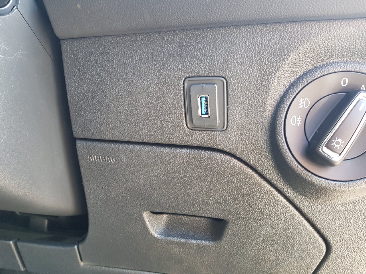

z1ts
Leon FR ST 1.4 Tsi DSG
Sep 4, 2018
105
47
Bristol
I ran the cable for the Dashcam up behind the pillar cover on the passenger's side and under the headlining, then mounted the camera behind the centre mirror totally out of sight from the driving position!
So far so good
I wanted an OEM look to my USB charging point (for my phone which is on a screen mount to the right of the steering wheel) and I'm pretty happy that I have achieved that.
I also hate trailing leads everywhere so a 'fitted' dashcam was an absolute must for me, as was the need to rid the USB cable that sued to trail from the port by the aux-in over the top of the steering wheel to my phone.
So all good!

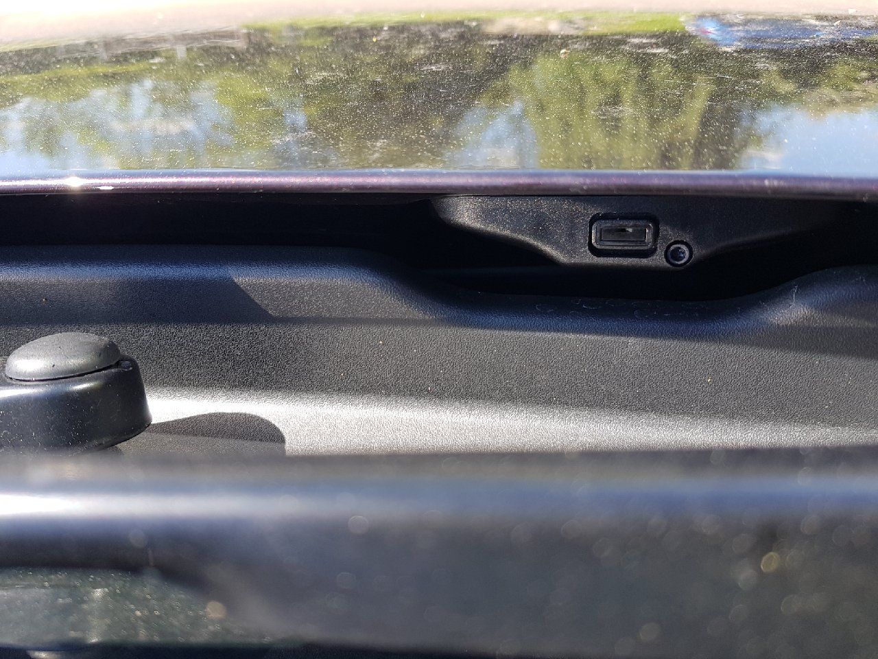

Just ordered one of these:-
With a stroke of luck I've got it around the right way for the right angle!!!
