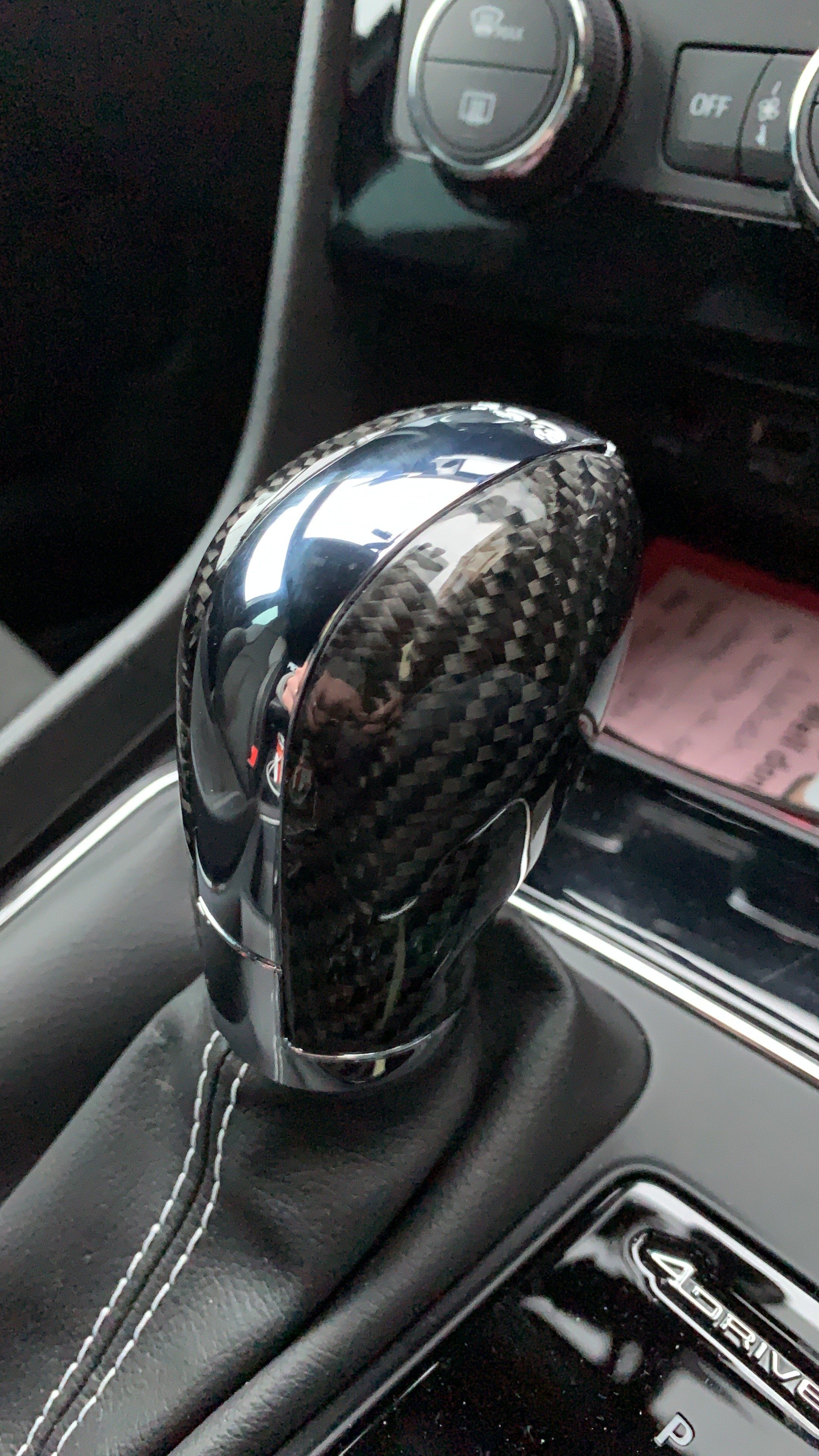

So long as you don't want to change the collar and button, you can change the sides and top piece with a trim removal tool.
On my carbon, the gear knob was a mish mash of black, leather and chrome. So changed it to chrome and Carbon Fibre. I'd of preferred Black and Carbon, but as the collar and button where chrome, i changed the black trim to chrome...
This is the picture before I also swapped the Black central trim to a chrome one:

Hey Damo, This is exactly what I'm after. Did you get the parts from the bay? I have tried prising the sides off in the past out of curiosity but they seem rock solid.
I got them from AliExpress.
There is a video on you tube on how to do it. So long as you price it from the right areas you should be okay. Defo from the top first. Once you have the leather sides off, you can see how to remove the top section.
I'll see if I can find the video.

Here you go. I've put the URL so you don;t have to watch the rubbish at the start, jut the rubbish in the middle lol
I wouldn't recommend doing it with a spoon while trying to make a video for YouTube lol

Awesome cheers Damo, Parts have been ordered. :thumbup:

I'm very late to this, bit for anyone searching in future - I ordered a DSG knob from eBay advertised as for
"Passat CC , Jetta, Golf 6 /GTI MK6".
It was compatible. The insides looked a bit plasticky, so I ditched those, prised off the sides and centre piece (with a guitar pick) and put them on my mk3 Leon. Replaced my old knob which looked like it had been chewed by a dog.
