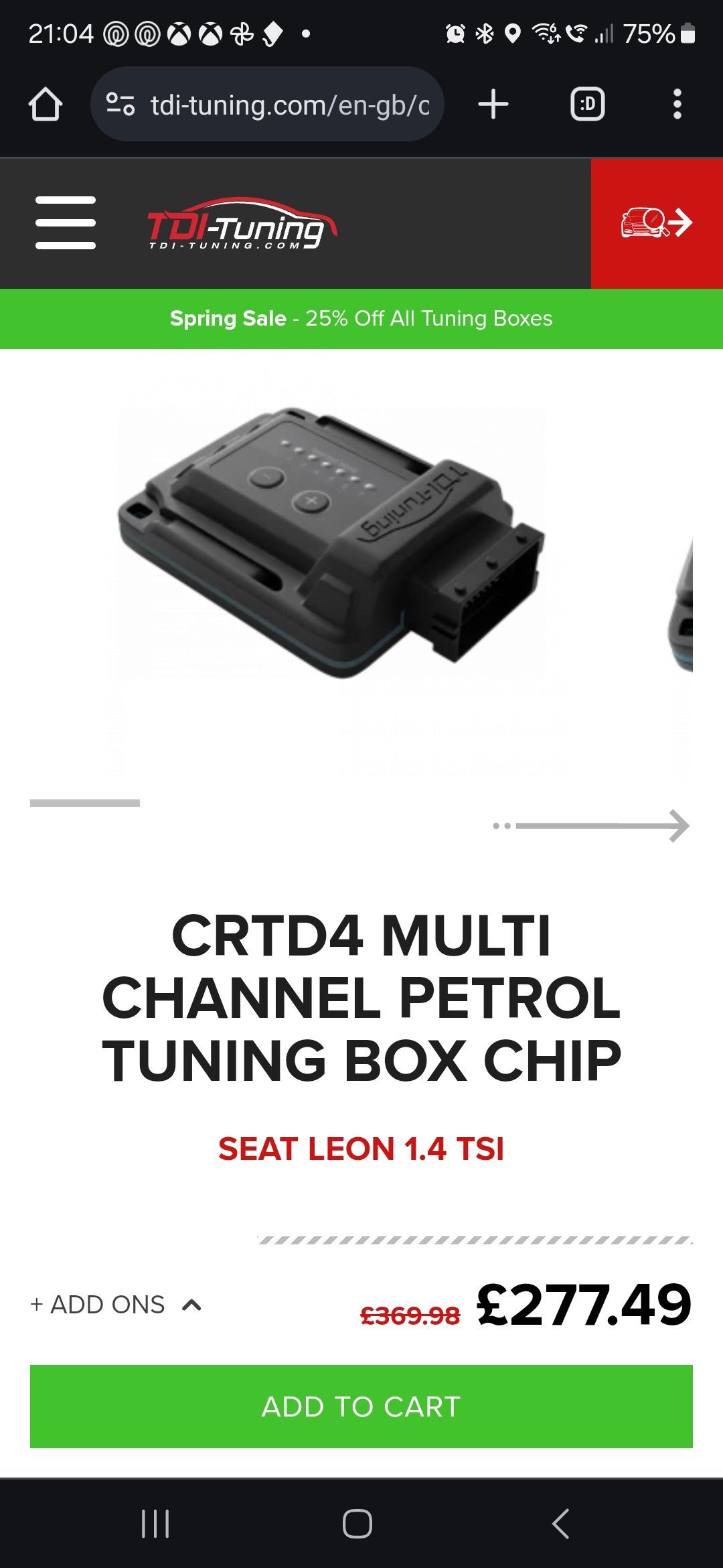

Has any used a tuning box on they ehybrid? I'm unable to see any companies that offer a remap on the leon but plenty do on the golf gte.
Look.to be some good results on some boxes
Didn't think tuning was possible for the hybrid, are these gains just from the Petrol engine?
As far as I know the cupra leon hybrid (245hp) and the Golf ehybrid (245Hp) are same electric engine and same petrol engine, just different software. so it should be possible to, at least, remap it to that.
I think in other post the commented our gearboxes are already close to the max torque they can handle, so that is something to be careful with as a tunning box wouldn´t take into account the gearbox.
Yes this is just the engine side, whilst I've got used car warranty I'm happy look at these
