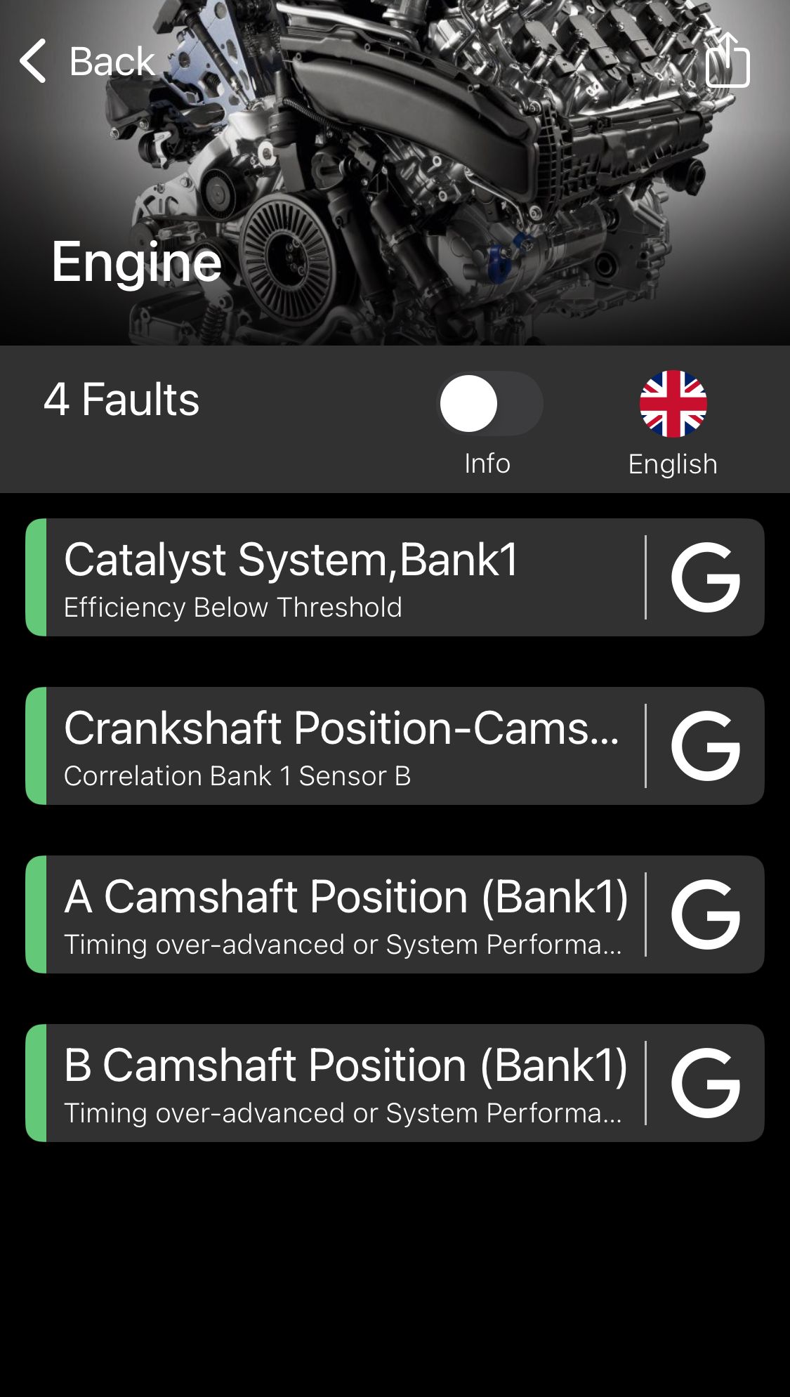

Hi guys, any ideas about this? Leon Cupra 280 DSG, on just over 120,000 miles. These are the error codes. Has been happening for a while now. 6 months after an oil change, car asks for 1L of oil every month or so. When the cars idling, it’ll rough idle sometimes, and revs will fluctuate and engine will judder, but only intermittently. Getting low to mid 20mpg with normal driving. No other symptoms. I’ve got a res delete, no other mods. Changed the PCV valve and PCV hose recently. Had a compression test last year. All compression is within spec, but at the lower end of the range. Ideas?

Check if all the connectors are seated correctly on all those thingies just behind the coil packs. You might check the magnetic cam actuators on the left of the engine. I just replaced them preventatively with Febi units (about 30 euros each), easy job
The video shows only 1, but our engines have 2
