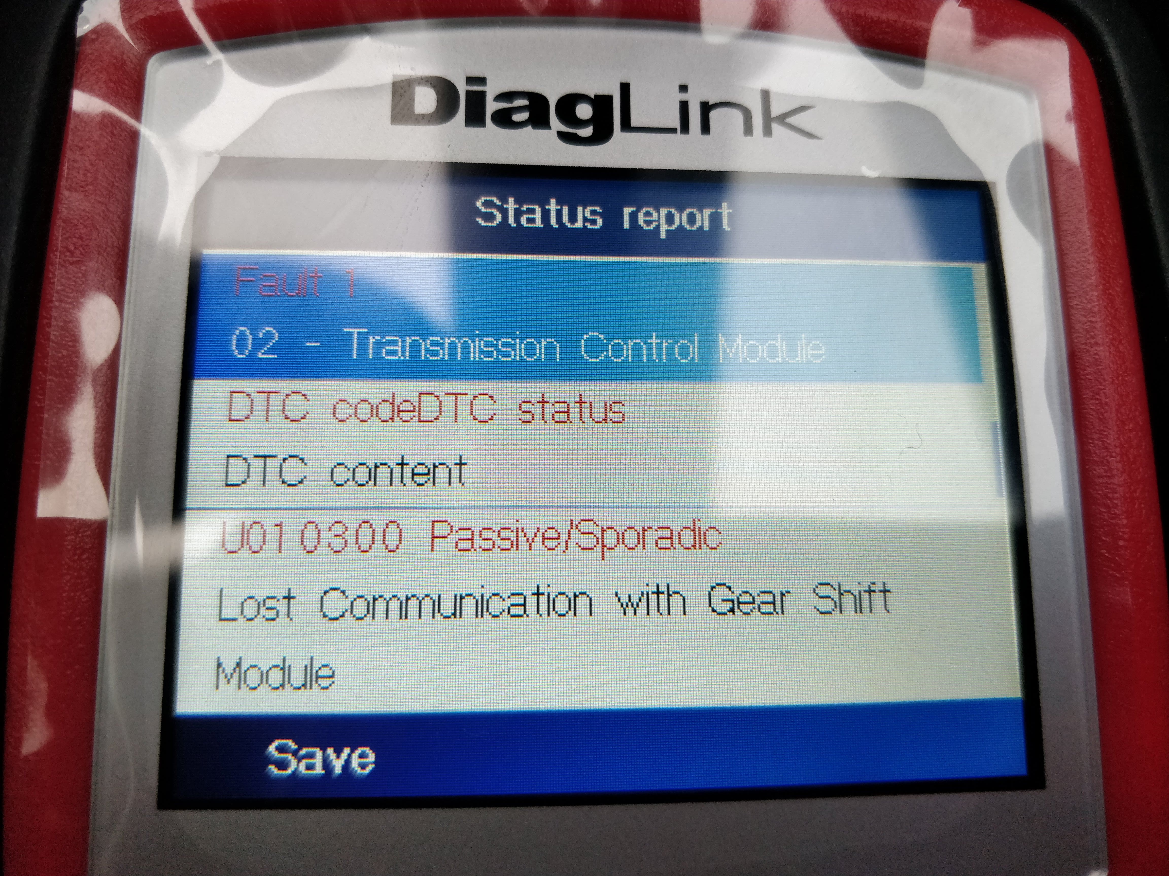

I do get transmission module error (attached image) occasionally which I clear them.
Any idea what is going on?

The communication error with gear shift are signs your gear shifter (the dsg stick in this case) is failing . It is a costly replacement but don't worry about it too much (from what I've been told) it's not something that will fail sporadically. Did you happen to have tuned your dsg by any chance?
