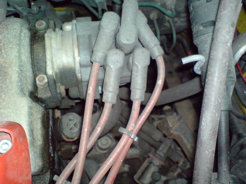

Can someone please take a close up pic of thier ignition leads from the plugs to the cap please as i've just changed mine and the car just goes cough cough bang??????
Just want to make sure ive got them in the right order.:confused:
You can see them labled in white. quite hard to read.
From left to right
1 2 3 4
bullit
not the same on a 8v, (cap is differant, dont work the same) firing order is 1-3-4-2, take the cap off, you should see a notch on the rim of the dizzy, with the cap back on, that notch is where cylinder number 1 fires, the next ( going clockwise) is 3, then 4, and 2, hope i explaned it ok

got a problem with the dizzy cap now grrrr!!!!! wont sit properly and under heavy acceleration it move about causing the arm to take big chunks out of the inside of the cap?? is there a particular position this needs to be at?
