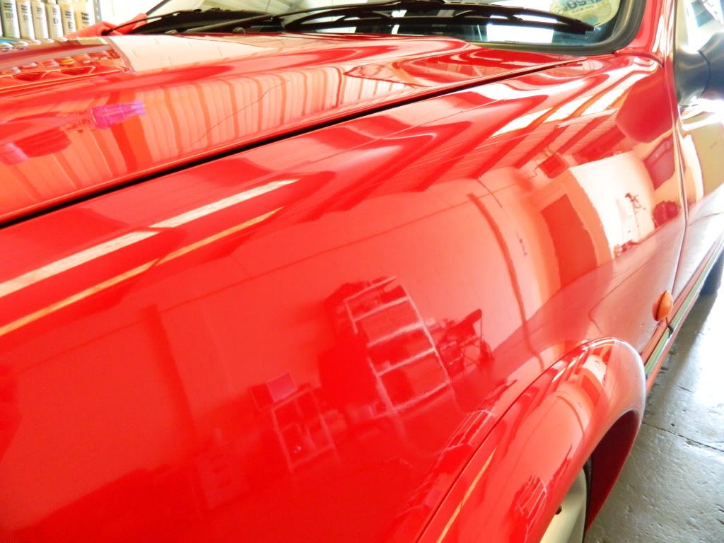

This is a Protection Detail on a Ford Fiesta RS Turbo getting ready for the summer shows and giving it a decent level of protection ready for the summer rain
I cleaned the wheels using the bilt hamber auto wheel cleaner and various wheel brushes, wheel wooleys and a noodle wash mitt
The car was then given its first coat of snow foam made up of the valet pro PH neutral snowfoam, the snowfoam was then blasted off with the pressure washer, and then the car was given another coat of the same mix snowfoam and whilst this was still on the car the car was washed using the 2 bucket method with grit guards in both buckets and a lambswool wash mitt.
The car was then rinsed off using a open ended hose and dryed using the woolly mammoth drying towel, before being brought inside the unit. The car wasn`t clayed as it was only done by the owner 3 week ago and was still nice a smooth lol
I then went round the car applying the Chemical Guys Glossworkz glaze by DA and a Lake county glazing pad and gave the car 2 coats of Chemical Guys Celeste Dettaglio
Whilst waiting to buff the second coat of wax the exhaust was cleaned up using Auto finesse Mercury metal polish, a product i`m really starting to love as gives a stunning finish.
Tyres where dressed with valet pro tyre dressing and alloys with Optiseal the arches dressed with Hyper dressing.
Then the car was then taken outside for some finished shots
