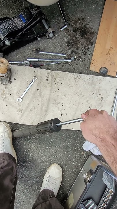

I ignore misting, no way I'd replace shocks because of it. They could work for years after a report of misting. The seals could tighten up and the misting stops. I've had misting on several MOTs, with different cars, and I've not replaced a shock yet. My daughters Toledo had a shopping list of advisories including misting. I didn't check the shocks but I knew the other advisories were absolute bullshit. I don't know why some MOT testers do that, but they do.
I 'ignored' my MOT misting advisories for three years - this is the result!
Looking back on old photos my car at the time was on about 110,000miles, and 8 years old.
Even with the dampers this bad the usual bounce test didn't show anything obvious!
There is a finite amount of oil in your dampers - if it is misting - it is leaking/escaping.
We obviously have no way to quantify the quantity which is leaking.
I just had my two rear shocks replaced, one had oil misting the other hardly any.
Both you could press down with your hands, not as bad as your video but they shouldn't move at all.
How many miles/what age car?
Yes, new ones are very stiff to push by hand.
