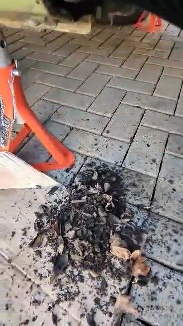

ELB
Nov 29, 2021
13
Scotland
Super late reply, but I just discovered the mud issue on my 09 Ibiza a couple of weeks ago. Had the car on jack stands changing the droplinks only to get bored and take off those two screws, and this is how much dirt came out! Definitely something to watch out for, as some of the earlier 6J models are getting to the age where rust can become an issue.
