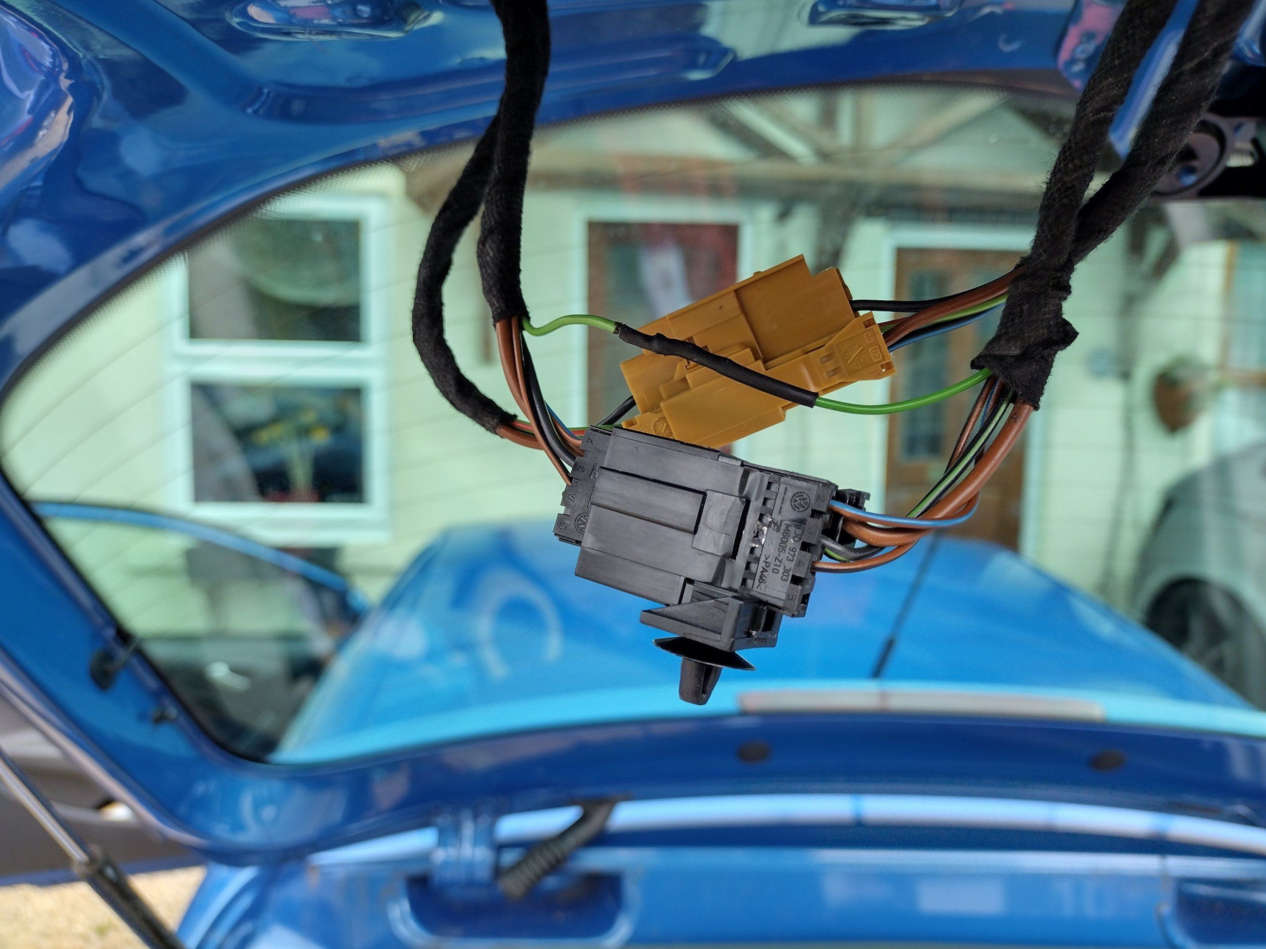

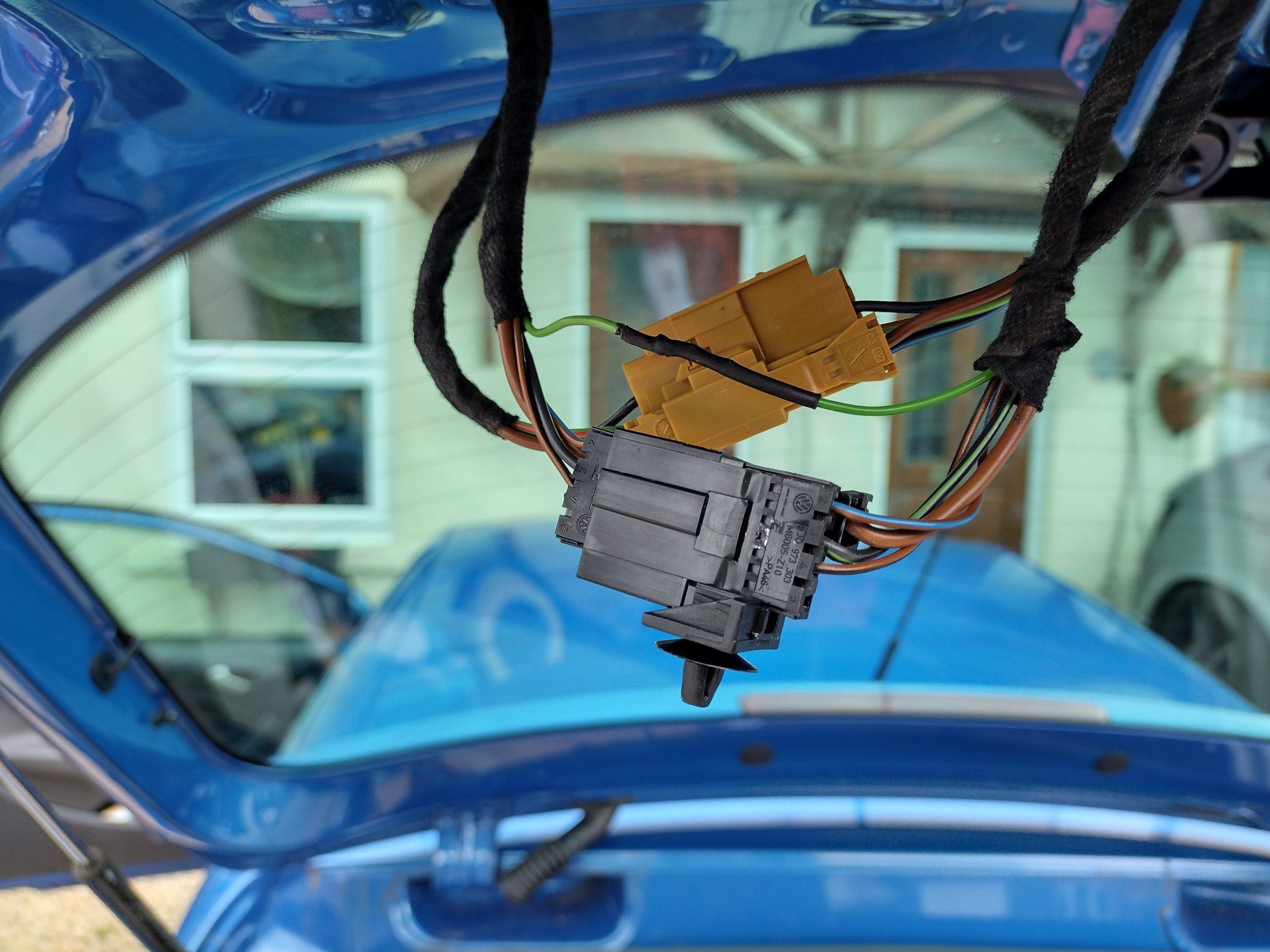

Just a quick note to say I've just had this exact issue with the same fix: the green wire wasn't broken, but I think the connection was oxidised just enough to make the connection intermittent, which explains why some people have success by pulling the connector apart and re-seating it.
A word from the wise: this green wire carries 5v whenever the ignition is on, I guess this is so the ECU can detect open circuit. This might well contribute to the oxidation if it gets damp, due to galvanic action. Operating the handle pushes this up to 12v to trigger the release.
Confusingly, a multimeter still showed 12v (or near 12v- as it is only a pulse, it's hard to tell with a digital meter) when operated, 5v when not, but this is because a meter is high impedance: under load, there's clearly not enough to operate the latch.
Anyway, pulling the connectors from the block, and a bit of solder and heatshrink (tricky on a windy day!) and it's all working. Now to return the latch release I bought from Amazon.
PS: yes, I'm aware of the arguments of solder vs crimps, and trust me, if I'd had some good quality heat-seal crimps and the tools to fit them properly, I'd have done that rather than muck about with a 15w soldering iron in the wind. I've made sure the connection is mechanically protected.

It was tricky, on a few counts. The small iron I had wasn't powerful enough, I had to tape a cardboard windshield to the tailgate! Access was a bit fiddly, too. I ended up taping one wire to the connector to hold it still. I really should get a bigger iron to use outdoors.
