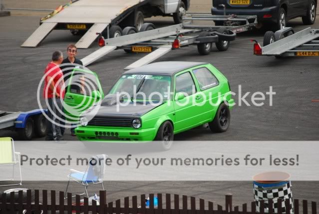

Saw this on Edition 38 forum. JNL built engine. GT40 turbo. Below has been written by JP at JNL:
'Just came back from a dyno with what we believe to be UK's highest hp figure for a 1.8t. It took Karl 3yrs and 4mnths before the car was even turnkey and our atrocious weather over winter meant it has taken this long to finally up the boost on his 1.8t. But it was well worth it when we hit 756.6hp [email protected] boost measured on a Dyno Dynamics. The only thing holding us back from pushing it further was that the injectors maxed out at 92% duty cycle (1200cc ones).

I was about to criticise the immense hike more than halfway up the rev range, but as I carried on reading I saw that was actually planned! It must just drive like a reasonably well tuned 1.8 until 4K, but anywhere after that and you'd best have your last will and testament sorted first...
I also got very confused when I saw it had done 12.5 seconds at Santa pod, and looked very much like an Ibiza....:doh:

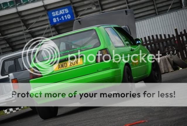

Shame it has the enormous bonnet lump and lairy colour otherwise it would be quite a sleeper. From the back there are no lairy pipes giving anything away (like the old Dubsport cars which had twin exits through the number plate panel).
Can't wait to see it in action.
