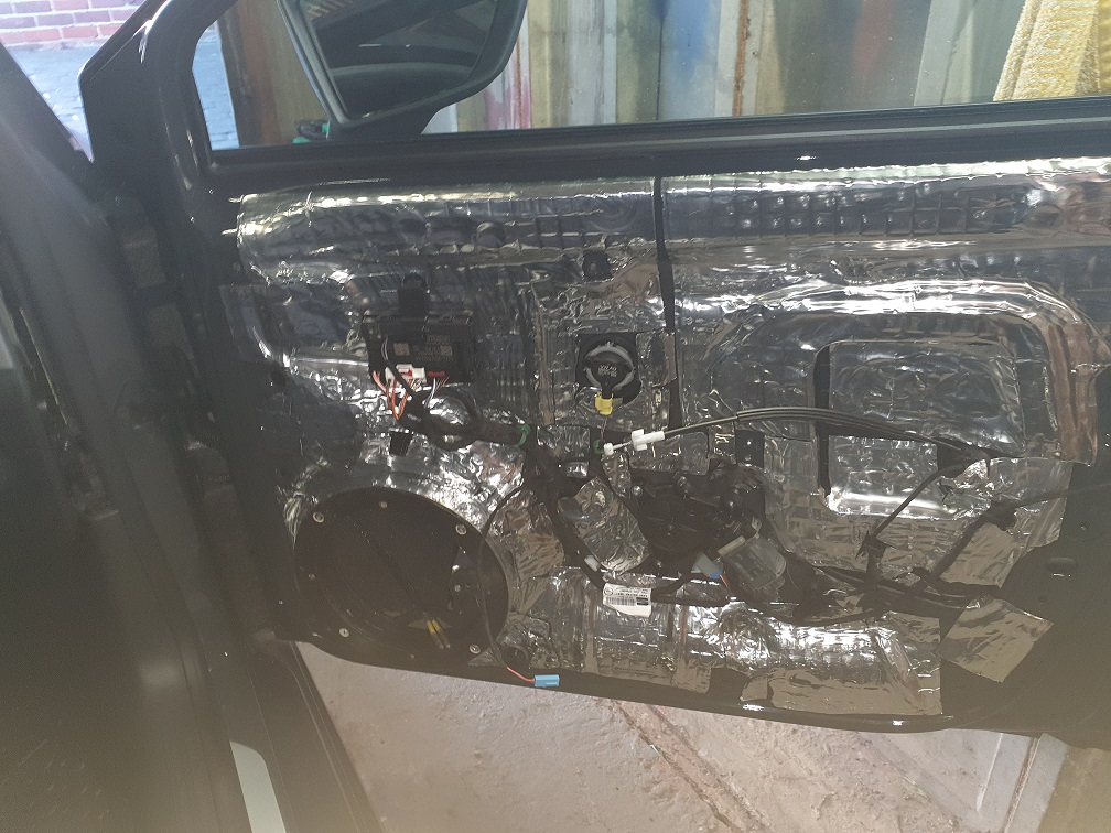

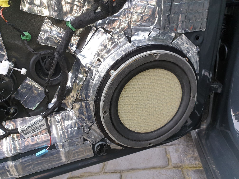

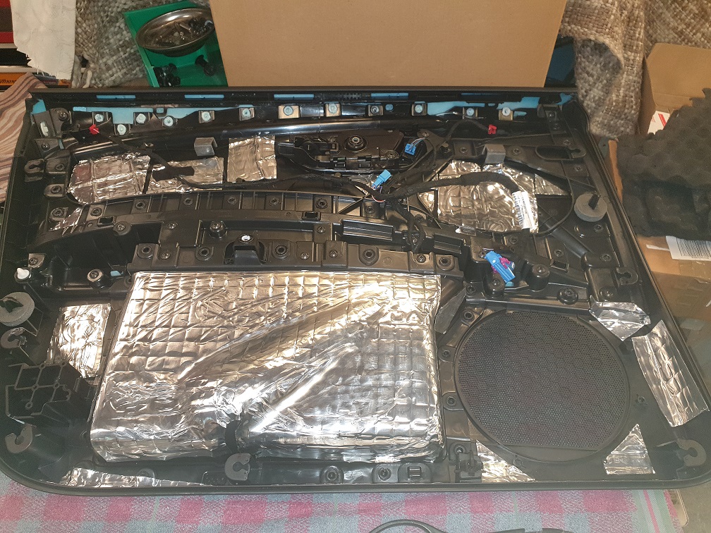

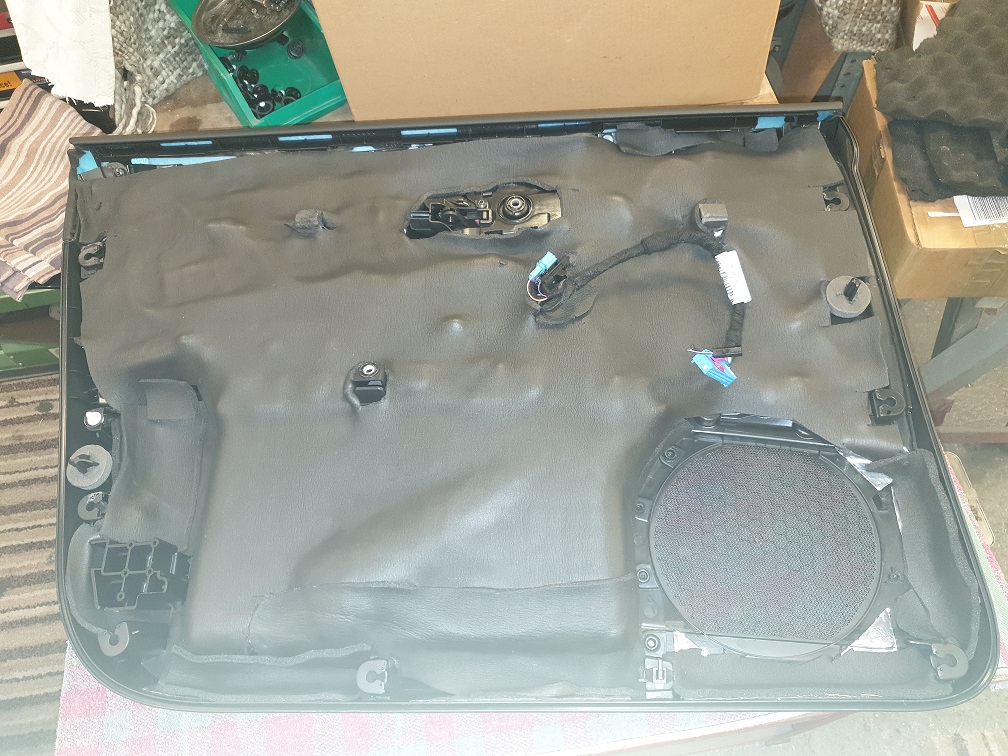

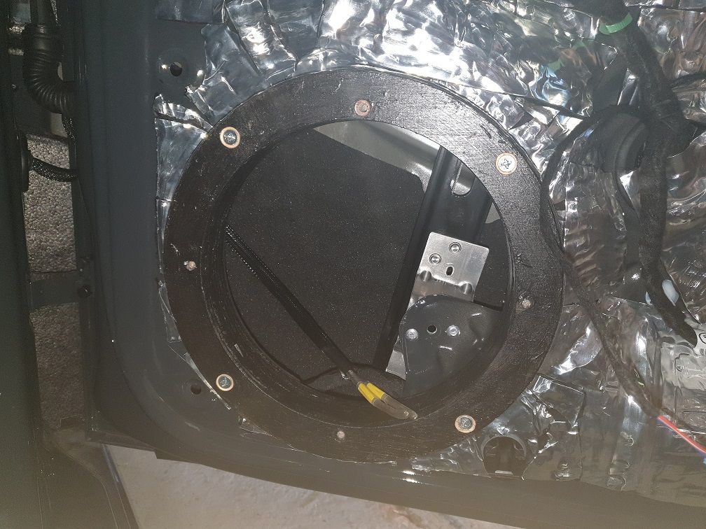

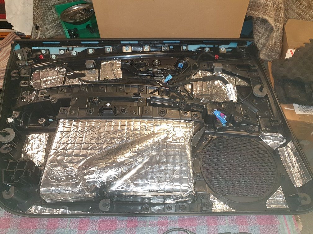

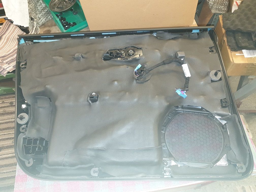

Hi all,
Sorry to being back an old thread.
Currently in the process of soundproofing my doors and following all the great advice on here.
One question for those who have done this, did you replaced all the trim clips even the ones which look ok after removing the door card?
Bit of a mistake in my part and didn't quite order enough for both doors but if I replace only the ones that look broken I can get this done today :)
I managed to save all my clips as I knew about the trick to open and close them, a couple have lost the odd claw (near the tip) but they will be fine used higher up where less tension is needed, I have actually fitted my door cards back on with no clips at all just yet to give the foam time to settle somewhat if that makes any sense? and also to make sure there are no issues with my new speakers fitted.. I really don't want to have to remove the cards unnecessarily as something will eventually break on the door plastics! good design but not with maintenance in mind!
I used Silentcoat for the deadening, have done for years it's very good stuff and not too expensive.

View attachment 14425 View attachment 14426 View attachment 14427 View attachment 14428
Wow you have used a lot of material! Looks a way better job that I did! Have to say even though I used less material the difference is night and day, rattles are gone, speakers sound better and the door feels a lot more premium when shutting.
I ended up replacing all the clips in the end, means I have to wait until more come to do the drivers side but as I have done it once now it doesn't phase me as much.
What new speakers did you go for? Focal upgrade?
Been thinking about new speakers myself but trying to keep it simple on my leon compared to my previous cars which all had a full soundsystem install.

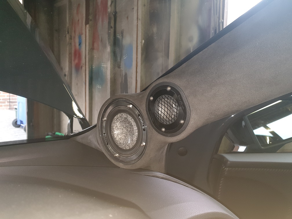

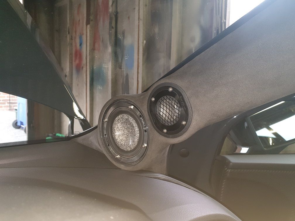

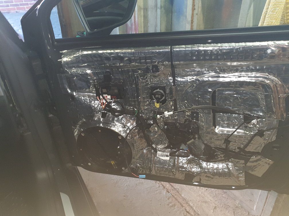

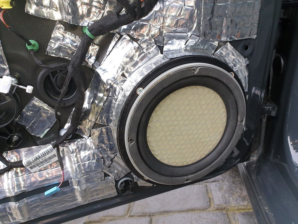

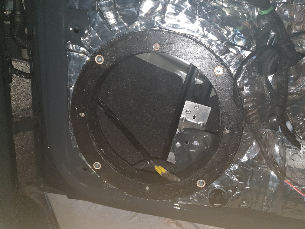

I always like to go overkill with deadening, especially since these are 8" standard woofers so reduces the chances of any vibrations, also did the actual door skin but forgot to take pics of that stage! again, as much as my clumsy hands could get into!
I used Focals for the A pillar builds which I have built during lockdown period and trimmed in matching Alcantara I had lying around, yes, unbelievably 100% match!
as for door speakers, I have used Phase Linear Aliante 8's as I wanted to take advantage of the 8" offerings.
View attachment 14429 View attachment 14430
That A pillar trim looks great! Suits the car very well and having matching Alcantara laying around is just :thumbup:
As helpful as this forum is it gets so many more ideas into my head that I can't afford or have time to do lol
I do wish I had done some more deadening but with what have a used and a full sound proofing covered door card the results are already impressive!
